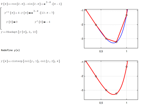

Linear interpolation and linear spline interpolation are different things. I will try to find the formulas that are used in these functions.
We can restore the interpolation functions: lspline(), pspline() and cspline(). This is how the cspline() function works. Based on the attached document and file from the PTC Mathcad forum.

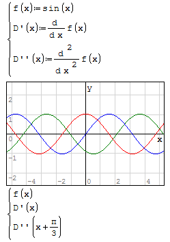

rkfixed(3|4) added, but I still don’t know which derivative symbol is better to take. (ʹ) - modifier letter prime (U+02B9) used below. I don't know how to enter it from the keyboard.
This looks very interesting. Seems that it is not yet in the online gallery?
In principle, the built-in diff(1) operator would be an option but it looks ugly if applied twice.
The ordinary prime would be ok for me (just as it is used as tag in unit names), it is input as Shift # on german keyboards.
diff2.sm (2.79 KiB) downloaded 1492 time(s).

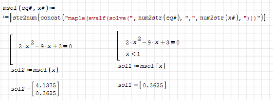

I've made some changes. I liked the idea with the str2num() function. Also I can override the diff(1) function, but that can be confusing.

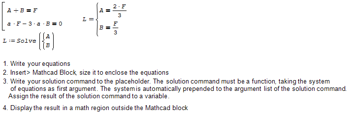

Now it is possible to numerically solve the Cauchy problem for one variable: diff(y(x),x,n)=F(x,y(x),...,diff(y(x),x,n-1)) . Later, I will expand the rest of the ODE solvers to support this simplified form. But for this I need to combine plugins and add interpolation functions similar to Mathcad (lspline(), interp(), ...). It will be more convenient for me to test the solvers, comparing the results with Mathcad.
Block region collects equations in the form of a system and substitutes it as the first parameter into the function.

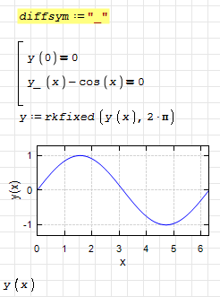

- the task for the ODE solver in the usual mathematical notation is supported;
- default diff symbol is apostrophe ( ' );

- linterp() is used as an interpolation function;
Hi Viacheslav, thanks, great job. One question: Why to use linterp instead cspline? The problem with cspline is about the border of the interval, where you have only diff by the left and the right, and there you can adapt the cubic splines to be linear or parabolic, but in the interior of the interval I guess that it's better cubic splines interpolation.

#113 Posted: 2021/12/6 15:44:46
1,554 likes in 1,864 posts.
I will add the interpolation functions ( interp(), lspline(),... ) to the plugin and rename it to Mathcad Toolbox. After that, it will be possible to test its work, comparing it with the Mathcad numerically.

This is how to use it with symbolic solutions using Solve() (Maxima plugin):
Solve block.sm (5.37 KiB) downloaded 1523 time(s).

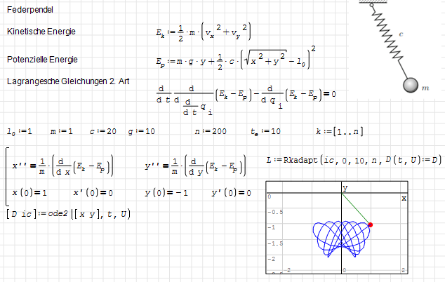

Looking forward to a RK integrator for multi-DOF systems. This is how I would imagine the user interface.
Federpendel-block.sm (48.39 KiB) downloaded 1533 time(s).
This is the next step, but the existing solution is not stable and has some bugs.
