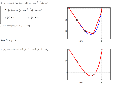

Linear interpolation and linear spline interpolation are different things. I will try to find the formulas that are used in these functions.
We can restore the interpolation functions: lspline(), pspline() and cspline(). This is how the cspline() function works. Based on the attached document and file from the PTC Mathcad forum.

With enough points, simply cinterp Smath.

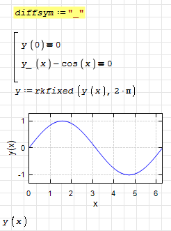

#103 Posted: 12/4/2021 12:46:37 AM
1,558 likes in 1,868 posts.
rkfixed(3|4) added, but I still don’t know which derivative symbol is better to take. (ʹ) - modifier letter prime (U+02B9) used below. I don't know how to enter it from the keyboard.
Click to enlarge Click to enlarge

#105 Posted: 12/5/2021 6:55:49 AM
(ʹ) - modifier letter prime (U 02B9) used below. I don't know how to enter it from the keyboard.
This can be done in 2 steps:
1. Copy \02B9\ to text region. This code will turn into a text simbol (ʹ).
2. Select and copy it as variable name.
PS. It looks like it's time to combine all Mathcad functions into one plugin - Mathcad Toolbox. It will contain all such functions: ODE solvers, spline functions, in/out functions and so on.

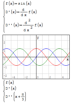

#107 Posted: 12/5/2021 6:30:56 PM
1,361 likes in 2,275 posts.
This looks very interesting. Seems that it is not yet in the online gallery?
In principle, the built-in diff(1) operator would be an option but it looks ugly if applied twice.
The ordinary prime would be ok for me (just as it is used as tag in unit names), it is input as Shift # on german keyboards.
diff2.sm (2.79 KiB) downloaded 1702 time(s).

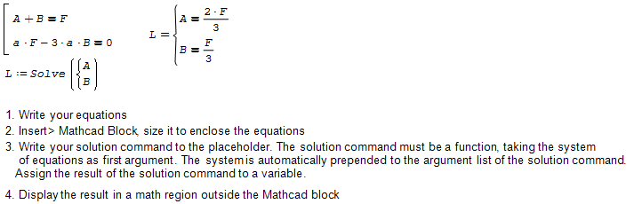

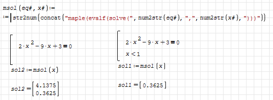

#109 Posted: 12/6/2021 12:07:58 AM
I can't contact Andrey directly. The server does not allow compiling the sources, as there is no free space. Therefore, the latest changes are not yet available.
I've made some changes. I liked the idea with the str2num() function. Also I can override the diff(1) function, but that can be confusing.
Now it is possible to numerically solve the Cauchy problem for one variable: diff(y(x),x,n)=F(x,y(x),...,diff(y(x),x,n-1)) . Later, I will expand the rest of the ODE solvers to support this simplified form. But for this I need to combine plugins and add interpolation functions similar to Mathcad (lspline(), interp(), ...). It will be more convenient for me to test the solvers, comparing the results with Mathcad.
Block region collects equations in the form of a system and substitutes it as the first parameter into the function.
Click to enlarge

- linterp() is used as an interpolation function;
Hi Viacheslav, thanks, great job. One question: Why to use linterp instead cspline? The problem with cspline is about the border of the interval, where you have only diff by the left and the right, and there you can adapt the cubic splines to be linear or parabolic, but in the interior of the interval I guess that it's better cubic splines interpolation.

I will add the interpolation functions ( interp(), lspline(),... ) to the plugin and rename it to Mathcad Toolbox. After that, it will be possible to test its work, comparing it with the Mathcad numerically.

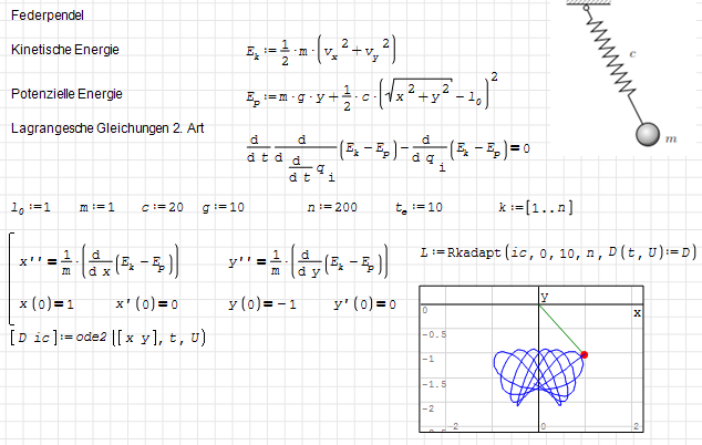

#115 Posted: 12/7/2021 8:32:19 AM
Really nice generic block concept! It is a really good reason for updating the handbook and the portable distribution.
This is how to use it with symbolic solutions using Solve() (Maxima plugin):
Solve block.sm (5.37 KiB) downloaded 1746 time(s).
Looking forward to a RK integrator for multi-DOF systems. This is how I would imagine the user interface.
Federpendel-block.sm (48.39 KiB) downloaded 1733 time(s).
Вячеслав Мезенцев 12/7/2021 9:34:00 AM

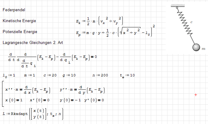

#118 Posted: 12/7/2021 2:00:34 PM
1,139 likes in 1,805 posts.
This is the next step, but the existing solution is not stable and has some bugs.
Hi. In the meantime, we can play with things like this:
Solve block.sm (54.97 KiB) downloaded 1809 time(s).
Вячеслав Мезенцев 12/7/2021 2:03:00 PM
#119 Posted: 12/8/2021 2:24:11 AM
Looks great, but something is missing.
Click to enlarge
Alvaro 12/8/2021 6:53:00 AM
