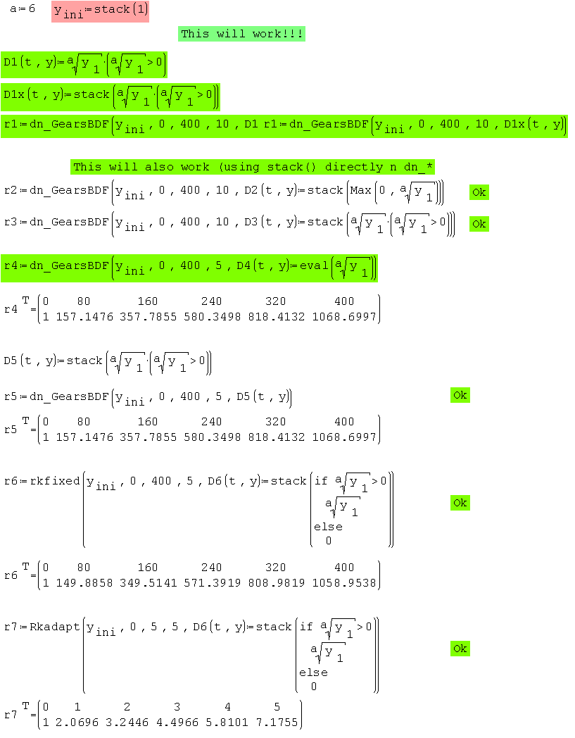

I played around a bit with the examples by Radovan.
My observations:
- using stack() or not is irrelevant in the single first order equation case.
- D and initial condition may be scalar or vector-valued.
- if() and Max() and eval() work, if D is defined inline (in the solver argument list), they do not work, if D is defined outside.
- the different behaviour of Rkadapt is due to poor convergence of the adaptivity algorithm.
- if rkfixed (and possibly the other solvers as well) fails, then you can evaluate the expression using = and get an error
- if rkfixed succeeds, there is no way to evaluate it using = (key is ignored), you have to use assignment instead
if-max-eval.sm (12.95 KiB) downloaded 1575 time(s).

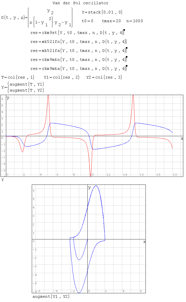

#49 Posted: 2013/8/13 22:51:32
1,554 likes in 1,864 posts.
Updated. Added functions from the Intel® Ordinary Differential Equations Solver Library: rkm9st(), mk52lfn(), mk52lfa(), rkm9mkn(), rkm9mka().
mk52lfa() not finished yet.
ODESolvers. Van der Pol oscillator.sm (10 KiB) downloaded 1602 time(s).
Davide Carpi 2013/8/14 04:20:00, Radovan Omorjan 2013/8/14 03:30:00

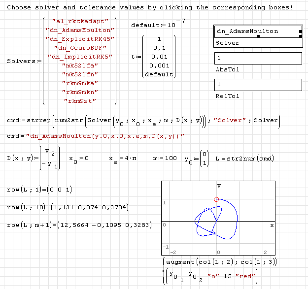

#55 Posted: 2013/8/14 10:42:48
1,355 likes in 2,271 posts.
Here is a nice little toy for exploring precision control. Have fun!
Radovan Omorjan 2013/8/15 01:29:00, Вячеслав Мезенцев 2013/8/14 17:15:00

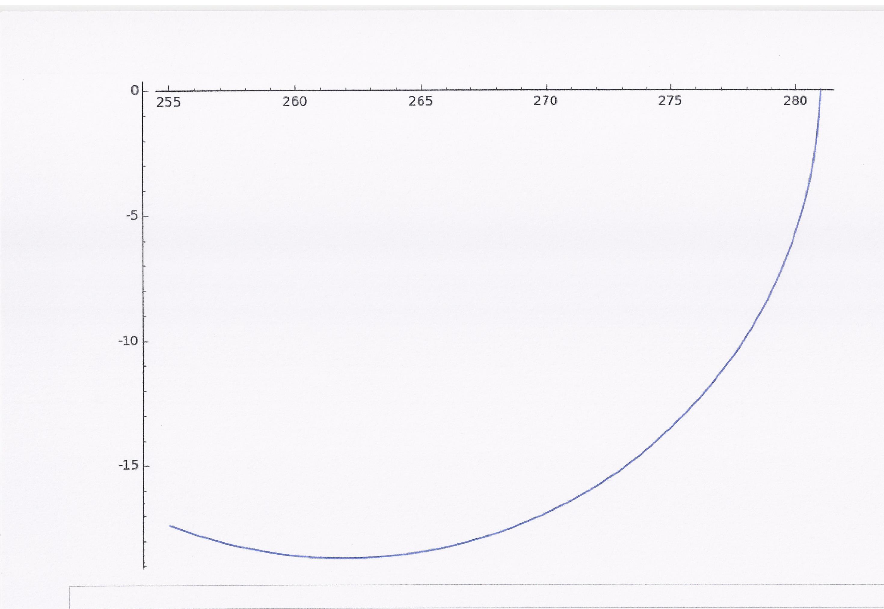

#59 Posted: 2015/5/15 05:36:35
madan26
madan26
0 likes in 2 posts.
I have solved one equation in sage math but not able understand how to solve in smath anybody can guide me on this. below is my equation
exercise1
r = var('r')
PI = pi.n()
rc = 281
rw = 262
Bc = 36/180*PI
F = (r^2-rw^2)*sqrt(rc^2-r^2*sin(Bc)^2)/sqrt((rc^2-rw^2)^2*rc^2*cos(Bc)^2-(r^2-rw^2)^2*(rc^2-r^2*sin(Bc)^2))
F.show()
z = function('z',r)
d = desolve_rk4(diff(z,r)-F,z,ics=[rc,0],end_points=255,step=-0.01)
list_plot(d,plotjoined=True, aspect_ratio=1)
