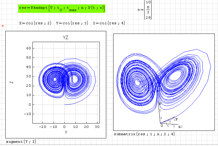

#14 Posted: 2010/11/23 07:29:21
Hello uni
I tested a little bit rkfixed and Rkadapt. Here is a simple picture:
It seems, as you mentioned, that Rkadapt will not work with multiline function. However, it is very good that rkfixed will work with it - a bit surprise for me. I also tried to define function f(x,t) by using "eval" - it does not work either with rkfixed or Rkadapt. Due to my previous experience, I thought it would not work. I know that this kind of functions, like you did with rkfixed and Rkadapt, will have troubles due to the SMath way of working. Never mind, I hope that SMath will have tha ability to cope with this kind of problems some day.

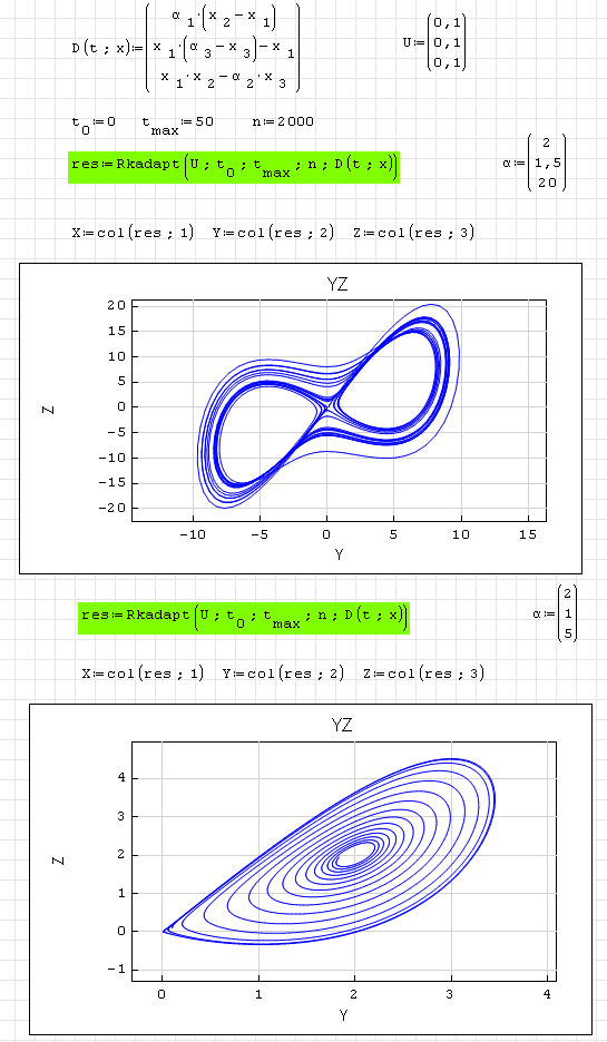

Just tried ODE plugin and figured out that it can accept additional parameters after the first two in D(x,y) function of derivatives.
I might miss that feature, but it should be pointed out that this is very nice and useful
I hope that some stiff solvers would be available sooner or later
ODE-Lorentz.sm (11.12 KiB) downloaded 1793 time(s).

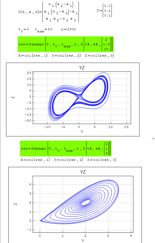

#18 Posted: 2013/5/12 16:41:11
Oh, you found a bug, well, I'll fix it Usual, in such cases I use a different way of passing parameters, but it doesn't work for this example.
EDIT: I was wrong, it works.
Actually, I thought this was by design and that I missed it , and now I am pleasantly surprised . I would prefer my solution, if you do not mind. This way, and in this case - there is a vector with three dependent variables, the rest are parameters (resulting the matrice with four columns). Your solution would have six variables - (resulting the matrice with seven columns). Your example is like the way it works in Mathcad (I never liked this way). If you need additional parameters you must put it in the vector, and use there derivatives equal to zero - it looks a bit artificial.
I also tried this one and it worked as well
Uni, please keep it this way and do not change it
ODE-Lorentz-2.sm (11.87 KiB) downloaded 1687 time(s).

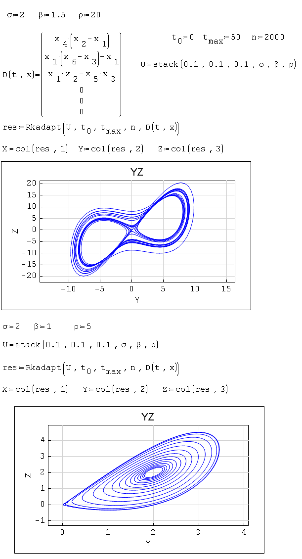

#19 Posted: 2013/5/12 17:26:44
1,355 likes in 2,271 posts.
How about this dirty parameter handling...
Example.sm (12.33 KiB) downloaded 1812 time(s).
Radovan Omorjan 2013/5/13 01:09:00
#20 Posted: 2013/5/13 01:32:56
Thank you Martin,
Hmm... why dirty? Do not understand, sorry. This looks quite regular to me, except that it is not flexible. The third parameter must always have the same name as in the definition of D().
