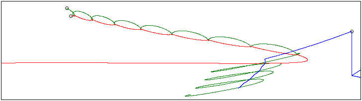

#148 Posted: 2023/4/3 04:19:19
1,554 likes in 1,864 posts.
Hi. Ok.
A very witty, funny and clean solution.
Click to enlarge
7-13-Three-Planets 5 (Mathcad Block).sm (26.36 KiB) downloaded 1892 time(s).
7-13-Three-Planets 5 (Mathcad Block).pdf (61.72 KiB) downloaded 997 time(s).

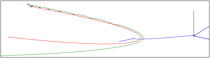

#149 Posted: 2023/4/4 01:59:18
Little bit more.
Click to enlarge
7-13-Three-Planets 6 (Mathcad Block).sm (26.11 KiB) downloaded 1901 time(s).
7-13-Three-Planets 6 (Mathcad Block).pdf (67.28 KiB) downloaded 887 time(s).

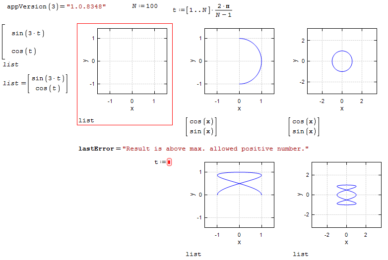

#158 Posted: 2023/4/17 06:58:15
SMath Studio compatibility
Plugin updated.
Changes:
- added support for sequence operation (sys - default, mat, line);
- base frames drawing for error and eval states restored.
Click to enlarge Click to enlarge
Martin Kraska 2023/4/17 16:44:00, sergio 2023/4/17 07:38:00, Alvaro 2023/4/17 17:16:00

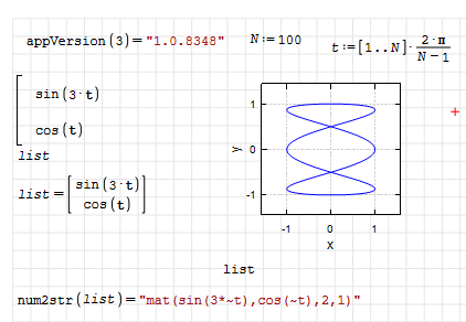

Unfortunately, I can't reproduce your parametric plot example.
It seems that the parameter range is taken from the x axis limits. Assigning a range to the parameter makes the plot fail.
How to fix this?
BTW, how about making the glyph of the mathcad block reflect the actual type by using {,[ or | to indicate the vertical extension?
Mathcad block.sm (13.77 KiB) downloaded 1469 time(s).
#160 Posted: 2023/4/17 17:22:41
1,123 likes in 1,795 posts.
...How to fix this? ...
Use ~t instead t in list, but t in the range.
That's very original!
