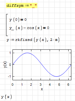

rkfixed(3|4) added, but I still don’t know which derivative symbol is better to take. (ʹ) - modifier letter prime (U+02B9) used below. I don't know how to enter it from the keyboard.
Click to enlarge Click to enlarge

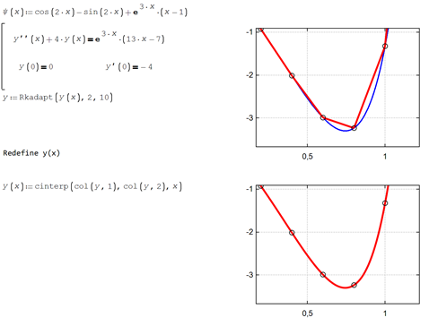

Full set: interp(), [l,p,c]spline().
Click to enlarge
Odesolve interpolation test.sm (59,06 КиБ) скачан 1719 раз(а).
Odesolve interpolation test.pdf (102,91 КиБ) скачан 1078 раз(а).
(*) rkfixed() with a bug now, so you will see something differ.

(ʹ) - modifier letter prime (U 02B9) used below. I don't know how to enter it from the keyboard.
This can be done in 2 steps:
1. Copy \02B9\ to text region. This code will turn into a text simbol (ʹ).
2. Select and copy it as variable name.
PS. It looks like it's time to combine all Mathcad functions into one plugin - Mathcad Toolbox. It will contain all such functions: ODE solvers, spline functions, in/out functions and so on.

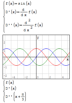

In principle, the built-in diff(1) operator would be an option but it looks ugly if applied twice.
The ordinary prime would be ok for me (just as it is used as tag in unit names), it is input as Shift # on german keyboards.
diff2.sm (2,79 КиБ) скачан 1702 раз(а).

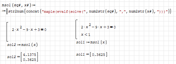

I've made some changes. I liked the idea with the str2num() function. Also I can override the diff(1) function, but that can be confusing.
Now it is possible to numerically solve the Cauchy problem for one variable: diff(y(x),x,n)=F(x,y(x),...,diff(y(x),x,n-1)) . Later, I will expand the rest of the ODE solvers to support this simplified form. But for this I need to combine plugins and add interpolation functions similar to Mathcad (lspline(), interp(), ...). It will be more convenient for me to test the solvers, comparing the results with Mathcad.

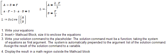

Really nice generic block concept! It is a really good reason for updating the handbook and the portable distribution.
This is how to use it with symbolic solutions using Solve() (Maxima plugin):
Solve block.sm (5,37 КиБ) скачан 1746 раз(а).

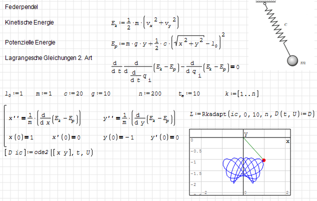

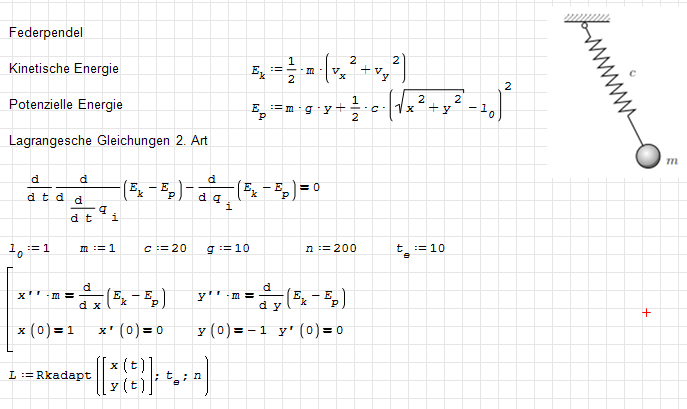

Looking forward to a RK integrator for multi-DOF systems. This is how I would imagine the user interface.
Federpendel-block.sm (48,39 КиБ) скачан 1733 раз(а).
#116 Опубликовано: 07.12.2021 09:32:51
This is the next step, but the existing solution is not stable and has some bugs.
