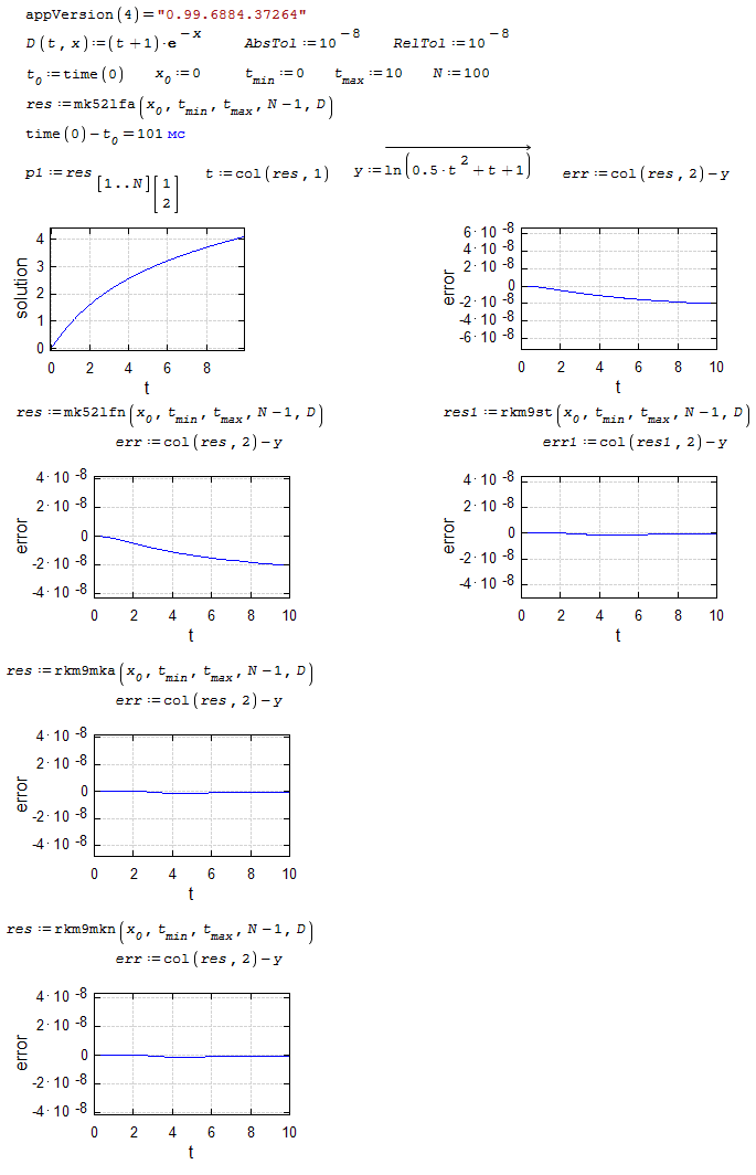

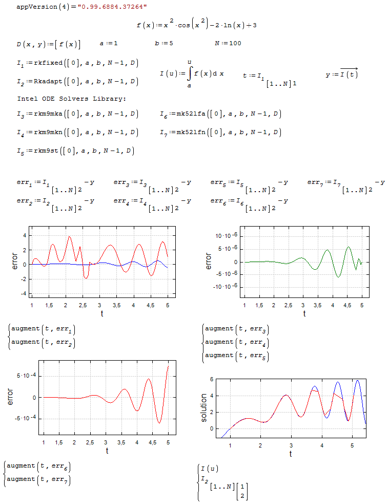

Simple intel ode test 2.
iode.test2.sm (22.5 KiB) downloaded 2023 time(s).
iode.test2.pdf (121.64 KiB) downloaded 957 time(s).

#72 Posted: 2018/12/3 17:21:26
1,554 likes in 1,864 posts.
Updated. Fixed issue with zero point.
ODE test 3. Something wrong with Rkadapt().
iode.test3.sm (24.09 KiB) downloaded 1545 time(s).
iode.test3.pdf (112.7 KiB) downloaded 785 time(s).
Alvaro 2018/12/3 22:25:00
Hi Viacheslav. It seems that for Rkadapt t repeats itself, at least for low N values. Maybe you can handle that with some if abs(t[n+1]-t[n])<(some tol) then do something for modify t, and not add it to the final solution. Probably it could be because your step size goes too short.

#76 Posted: 2018/12/4 09:55:44
It looks OK to me from Rkadapt design.
It reaches solution in 42 steps vs fixed 100.
iode.test3 Strip Rkadapt.sm (11.15 KiB) downloaded 1545 time(s).
