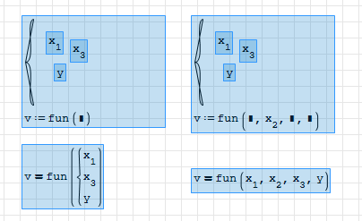

BTW, how about making the glyph of the mathcad block reflect the actual type by using {,[ or | to indicate the vertical extension?
I haven't done this yet because I want the user to be able to choose the type of lines. For all sides.

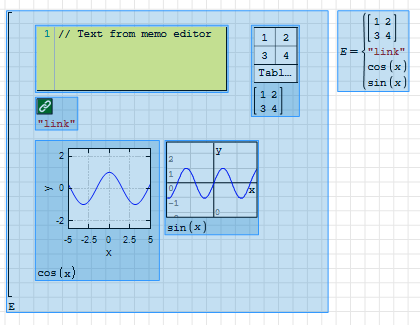

#164 Posted: 2023/4/29 04:39:57
1,554 likes in 1,864 posts.
Theoretically, I can get data from any component. I can try to get the text from the text region.
Alvaro 2023/4/29 08:26:00
#165 Posted: 2023/4/29 08:31:27
1,123 likes in 1,795 posts.
Theoretically, I can get data from any component. I can try to get the text from the text region....
Amazing: That's true for a lot of components! What about to catch the text in your memo editor instead SMath's text regions? Or both, I don't know.
#166 Posted: 2023/4/29 08:52:55
It's funny, I haven't tried it. I want to simplify the input of text programs. This is another way to extend the functionality of the program through third-party libraries.
A lot of useful libraries have been developed now. There is no point in repeating all this. It is necessary to create flexible interfaces for their integration and interaction with each other.
Alvaro 2023/4/29 09:32:00
#167 Posted: 2023/4/29 09:39:33
... I want to simplify the input of text programs. ...
Yep. It would be very practical to have a tool to capture text to process it. I try to use description() function, but it has the drawback that it must be called at the worksheet level and it doesn't work well within the body of a function. Like in chess, RPN, Code or XYOptions.

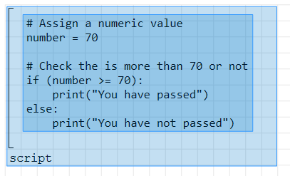

Click to enlarge
maple-system-python-TextRegion.sm (5.58 KiB) downloaded 1471 time(s).
sergio 2023/4/30 12:37:00, Alvaro 2023/4/30 13:25:00

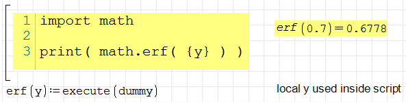

#169 Posted: 2023/4/30 13:14:56
SMath Studio compatibility
Plugin updated.
Changes:
- MathcadBlock: added support for function definition.
Now the function definition can be written directly in the block.
Click to enlarge
maple-system-execute.sm (8.08 KiB) downloaded 1532 time(s).
Memo Region also supported but it has not been updated for a long time, so some of its text functions do not work.

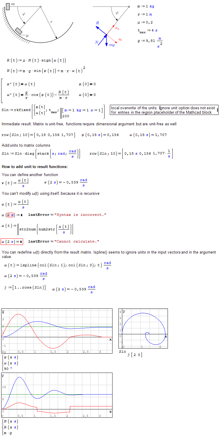

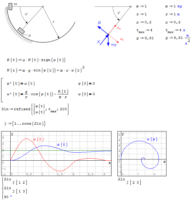

Is there a chance to at least partially use units here? The values with units are disabled in the sheet, this is not visible in the png-file.
7-1.sm (29.01 KiB) downloaded 1507 time(s).
sergio 2023/11/25 19:38:00

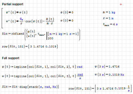

#171 Posted: 2023/11/25 13:26:55
This is an option for having partial and full units support.
7-1-units.sm (35.56 KiB) downloaded 1475 time(s).
sergio 2023/11/25 19:38:00, Martin Kraska 2023/11/25 19:45:00
#172 Posted: 2023/11/25 19:44:24
1,355 likes in 2,271 posts.
Alvaro, thanks for the hints.
By whatever reason, the unit of the independent variable is respected in rkfixed()=even though it is set to 1 locally. Whatever locally means if that happens in the last input parameter value.
7-1_units.sm (39.68 KiB) downloaded 1502 time(s).

I select the type of bracket for different modes of operation of the block. There are problems with drawing the system sign.
