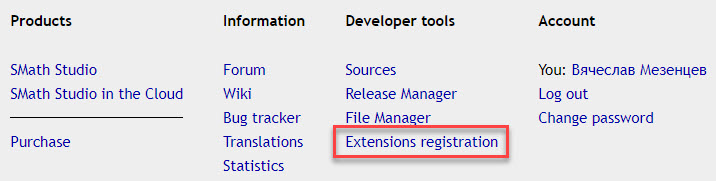

Try to log in here using the registration data in the program: https://en.smath.com/upload/extensions.aspx
You should see this picture:
Click to enlarge
Next, you need to choose the type of extension
Click to enlarge
Before uploading a file, you need to fill in the document properties. Later, you can delete the file if necessary.
Click to enlarge
If the registration data is not suitable, then you need to request them from Andrey via e-mail.
The registered files will be available through the gallery.
Click to enlarge
sergio 4/7/2023 12:54:00 PM, Alvaro 4/6/2023 12:44:00 PM

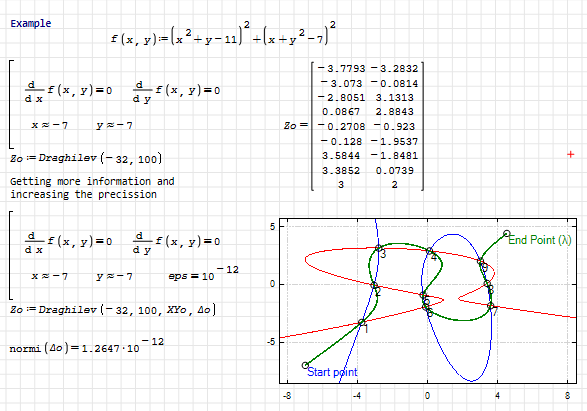

#158 Posted: 4/17/2023 6:58:15 AM
1,558 likes in 1,868 posts.
SMath Studio compatibility
Plugin updated.
Changes:
- added support for sequence operation (sys - default, mat, line);
- base frames drawing for error and eval states restored.
Click to enlarge Click to enlarge
Martin Kraska 4/17/2023 4:44:00 PM, sergio 4/17/2023 7:38:00 AM, Alvaro 4/17/2023 5:16:00 PM
