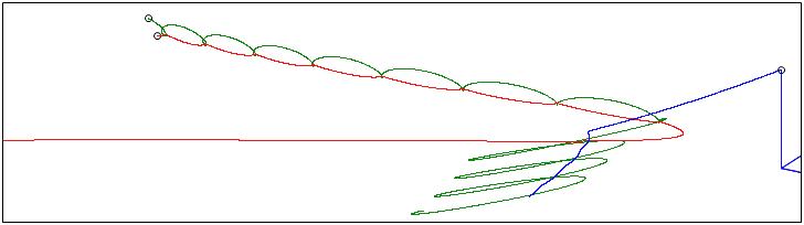

#143 Опубликовано: 02.04.2023 09:31:14
... Очков В.Ф., Орлов К.А., Чудова Ю.В., Ивашев А.В., Тихонов А.И. IT в инженерных расчетах: SMath & Python. Лань. 2023
Hi. Very interesting. It could be animated and add z axis. Maybe speed vectors too and the "ecliptic" plane.
3body.sm (37,44 КиБ) скачан 1713 раз(а).
#144 Опубликовано: 02.04.2023 09:34:42
It is necessary to choose the conditions of the problem in such a way that the massive body intercepts the satellite.
Alvaro 02.04.2023 09:45:00

#147 Опубликовано: 02.04.2023 10:20:06
Hi. Ok.
3body.sm (37,78 КиБ) скачан 1693 раз(а).
Вячеслав Мезенцев 02.04.2023 10:22:00, Mark R Harris 03.04.2023 02:32:00

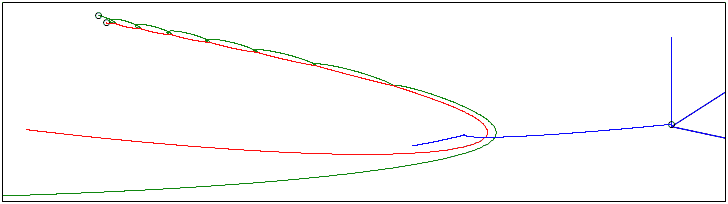

#148 Опубликовано: 03.04.2023 04:19:19
Hi. Ok.
A very witty, funny and clean solution.
Click to enlarge
7-13-Three-Planets 5 (Mathcad Block).sm (26,36 КиБ) скачан 2175 раз(а).
7-13-Three-Planets 5 (Mathcad Block).pdf (61,72 КиБ) скачан 1181 раз(а).
Alvaro 03.04.2023 06:57:00, Mark R Harris 04.04.2023 16:19:00
#149 Опубликовано: 04.04.2023 01:59:18
Little bit more.
Click to enlarge
7-13-Three-Planets 6 (Mathcad Block).sm (26,11 КиБ) скачан 2185 раз(а).
7-13-Three-Planets 6 (Mathcad Block).pdf (67,28 КиБ) скачан 1039 раз(а).

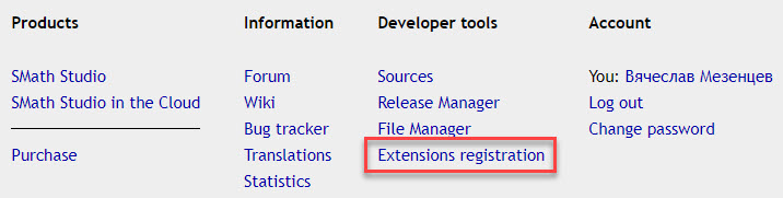

#157 Опубликовано: 06.04.2023 10:29:56
Hi. That function looks great. Is there an example of using a document as an add-on?
Try to log in here using the registration data in the program: https://en.smath.com/upload/extensions.aspx
You should see this picture:
Click to enlarge
Next, you need to choose the type of extension
Click to enlarge
Before uploading a file, you need to fill in the document properties. Later, you can delete the file if necessary.
Click to enlarge
If the registration data is not suitable, then you need to request them from Andrey via e-mail.
The registered files will be available through the gallery.
Click to enlarge
sergio 07.04.2023 12:54:00, Alvaro 06.04.2023 12:44:00

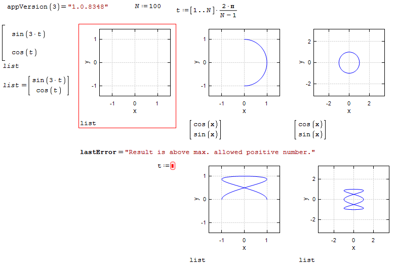

#159 Опубликовано: 17.04.2023 16:43:23
Unfortunately, I can't reproduce your parametric plot example.
It seems that the parameter range is taken from the x axis limits. Assigning a range to the parameter makes the plot fail.
How to fix this?
BTW, how about making the glyph of the mathcad block reflect the actual type by using {,[ or | to indicate the vertical extension?
Mathcad block.sm (13,77 КиБ) скачан 1736 раз(а).

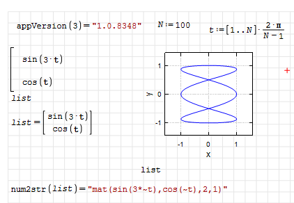

#160 Опубликовано: 17.04.2023 17:22:41
...How to fix this? ...
Use ~t instead t in list, but t in the range.
That's very original!
