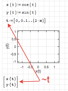

I think it is possible to mark a "vector" variable with a tilde "~": ~t. It might look like this. I need to think about whether this will work.
Alvaro 12/10/2021 8:07:00 PM
#123 Posted: 12/11/2021 4:14:06 AM
1,139 likes in 1,805 posts.
It looks pretty good.

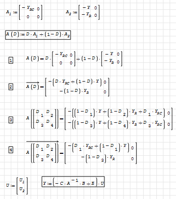

... Maple Tools, simplify выдал что-то не то что должен был по моим разумениям.Raschjot17.sm (24.05 KiB) downloaded 1710 time(s).
Hi. Notice that SMath does not operate automatically expands matrix operations. Also, the maple's linalg package have some issues too, and sometimes needs to call evalm function, which means "eval as matrix".
If D is a scalar I suppose that the correct result is (2), but if it is a 2x2 matrix I think it is (3).
In both cases you cannot calculate A ^ (- 1) because the second column of A is zero.
Could you comment what is the expression you expect for A? Also perhaps something from this post may be useful to you: https://en.smath.com/forum/yaf_postst17472_Applications-for-equrep--expression-isolation-and-laplace-transform.aspx

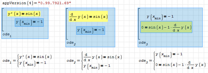

- MathcadBlock improved (doesn't perform substitutions);
- File Access functions refactored;
- project restructured.
Here the variable x.min is defined above.
sergio 4/25/2022 5:29:00 AM

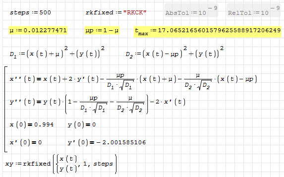

#135 Posted: 6/22/2022 12:54:35 AM
1,558 likes in 1,868 posts.
I hope I didn't solve it wrong.
These ODEs is called the Arenstorf Orbit.
lsoda.Arenstorf Orbit.sm (15.45 KiB) downloaded 1982 time(s).
lsoda.Arenstorf Orbit.pdf (93.42 KiB) downloaded 1076 time(s).
The problem is that I use an universal algorithm that independently searches for derivatives in equations and arranges them in a matrix. I started with low order derivatives, so the equations were solved with respect to them first. It's wrong, but it worked in simple cases. When I redid the enumeration of derivatives of higher orders, I found that I did not take into account the case of different naming of variables. In this regard, an incorrect matrix is ​​obtained and the numerical algorithm cannot find a solution.
I need to organize a double loop that first takes into account different variables, and then their derivatives.
It is strange that I didn't do this earlier, because the rest of the code is designed for this.
I had a very simple set of examples that I experimented with. As soon as I tried something more complicated - it immediately revealed the problem.
