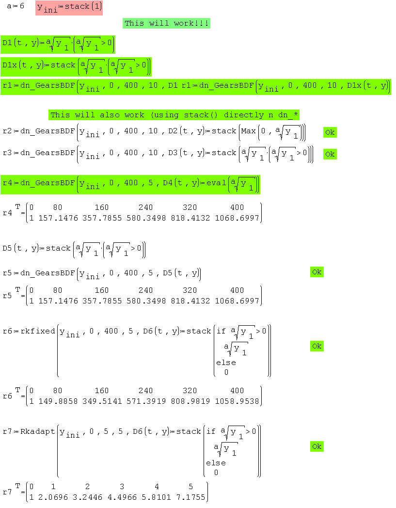

I played around a bit with the examples by Radovan.
My observations:
- using stack() or not is irrelevant in the single first order equation case.
- D and initial condition may be scalar or vector-valued.
- if() and Max() and eval() work, if D is defined inline (in the solver argument list), they do not work, if D is defined outside.
- the different behaviour of Rkadapt is due to poor convergence of the adaptivity algorithm.
- if rkfixed (and possibly the other solvers as well) fails, then you can evaluate the expression using = and get an error
- if rkfixed succeeds, there is no way to evaluate it using = (key is ignored), you have to use assignment instead
if-max-eval.sm (12.95 KiB) downloaded 1781 time(s).
My observations:
Do not recommend using scalars. The point is that the ode functions in SMath Studio are described as follows:
Quote
new ArgumentInfo[] {
new ArgumentInfo( ArgumentSections.ColumnVector ),
new ArgumentInfo( ArgumentSections.RealNumber ),
new ArgumentInfo( ArgumentSections.Function )
For now there is no strict monitoring parameter types, but it can occur in the future. I can make support for scalar parameters, but then for every function I need to write it analog with different set of types of parameters.
Quote
Ok, I see. How about a generic ODESolve(method, y0, t0, t1, n, D), where method is some optional string indicating the numerical procedure. Then, whatever convenience UI stuff you add goes to all solvers.
Similar to the FindRoot function you might adopt the embedded assignment option, e.g. by specifying the initial conditions and iniial value of the independent variable in equation form like
[MATH lang=eng]ODESolve(mat(v≡1,s≡0,2,3,1),t≡0,1,10,D(t,y))[/MATH]

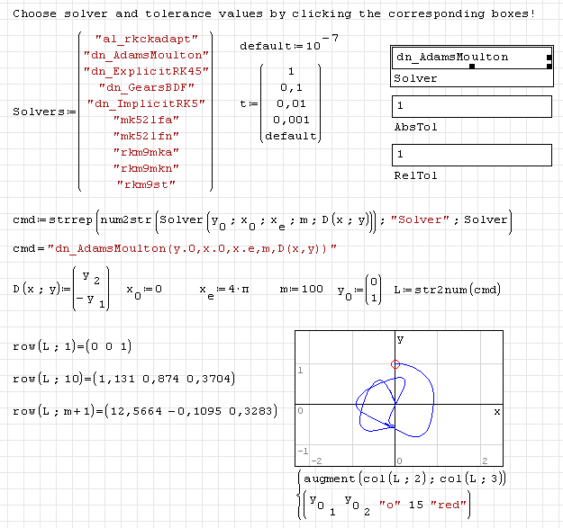

#55 Posted: 8/14/2013 10:42:48 AM
1,361 likes in 2,275 posts.
Here is a nice little toy for exploring precision control. Have fun!

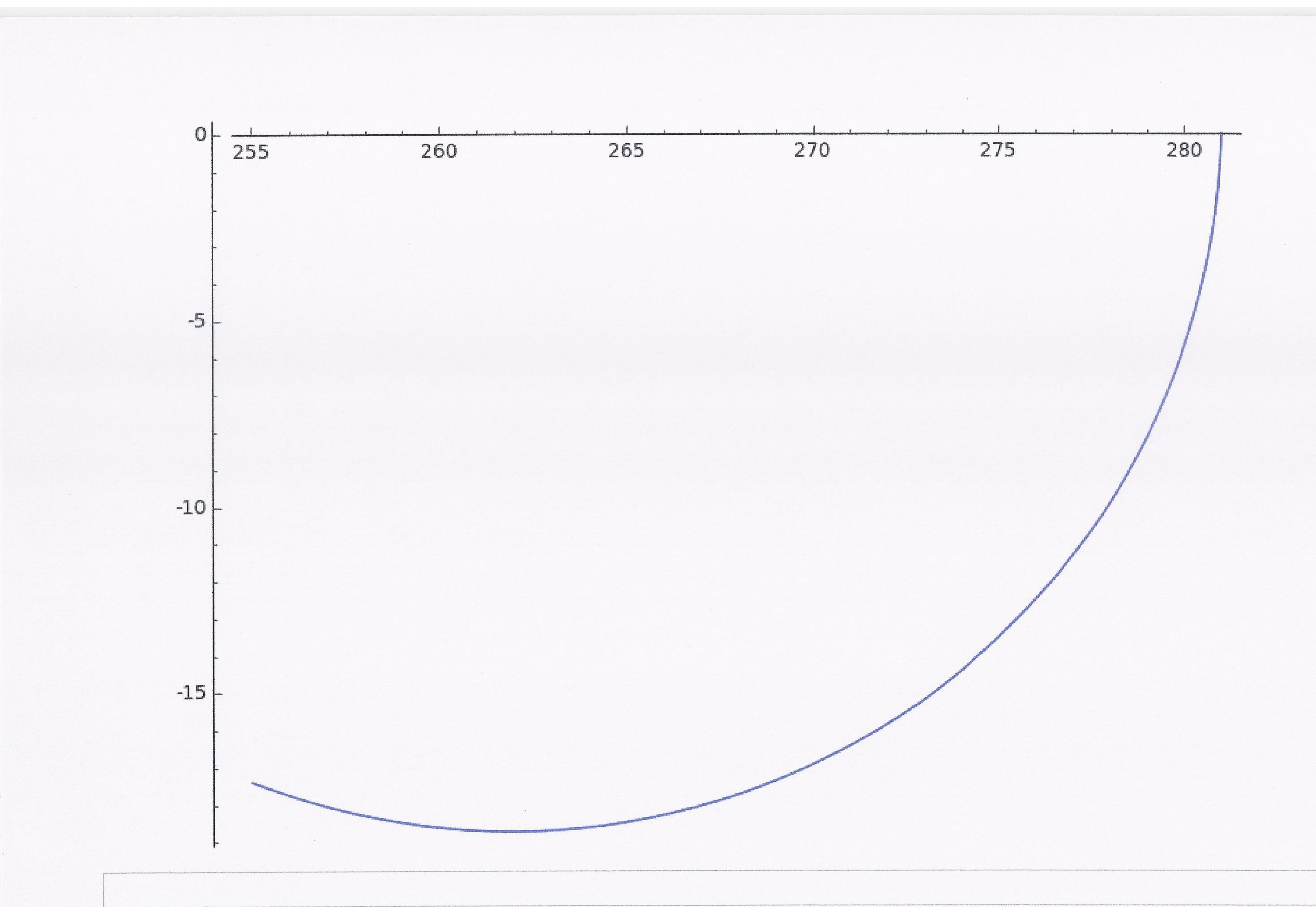

I have solved one equation in sage math but not able understand how to solve in smath anybody can guide me on this. below is my equation
exercise1
r = var('r')
PI = pi.n()
rc = 281
rw = 262
Bc = 36/180*PI
F = (r^2-rw^2)*sqrt(rc^2-r^2*sin(Bc)^2)/sqrt((rc^2-rw^2)^2*rc^2*cos(Bc)^2-(r^2-rw^2)^2*(rc^2-r^2*sin(Bc)^2))
F.show()
z = function('z',r)
d = desolve_rk4(diff(z,r)-F,z,ics=[rc,0],end_points=255,step=-0.01)
list_plot(d,plotjoined=True, aspect_ratio=1)
