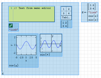

#164 Posted: 4/29/2023 4:39:57 AM
1,558 likes in 1,868 posts.
Theoretically, I can get data from any component. I can try to get the text from the text region.
Alvaro 4/29/2023 8:26:00 AM
#165 Posted: 4/29/2023 8:31:27 AM
1,139 likes in 1,805 posts.
Theoretically, I can get data from any component. I can try to get the text from the text region....
Amazing: That's true for a lot of components! What about to catch the text in your memo editor instead SMath's text regions? Or both, I don't know.
#166 Posted: 4/29/2023 8:52:55 AM
It's funny, I haven't tried it. I want to simplify the input of text programs. This is another way to extend the functionality of the program through third-party libraries.
A lot of useful libraries have been developed now. There is no point in repeating all this. It is necessary to create flexible interfaces for their integration and interaction with each other.

#167 Posted: 4/29/2023 9:39:33 AM
... I want to simplify the input of text programs. ...
Yep. It would be very practical to have a tool to capture text to process it. I try to use description() function, but it has the drawback that it must be called at the worksheet level and it doesn't work well within the body of a function. Like in chess, RPN, Code or XYOptions.

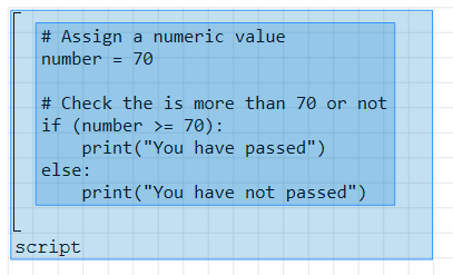

Changes:
- MathcadBlock: added support for TextRegion.
Click to enlarge
maple-system-python-TextRegion.sm (5.58 KiB) downloaded 1689 time(s).

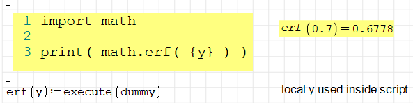

- MathcadBlock: added support for function definition.
Now the function definition can be written directly in the block.
Click to enlarge
maple-system-execute.sm (8.08 KiB) downloaded 1763 time(s).
Memo Region also supported but it has not been updated for a long time, so some of its text functions do not work.

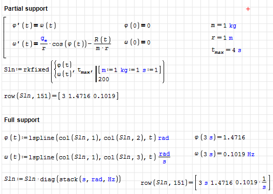

#170 Posted: 11/25/2023 8:25:40 AM
1,361 likes in 2,275 posts.
Is there a chance to at least partially use units here? The values with units are disabled in the sheet, this is not visible in the png-file.
7-1.sm (29.01 KiB) downloaded 1730 time(s).
sergio 11/25/2023 7:38:00 PM
#171 Posted: 11/25/2023 1:26:55 PM
This is an option for having partial and full units support.
7-1-units.sm (35.56 KiB) downloaded 1702 time(s).
sergio 11/25/2023 7:38:00 PM, Martin Kraska 11/25/2023 7:45:00 PM
#172 Posted: 11/25/2023 7:44:24 PM
Alvaro, thanks for the hints.
By whatever reason, the unit of the independent variable is respected in rkfixed()=even though it is set to 1 locally. Whatever locally means if that happens in the last input parameter value.
7-1_units.sm (39.68 KiB) downloaded 1732 time(s).

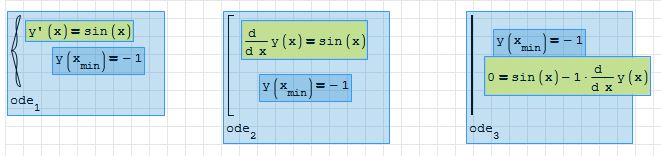

#179 Posted: 10/5/2024 5:49:09 AM
I select the type of bracket for different modes of operation of the block. There are problems with drawing the system sign.

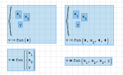

#180 Posted: 10/13/2024 2:54:02 PM
I think it would be fun to add the ability to tell the component where to insert a set of expressions: as the first parameter, as the last parameter, as parameters, as parameters before specified, after specified.
Or to indicate where to place them.
