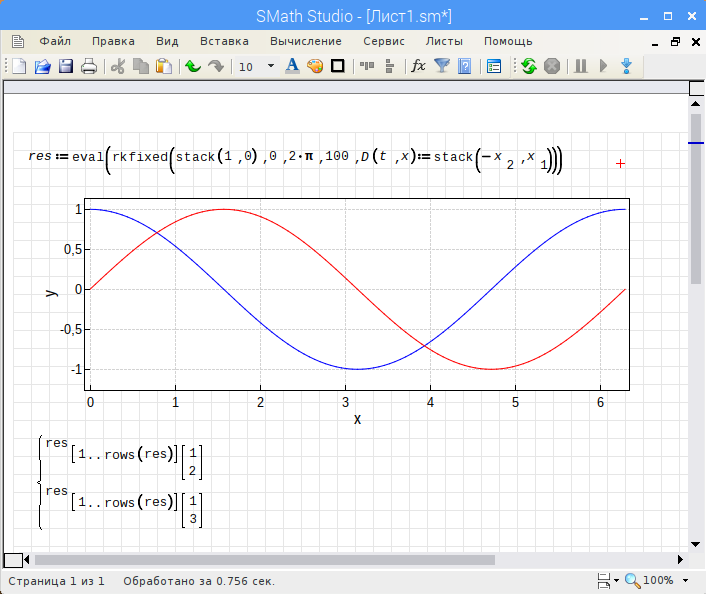

Updated. Skip intel ode assembly loading if Linux used. So in Linux only 2 functions available: rkfixed() and Rkadapt().
Raspbian on RaspberryPi 3.

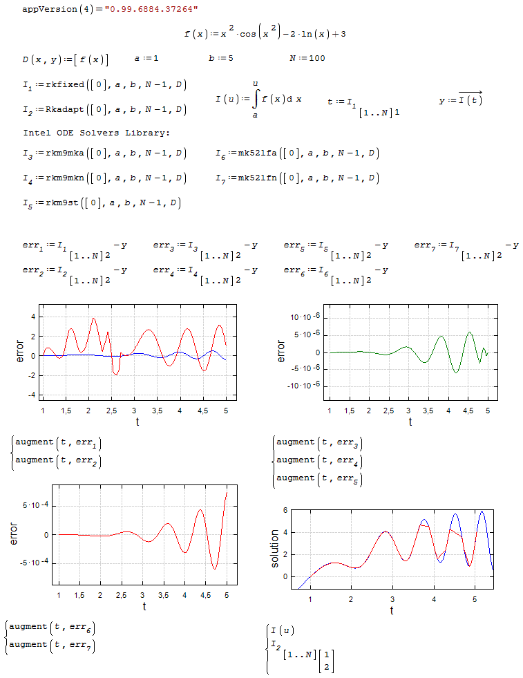

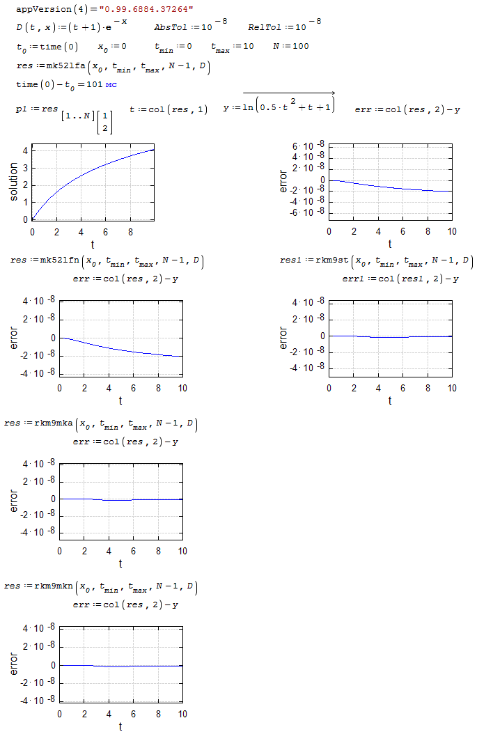

Simple intel ode test 2.
iode.test2.sm (22.5 KiB) downloaded 2265 time(s).
iode.test2.pdf (121.64 KiB) downloaded 1130 time(s).
sergio 8/1/2018 6:06:00 PM
#72 Posted: 12/3/2018 5:21:26 PM
1,558 likes in 1,868 posts.
Updated. Fixed issue with zero point.

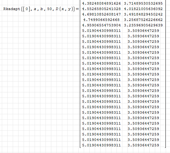

ODE test 3. Something wrong with Rkadapt().
iode.test3.sm (24.09 KiB) downloaded 1760 time(s).
iode.test3.pdf (112.7 KiB) downloaded 954 time(s).
Alvaro 12/3/2018 10:25:00 PM
#73 Posted: 12/3/2018 11:32:02 PM
1,139 likes in 1,805 posts.
Hi Viacheslav. It seems that for Rkadapt t repeats itself, at least for low N values. Maybe you can handle that with some if abs(t[n+1]-t[n])<(some tol) then do something for modify t, and not add it to the final solution. Probably it could be because your step size goes too short.

#74 Posted: 12/4/2018 1:40:00 AM
Nothing more deceiving than experimenting ODEsolve.
The attached is worth the visit !

#76 Posted: 12/4/2018 9:55:44 AM
It looks OK to me from Rkadapt design.
It reaches solution in 42 steps vs fixed 100.
iode.test3 Strip Rkadapt.sm (11.15 KiB) downloaded 1756 time(s).
#77 Posted: 12/4/2018 10:17:01 AM
... In fact: Rkadapt reaches solution in 35 steps.
MCD Rkadapt results in equally spaced solutions.
MCD rkadapt comes with two extra parameters
"acc" accuracy
"s" step size
As it looks Smath Rkadapt muffs the start,
Try 34/35 => observe the result.
iode.test3 Strip Rkadapt.sm (16.85 KiB) downloaded 1795 time(s).
