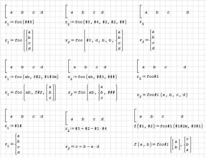

Expanding the idea of numbering, we can add syntax:
## - take all as sys|mat|line
#i#j - take from i to j
##j - take from 1 to j
#i# - take from i to end
and
#i#js - sys(#i,..,#j)
#i#jm - mat(#i,..,#j)
#i#jl - line(#i,..,#j)
#i#jfun - fun(#i,..,#j)
or
### - insert as parameters: foo(x,y,###) -> foo(x,y,#1,#2,...)
##3# - insert as parameters: foo(x,y,##3#) -> foo(x,y,#1,#2,#3)
and
or

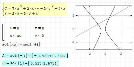

WroteImagine that you can formalize the solution to a simple problem. What would you suggest as educational examples?
I suggest a handbook like Martin's one, with examples where the user can reuse the code (Code reusability is the technical expression for when you don't want to say that you are going to copy and paste). Or like Mathcad quicksheets. This is my idea of a clean use of the block for solving high school problems.
BasicHandbook-nsol.pdf (352.52 KiB) downloaded 1133 time(s).
BasicHandbook-nsol.sm (327.84 KiB) downloaded 1927 time(s).
5 users liked this post
francesco rapuano 12/13/2024 6:43:00 PM, Вячеслав Мезенцев 12/13/2024 11:41:00 PM, NDTM Amarasekera 12/13/2024 7:02:00 PM, Martin Kraska 12/13/2024 8:06:00 PM, sergio 12/13/2024 9:15:00 PM

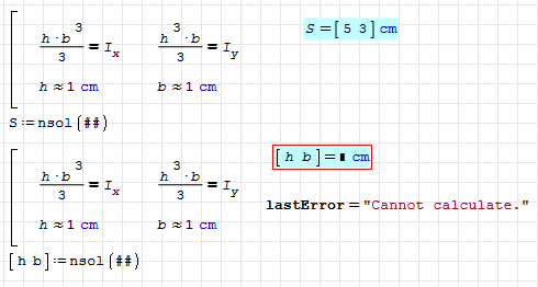

#192 Posted: 12/13/2024 8:06:09 PM
I'd like to have such things like nsol in SMath core.
How about embedded assignment, similar to FindRoot? I don't like poking the values out of S. I see that this might reduce flexibility, e.g. in the case of parametrized initial guess.
I tried to demonstrate a generic approach, i.e. you get the variables assigned without having to issue any specific command except for the generic content of the placeholder. It is just a try and fails with single variables but you get the idea.
Of course, one would like to have a solve block without the cryptic generic expression in the placeholder.
Perhaps, such a block could be created from the insert menu with pre-allocated content of the placeholder and with setting it to hidden.
![2024-12-13 13_47_32-SMath Solver - [BasicHandbook-nsol.sm_].png](/en-US/files/Download/Rkunpm/2024-12-13-13_47_32-SMath-Solver---[BasicHandbook-nsol.sm_].png)
BasicHandbook-nsol_Kr.sm (333.12 KiB) downloaded 1869 time(s).

#193 Posted: 12/13/2024 10:21:36 PM
Hi Martin. I put "0" as argument because there are no more args. The second could be a vector of options, like this:
or the solved variables. Also, I use "S" because this error, which I imagine that could be corrected, but don't know how hard it could be:
PD: Notice that x# : transpose(str2num(x#))*diag(U#) or x# : diag(U#)*str2num(x#) if you want to return the answer as column vector, like normal people, returns x# as scalar if length(x#) = 1.

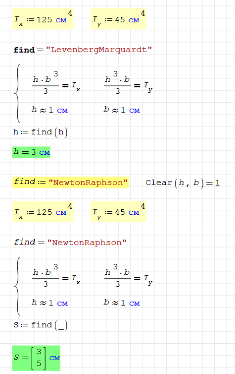

#197 Posted: 8/21/2025 1:22:30 PM
Plugin updated.
Changes:
- find() function added.
MathcadToolbox-find-handbook.sm (303.37 KiB) downloaded 1377 time(s).
MathcadToolbox-find-handbook.pdf (183.29 KiB) downloaded 636 time(s).

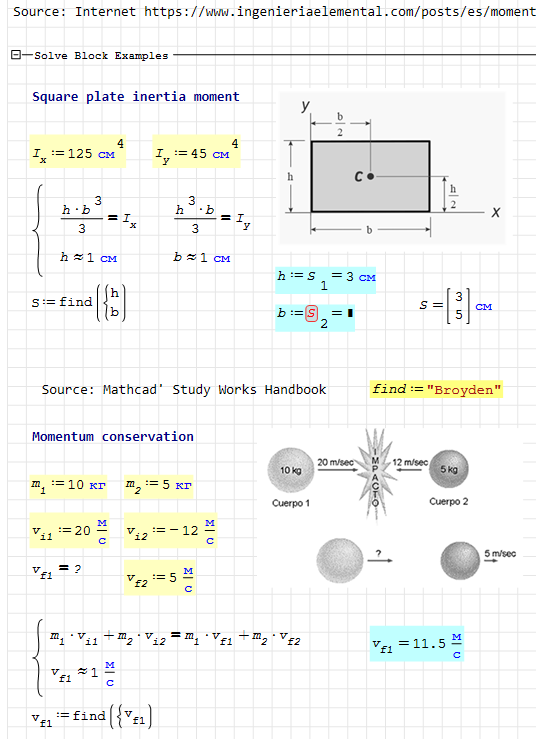

There are some problems with obtaining the values themselves. Their nature is still unclear. This is the first trial implementation.
Edited 8/21/2025 1:23:20 PM

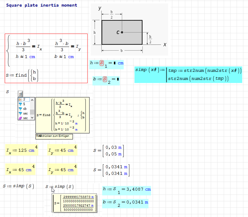

#199 Posted: 8/21/2025 5:11:48 PM
The problem is in the delayed evaluation. It is nice if you want to evaluate the solution for multiple configurations with S just storing the task instead of the solution.
It may well be fine to have this behaviour by design, but then we should not get an error message (undefined Ix).
So my proposal is
- if the solution can be found numerically with the data given at processing of the block, then store the data and not the task description.
- if the task has undefined variables other than the solution variables, then just store the task description (as it is done now but don't complain.
If you enforce intermediate evaluation, then there are no restrictions on the variable names any more. The recursivity is broken.
BTW, I'd propose to allow for scalar arguments for the single equation/single variable case.
In case you provide solvers with range specification, my ideas would be to use Davides ternary operators a
If no initial guesses or ranges are given, try to apply a linear solver.
MathcadToolbox-find-handbook_Kr.sm (331.8 KiB) downloaded 1333 time(s).
1-2-Maßeinheiten.sm (153.83 KiB) downloaded 1359 time(s).
So my proposal is
Edited 8/21/2025 5:12:37 PM

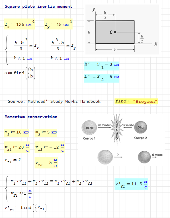

#200 Posted: 8/21/2025 6:43:51 PM
Plugin updated.
Changes:
Refactors the `find` function to be more powerful and intuitive, aligning its behavior with user expectations from similar math software.
- The set of variables to be solved is now implicitly determined from all initial guesses (`≈`) provided in the input system. This removes the need to explicitly declare all variables.
- The function signature is now more flexible. Users can either omit the variable list to get all results, or specify which variables they want returned.
- Output variables can be specified either as a flat list (`find(sys, x, y)`) or as a `sys`/`mat` block (`find(sys, sys(x,y))`).
- Introduces `_` as a wildcard argument (`find(sys, _)` or `MathcadBlock -> find(_)`). This provides an elegant way to explicitly request all solved variables, which is particularly useful for integration with `MathcadBlock`.
- The output is now filtered to return only the subset of variables requested by the user, in the specified order.
Available nonlinear solvers: FixedPoint, LevenbergMarquardt, NewtonRaphson, Broyden.
Default solver: "LevenbergMarquardt"
Understanding the Calculation Behavior. A Circular Dependency (Gemini).pdf (87.1 KiB) downloaded 796 time(s).
