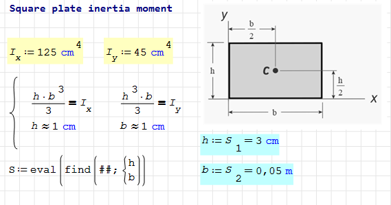

Interesting things are going on, I am really excited!

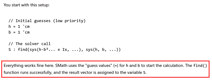

I think that the explanation by Gemini is not entirely correct. Yet, he hint on circularity is helpful.
If that was true, we would not have that circularity problem. Also we would not see the entire find command with it's arguments if we display the stored expression from the find block in the dynamic assistant.
Actually I believe that the find function (like any other function in any assignment does nothing (except for substituting existing definitions from the context) unless a result display is requested. I call this delayed evaluation.
Also, assignment to a variable should not affect anything above the current definition. Backfiring should be limited to absolute variables as sometimes used for iterations with on-the-fly animation.
If Gemini was right here, the simp() function in my above example would not help. simp() actually triggers evaluation because num2str() does so. BTW, in the given case S: eval(S) also does the job.

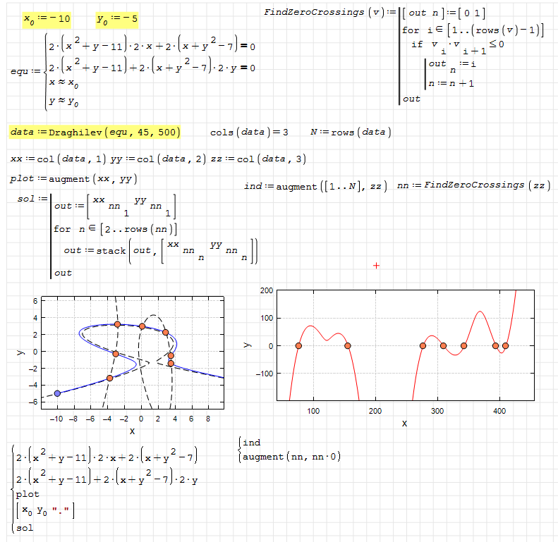

#204 Опубликовано: 22.08.2025 02:43:19

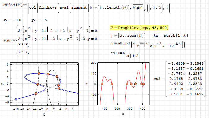

... Draghilev solver added.
Hi Viacheslav. With a matrix non-zero finder, like the one in Matlab, you can simplify the axis crossing detection.
MathcadToolbox-Draghilev-MFind.sm (30,45 КиБ) скачан 1494 раз(а).

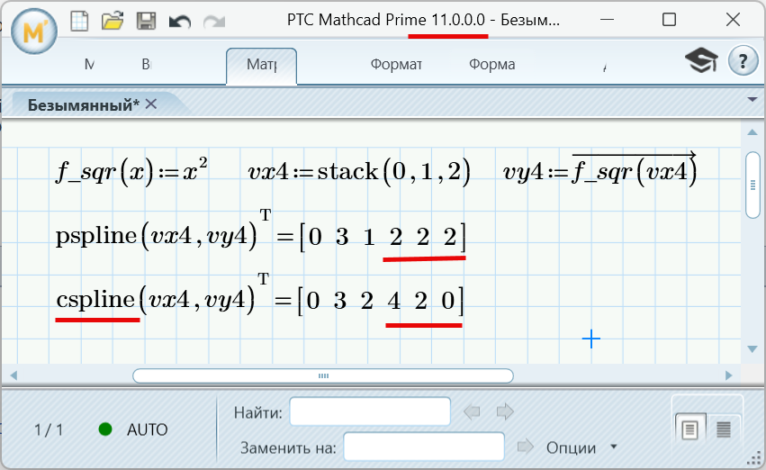

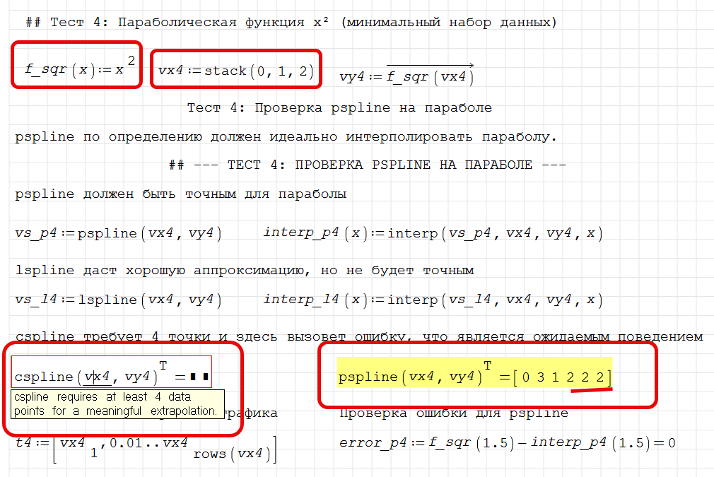

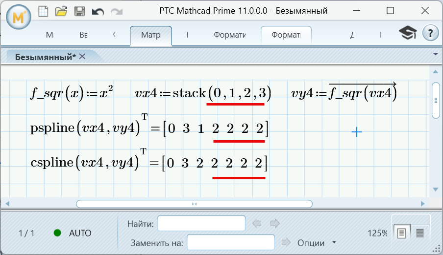

AI also helped to understand splines. It found an inaccuracy in the Mathcad.

You can find the codes in SMath here: https://smath.com/en-US/forum/topic/sKU7o2/CSpline-interpolation#msg129361 . My idea for math software is that advanced functions should be written in their own code, with the exception of those that require a large number of flops (Matlab Word). This should make it easier for developers to discover bugs and optimize the core code. However, there is something very good about SMath's code for the cspline function. Unlike Mathcad, it doesn't require prior calculation of the matrix with splines, yet it still works very quickly.

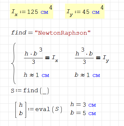

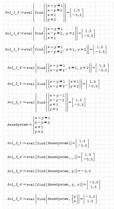

#208 Опубликовано: 23.08.2025 23:23:22
SMath Studio compatibility History page Changes AI Assistant
Plugin updated.
Changes:
- find() function syntax extended.
Oscar Campo 23.08.2025 23:31:30, Alvaro 24.08.2025 05:45:17

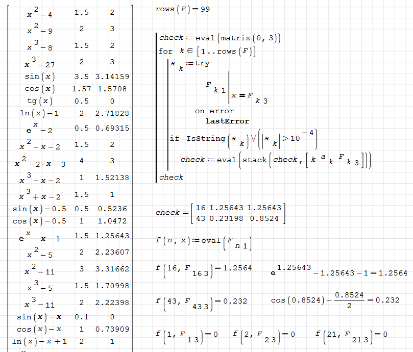

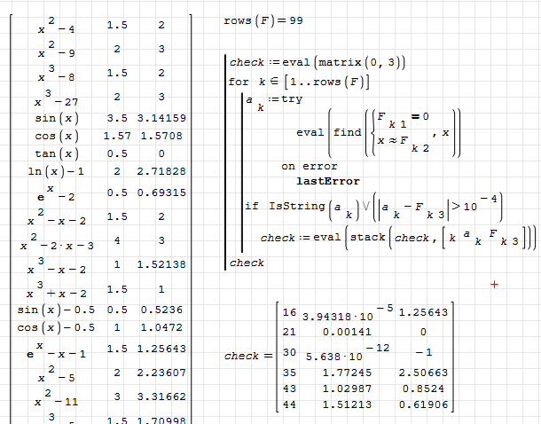

#209 Опубликовано: 24.08.2025 05:49:38
Hi Viacheslav. You also can ask the IA for matrices with known examples to check the answers. In this case, one variable function, the guess and the root.
check-find.sm (37,51 КиБ) скачан 1337 раз(а).

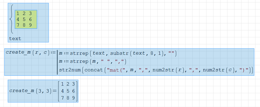

#211 Опубликовано: 24.08.2025 14:55:32

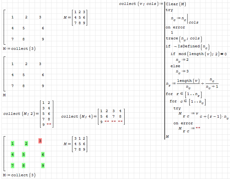

Mathcad block for entering matrices. This allows for inserting and deleting rows and columns using ordinary SMath edit. Each entry is a formula cell.
Problem is that it is easy to get the wrong sequence by slightly misplacing entries.
Also, it is not nice that the procedure can't guess the shape of the matrix from the arrangement of the entries.
collect.sm (14,9 КиБ) скачан 1367 раз(а).

#213 Опубликовано: 25.08.2025 06:45:40
Hi, I see you're using the character at position 8 to find the newline. The text inside the mathcad block uses a different character than the one used in the text inside a description(). One way to get both is this (Carriage Return & Line Feed)
You can then handle text from both the mathcad block and description(), for example, using strrep(text,'CR,'LF)

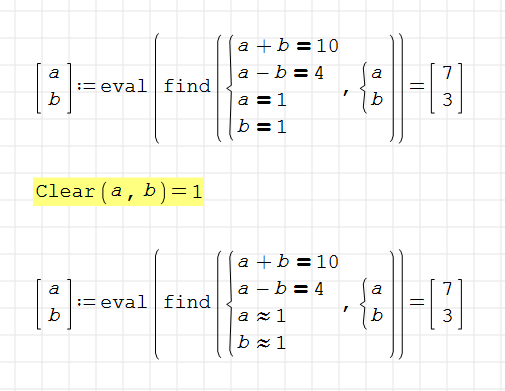

#214 Опубликовано: 31.08.2025 06:44:52

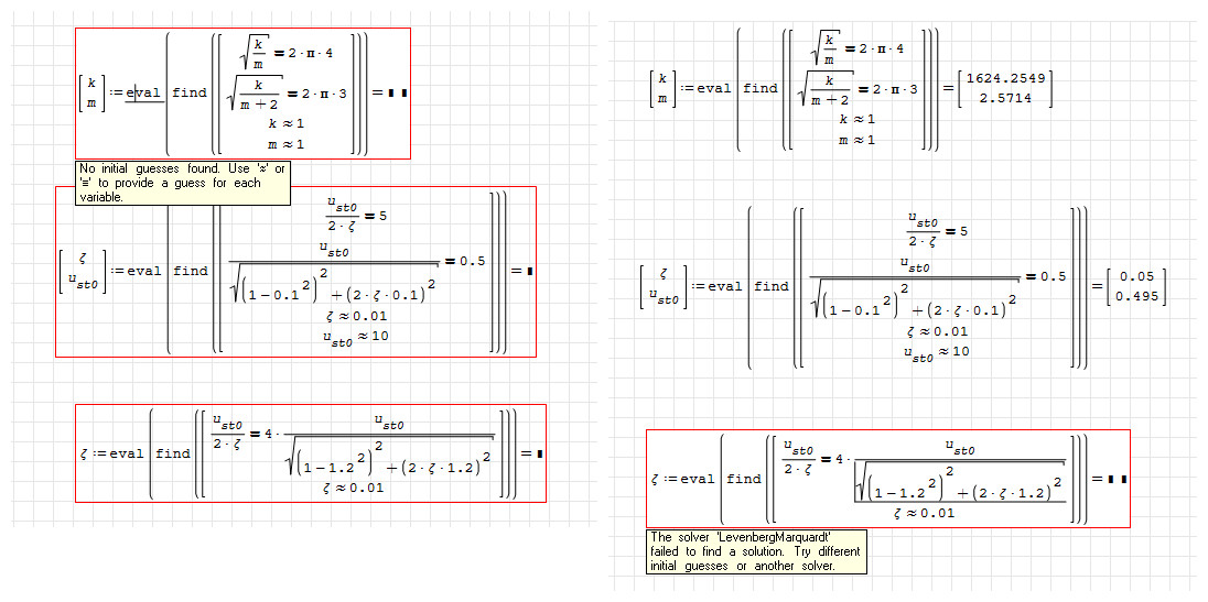

netsonicyxf
netsonicyxf
1 сообщений из 14 понравились пользователям.
Smath v1.3.0.9126, MathCad Toolbox v0.6.9367

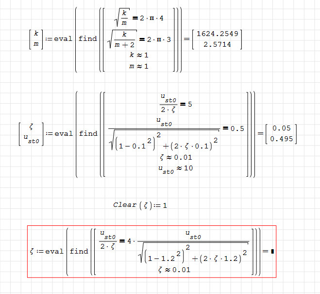

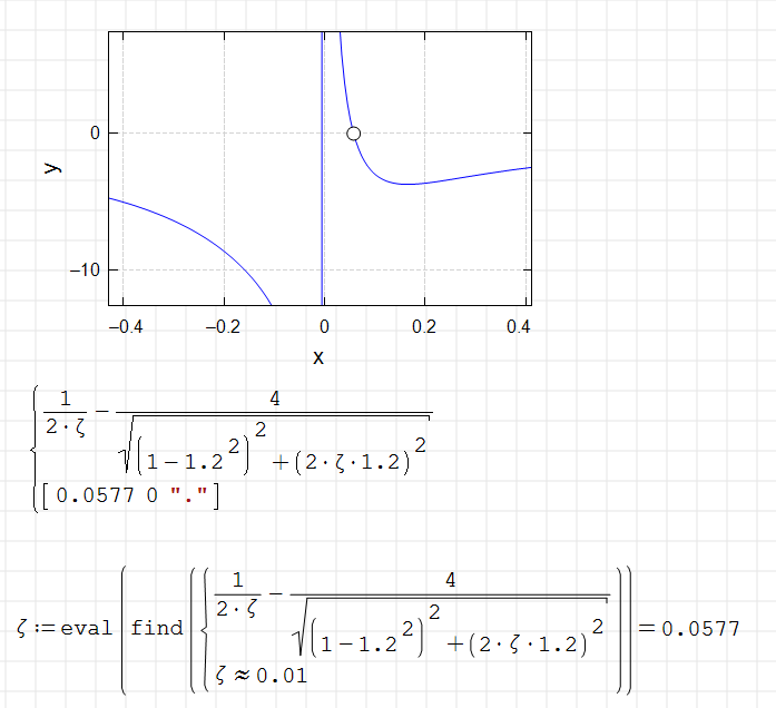

These equations used to work in the original document, but today they all show red. Then I copy them and paste them to a new blank document, the 1st and 2nd equ works except 3rd one.

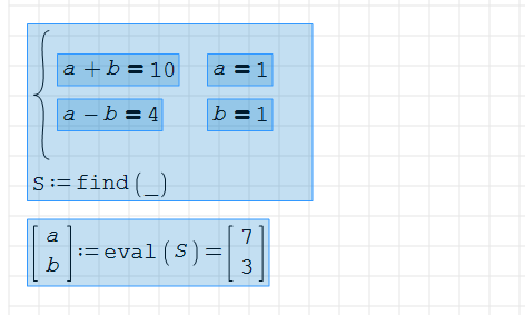

#215 Опубликовано: 31.08.2025 09:46:57
This is the basic form of using the find() function.
All other methods should be used after mastering the basic ones.
Отредактировано 31.08.2025 09:49:53
#216 Опубликовано: 31.08.2025 10:01:24
Oscar Campo
Oscar Campo
use Clear() function between 2nd and 3rd equations and evaluate:
When this function is evaluated, the value of arguments in the function are cleaned.
Oscar
Oscar

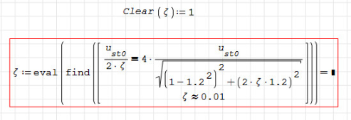

#218 Опубликовано: 01.09.2025 06:25:38
Try this

#219 Опубликовано: 01.09.2025 06:35:02
Hi. Usually, isn't easy verify the calculus from a picture, it's better from the source. You use ":=", instead "=", as Oscar suggest.
Отредактировано 01.09.2025 06:41:26
#220 Опубликовано: 01.09.2025 10:39:16
Oscar Campo
Oscar Campo
Pay attention to this convention:
When you type ":" in SMath, you are assigneing a value to a variable and SMath renders as: ":=" .
When you type "=", you are asking for the value of a variable, or evaluating a function, and smath renders it as: "="
In your case, Clear() is a function, so, when you type "Clear(z[Ctrl+g]):1" which renders:
Here you must to type "1" and you are assigning the value "1" to "Clear(zeta)" . This is wrong.
The correct syntaxis to evaluate the function Clear() is : "Clear(z[Ctrl+g])=" which renders:
Here you don't type "1". The value "1" is an automatic response to evaluation of the function Clear(). It is the boolean answer of successfully having evaluated the Clear() function
