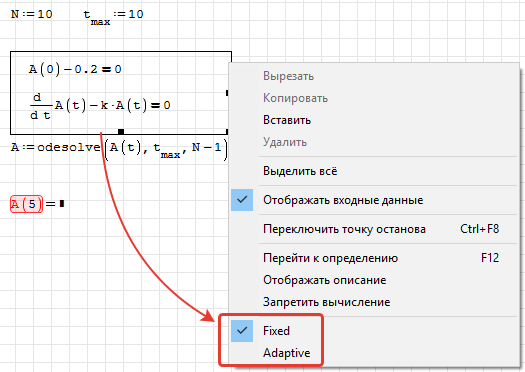

Updated. Now you can also use simple form for D() function definition.
sergio 06.12.2018 06:45:00, frapuano 06.12.2018 06:58:00, Radovan Omorjan 06.12.2018 09:33:00, Alvaro 06.12.2018 10:09:00
#82 Опубликовано: 06.12.2018 06:01:27
But x in D(t,x) is vector.

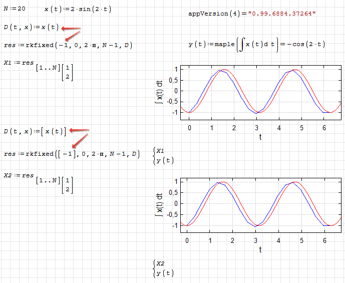

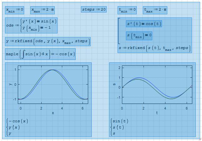

#83 Опубликовано: 24.12.2018 05:33:39
Updated.
Now x in simple D(t,x) definition must be a scalar.

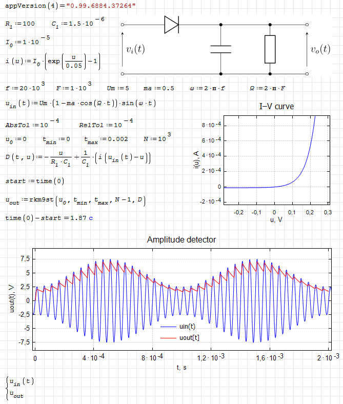

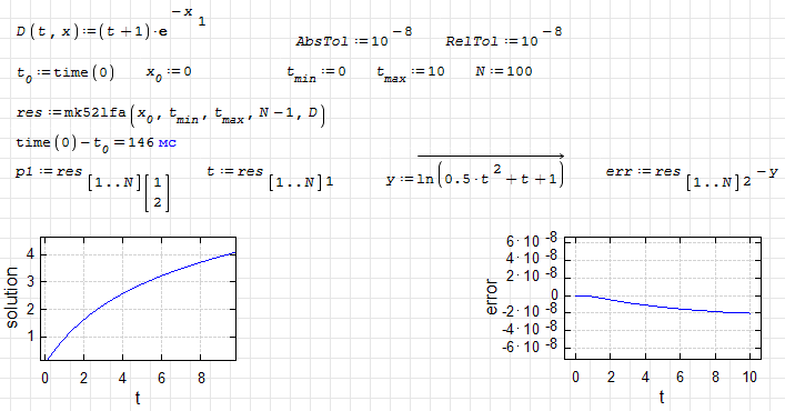

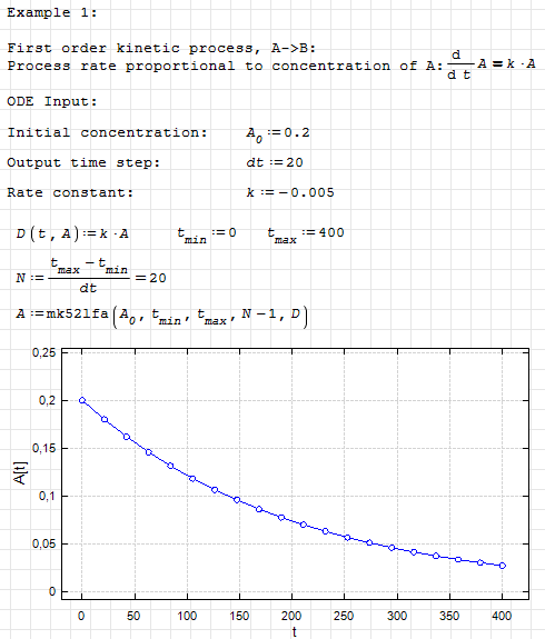

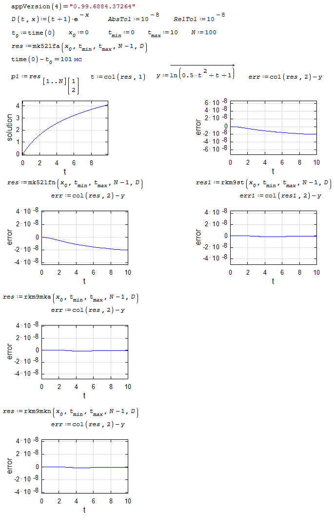

2018-12-24_13-43-45.png iode.test1.png iode.test2.png 2018-12-24_13-32-46.png
iode.examples.sm (204,21 КиБ) скачан 2327 раз(а).
iode.kinetic1.sm (7,75 КиБ) скачан 2276 раз(а).
iode.kinetic2.sm (14,4 КиБ) скачан 2132 раз(а).
iode.kinetic3.sm (14,08 КиБ) скачан 7096 раз(а).

iode.Amplitude detector.sm (20,18 КиБ) скачан 2207 раз(а).

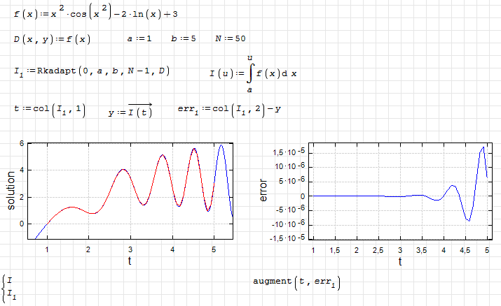

#84 Опубликовано: 16.01.2019 06:05:17
Updated. Rkadapt() fixed.

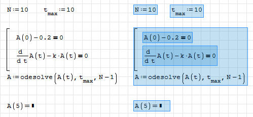

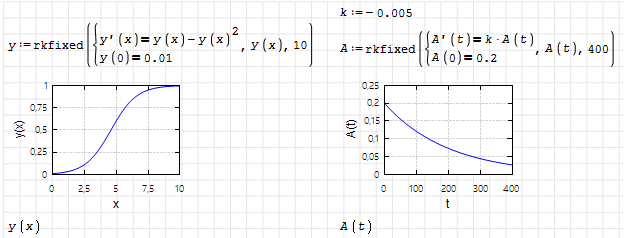

#93 Опубликовано: 26.11.2021 00:11:56
Coming soon, but for now as an experiment.
Davide Carpi 29.11.2021 06:40:00, Alvaro 26.11.2021 04:23:00

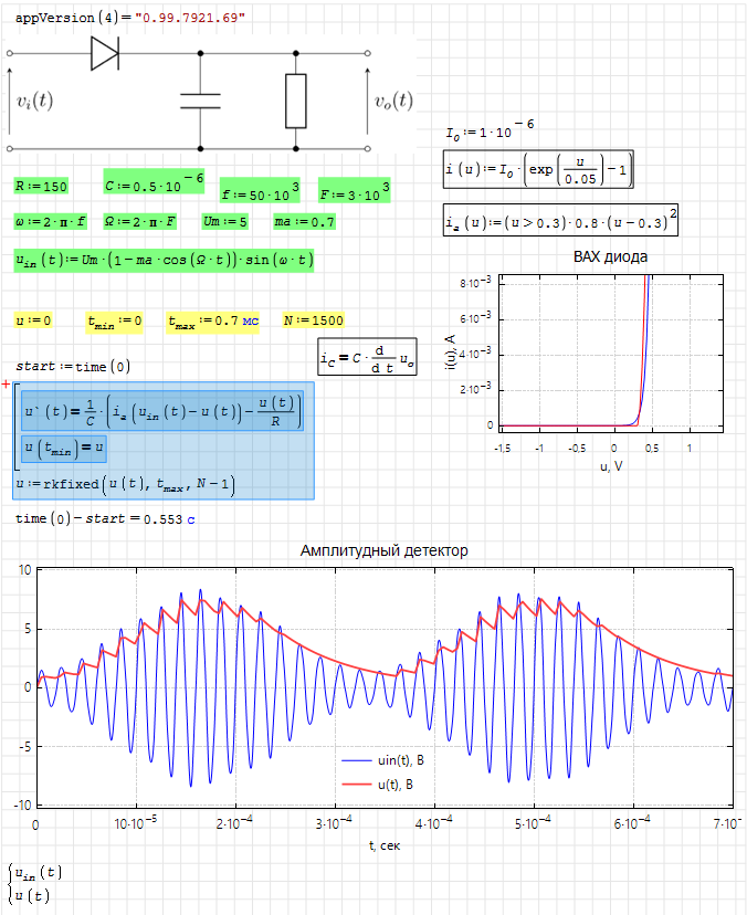

#94 Опубликовано: 28.11.2021 15:47:31
I have verified that linear interpolation is used, which is described in the manual.
I changed the interpolation method to linear and also changed the notation of the derivative by analogy ( "`" ).

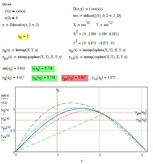

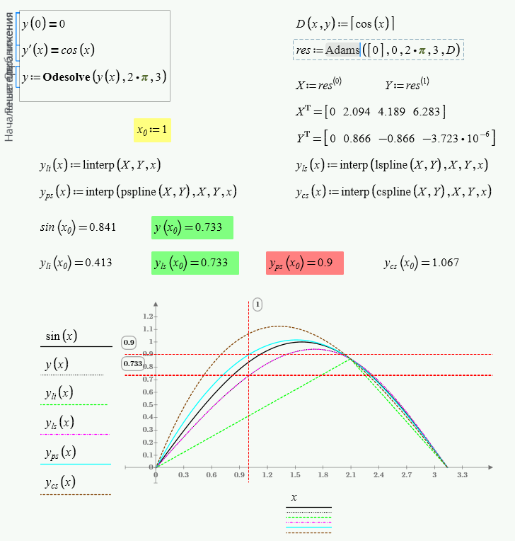

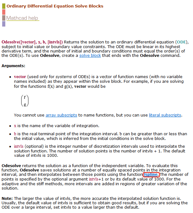

I was wrong. Linear interpolation and linear spline interpolation are different things. I will try to find the formulas that are used in these functions.

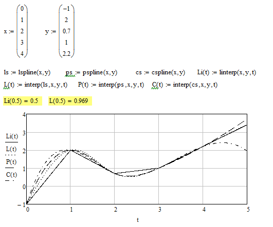

#97 Опубликовано: 29.11.2021 02:43:07
A simple test that shows the interpolation method used by the ODE solver. Obviously, the lspline() function is used.
Odesolve() with rkfixed method (Mathcad 15).
Odesolve interpolation test.mcd.zip (8,84 КиБ) скачан 508 раз(а).
The same for Mathcad Prime 7.0 (Adams method used).

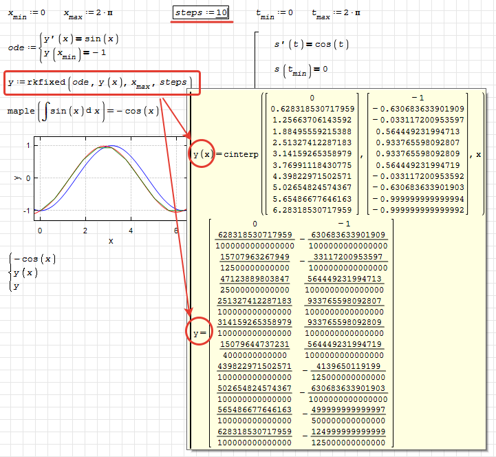

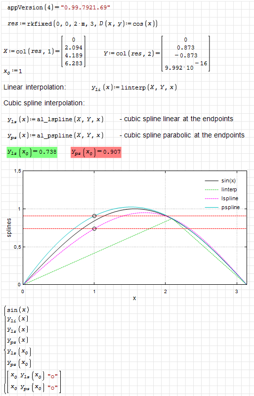

#98 Опубликовано: 29.11.2021 20:31:00
Ok, I found a bug in rkfixed() and finally figured out the difference between interpolation functions. In the picture below, I repeated part of the calculations from Mathcad. As you can see, to interpolate the numerical solution of the ODE, a cubic spline is used, linear at the end points.
Bugs will be fixed when the build server starts working.
Links:
1. Cubic spline
2. Cubic Spline Interpolation
Cubic spline interpolation using Mathcad (2009).pdf (256,71 КиБ) скачан 2762 раз(а).
#99 Опубликовано: 29.11.2021 21:30:48
Thanks Viacheslav ... superb demo.
BTW, I was wrong ODEsolve is lspline MCD 11.
Years ago, Tom G. had exposed the different deficiencies
wrt to each l_p_c cubic spline ... Matlab as well.
So, your next headache is to figure the best solver from
the huge Smath library [17], Mathcad stiff is Radau MCD 2001i, 11.
Cheers ... Jean.
