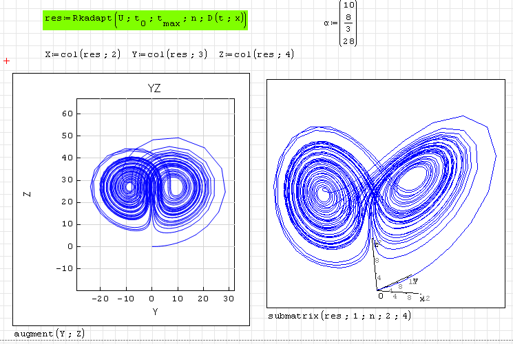

Rkadapt() algorithm. Unfortunately, it doesn't work.
Rkadapt prog.sm
Radovan Omorjan 12.11.2010 18:45:00

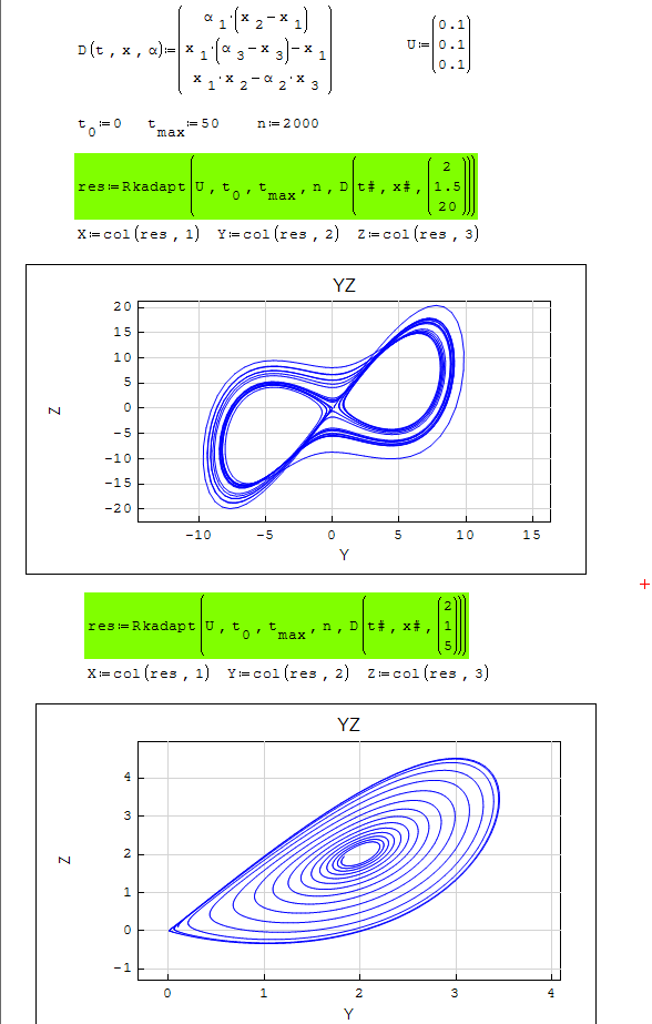

#16 Опубликовано: 12.05.2013 15:08:39
Just tried ODE plugin and figured out that it can accept additional parameters after the first two in D(x,y) function of derivatives.
I might miss that feature, but it should be pointed out that this is very nice and useful
I hope that some stiff solvers would be available sooner or later
ODE-Lorentz.sm (11,12 КиБ) скачан 2017 раз(а).
Martin Kraska 12.05.2013 17:27:00, Вячеслав Мезенцев 12.05.2013 15:50:00
#17 Опубликовано: 12.05.2013 15:48:41
Oh, you found a bug, well, I'll fix it
Usual, in such cases I use a different way of passing parameters, but it doesn't work for this example.
EDIT: I was wrong, it works.

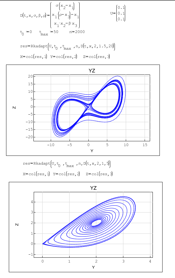

#18 Опубликовано: 12.05.2013 16:41:11
Oh, you found a bug, well, I'll fix it Usual, in such cases I use a different way of passing parameters, but it doesn't work for this example.
Actually, I thought this was by design and that I missed it , and now I am pleasantly surprised . I would prefer my solution, if you do not mind. This way, and in this case - there is a vector with three dependent variables, the rest are parameters (resulting the matrice with four columns). Your solution would have six variables - (resulting the matrice with seven columns). Your example is like the way it works in Mathcad (I never liked this way). If you need additional parameters you must put it in the vector, and use there derivatives equal to zero - it looks a bit artificial.
I also tried this one and it worked as well
Uni, please keep it this way and do not change it
ODE-Lorentz-2.sm (11,87 КиБ) скачан 1958 раз(а).

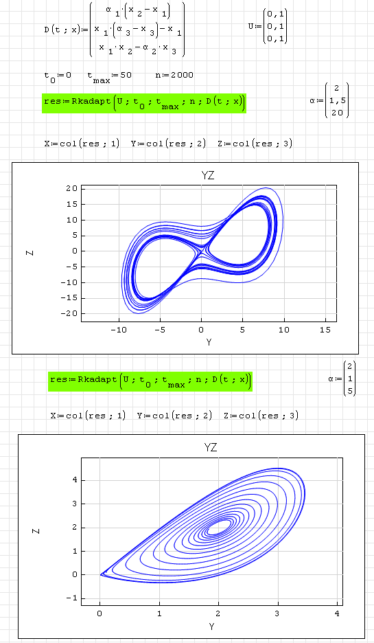

#19 Опубликовано: 12.05.2013 17:26:44
How about this dirty parameter handling...
Example.sm (12,33 КиБ) скачан 2083 раз(а).
Radovan Omorjan 13.05.2013 01:09:00
#20 Опубликовано: 13.05.2013 01:32:56
Thank you Martin,
Hmm... why dirty? Do not understand, sorry. This looks quite regular to me, except that it is not flexible. The third parameter must always have the same name as in the definition of D().
