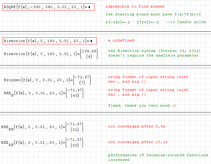

I did some simple testing, here are the results.
The screenshot is generated with standard settings for dec and arg delims.
Broyden and HRE.B generate errors with non-standard settings (dec , and arg . All other errors seem not to be custom settings related.
Quite interesting that solve(4) outperforms them all in the given example.
Most solvers that take intervals as arguments just allow one root in that interval.
Best regards, Martin
Thank you again Martin
see the attachment, the issues are fixed with the plugin in the following post.
regards,
w3b5urf3r
#102 Posted: 10/11/2012 7:28:36 PM
1,443 likes in 2,936 posts.
FOR TESTING PURPOSES ONLY
Hi all,
in the attached plugin:
- new functions NCGM(...) and NCGM.CD(...) - Nonlinear conjugate gradient method optimization algorithms;
- new function Gradient.CD(...) - central differences based Gradient;
- new function Jacobian.CD(...) - central differences based Jacobian;
- new function Hessian.CD(...) - central differences based Hessian;
- new functions GaussNewton.CD(...) and GaussNewton.CDGSS(...) - central differences based GaussNewton;
- new function LevenbergMarquardt.CD(...) - central differences based LevenbergMarquardt;
- new function NewtonRaphson.CD(...) - central differences based NewtonRaphson;
- new functions NewtonMethod.CD(...) and NewtonMethod.CDGSS(...) - central differences based NewtonMethod;
- increased performances on Gradient/Jacobian/Hessian-based functions;
- fixed issues of Broyden(...) and HRE.B(...) about custom settings;
- minor changes.

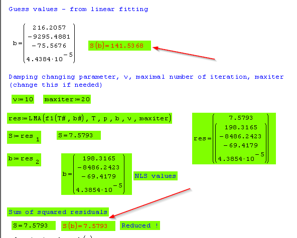

Hi w3b5urf3r,
thank you for the instant response. I confirm the points mentioned in your screenshot of post #101. Special thanks for your patience with custom settings. This aspect must be really annoying for those who use standard settings. I am insisting because I an teaching to german engineering students who are supposed to respect DIN standards.
In your HRE.RK example you used a precision with ° unit. That makes me wonder if I got the precision argument usage right. Is it a tolerance to the functions or to the variables? Both could be sensible convergence criteria. A given variable tolerance might be sensible if you solve for the displacements of a mechanical system based on equillibrium conditions. You might be satisfied with being within 1mm from the solution regardless how big the residual forces are.
I did some timing and convergence testing, see attachments. The results are a little surprising.

Hi w3b5urf3r,

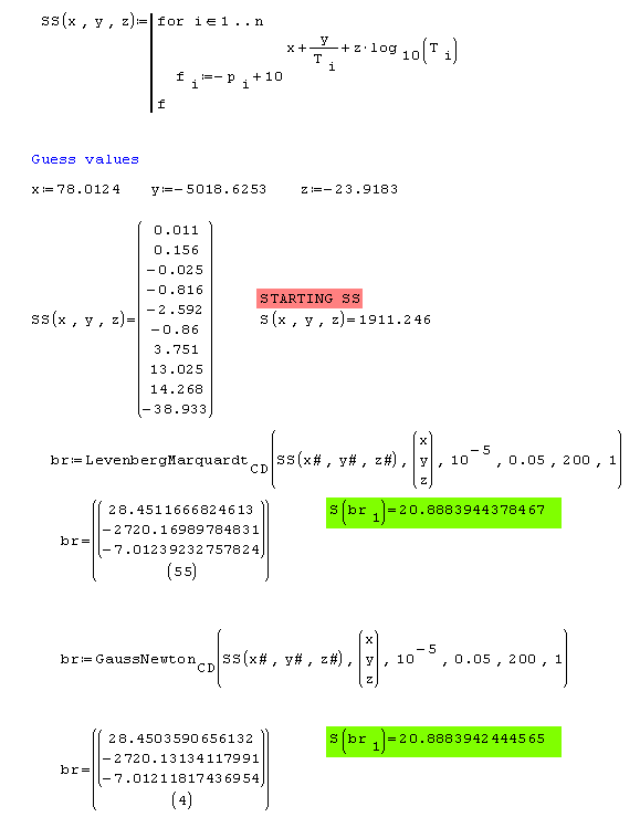

Hello w3b5urf3r,
I was playing a bit with optimization .CD functions - of course with my "famous" NLS example. The calculation time decreases on some more acceptable level (order of magnitude - few minutes each) and I could afford more runs for this testing. It seems that for this example the best performance had GausNewton.CD, NewtonMethod.CD and NewtonMethod.CDGSS. Morover, NewtonMethod.CDGSS performed the best (with a bit longer calculation time) - just compare with the result obtained by my LMA() function in the same file. I was expecting much more from LevenbergMarquardt() - to be quite good at this example, but it seems I was wrong. It was quite slow and rather inefficient. Actually, CD functions did some quite good job compared to the original ones. Hope that some more improvements could be done here
The attached are two files (worse and better initial conditions).
The picture is for the worse ones.

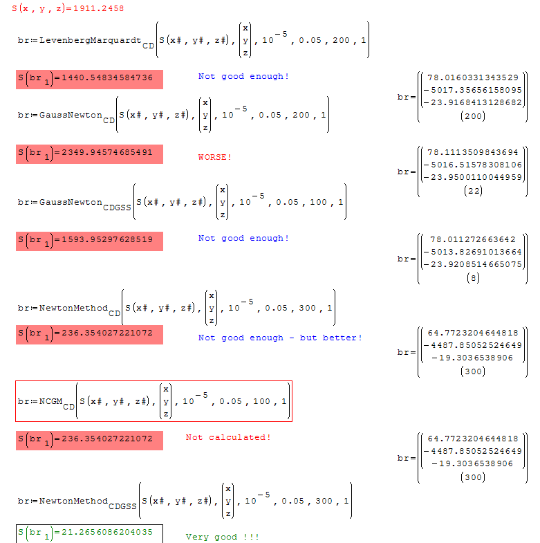

#107 Posted: 10/12/2012 2:03:19 PM
CONTINUE...
Here is another attempt, with the same problem but now directly minimizing the following standard sum of squared residuals - function S(x,y,z):
[MATH=eng]S(x,y,z):sum(((el(p,i)-10^{x+y/el(T,i)+z*log(el(T,i),10)})^2),i,1,n)[/MATH]
Again, it seems that NewtonMethod.CDGSS() performed the best for this example. Here are two files with better and worse initial conditions. The picture represented solutions with better initial conditions. I tried with different number of points (reduced the variable n in front of the function S(x,y,z) and the situation seems to be similar. NewtonMethod.CDGSS() was the best.
Those functions are promising requiring less computational time and hope that this testing and examples could give you some ideas how to increase the performance of those functions

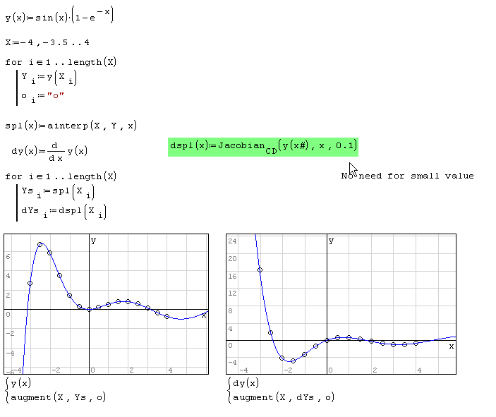

#108 Posted: 10/12/2012 3:48:26 PM
Hello w3b5urf3r,
It seems you've done something with the numerical derivatives - it seems quite accurate
Just for comparison see the post and the picture above regarding spline and spline derivatives . Jacobian.CD() - Gradient.CD() did the job quite well
Thank you very much

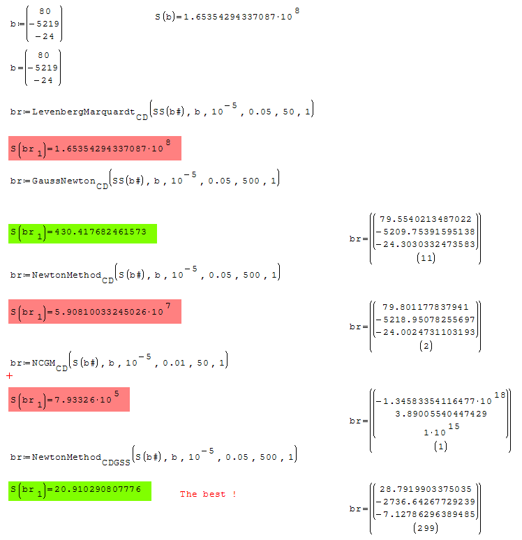

#109 Posted: 10/13/2012 7:41:00 AM
Hello w3b5urf3r
Instead of minimizing sum of squared residuals, I've tried now to use individual residuals in order to minimize them, that will sometimes work (Levenberg Marquard should do the job here). It appeared that it worked well and quite fast for most of the methods . See the attached files *7.sm and *7a.sm (better and worse guess values)
On the other hand, the squared residuals minimization is represented in files *8.sm and *8a.sm. It also worked quite well . Therefore, I am quite satisfied with these CD functions and this example solved in this way. Will see some other example next time.
P.S. It seems that NewtonRaphson.CD() is something wrong. I could not solve my test problem properly, as I was expected based on the previous post regarding numerical Jacobian. On the other hand, in your test file, NewtonRaphson() solved the problem in 7 iteration but NewtonRaphson.CD() solved the same problem in 344 iteration ?
#110 Posted: 10/13/2012 10:41:41 AM
Hello w3b5urf3r
Hi omorr,
thank you for your testings
You're right, the finite difference newton-raphson contains a bug, now is solved (BETA plugin updated).
EDIT Levenberg-Marquardt and Gauss-Newton general algorithms are built to work knowing both the system of equations (the residuals) and the cost function (the sum of squared residuals; the plugin calculated the sum o squares of systems inside any algorithm); the LMA(...) in your scripts accept the sum of squared residuals as input because have a custom Jacobian inside it;
GradientDescent(...), NewtonMethod(...) and NCGM(...) need only the cost function, so you can use as input what do you want.
Hello w3b5urf3r,
Thank you very much
I'm surprised o_o ; I've done nothing strange, just a "generalization" of Finite difference in several variables... maybe have you changed some parameter in your test (f.e. the perturbation value)?
regards,
w3b5urf3r
#111 Posted: 10/14/2012 3:33:11 AM
Hello w3b5urf3r,
As your fan , I am going to bother you some more
Thank you for correcting NewtonRaphson.CD(). It seems to work and the attached is the picture from my many times mentioned "nightmare example". It solved it very well . Take a look at the first picture attached.
Thank you for the explanation of this. To be honest, I used my test example without to much thinking about the residuals, cost function - tried everything.
Here I tried CD functions with the same example with adding one parameter (there are four parameters now). Unfortunately, all of them failed - see the attached files (*9.sm used just residuals, *9a.used squared residuals, *9b.sm used sum of squared residuals (cost function)). I might make some mistake or wrong choice of perturbation parameters or tolerance. See please the bottom of every file. My "home made" LMA() function did something, reduced the value of cost function and it seems successful here - see the green regions above (the second picture attached). If I did not do anything wrong here I hope that this will also help you to further improve these functions
