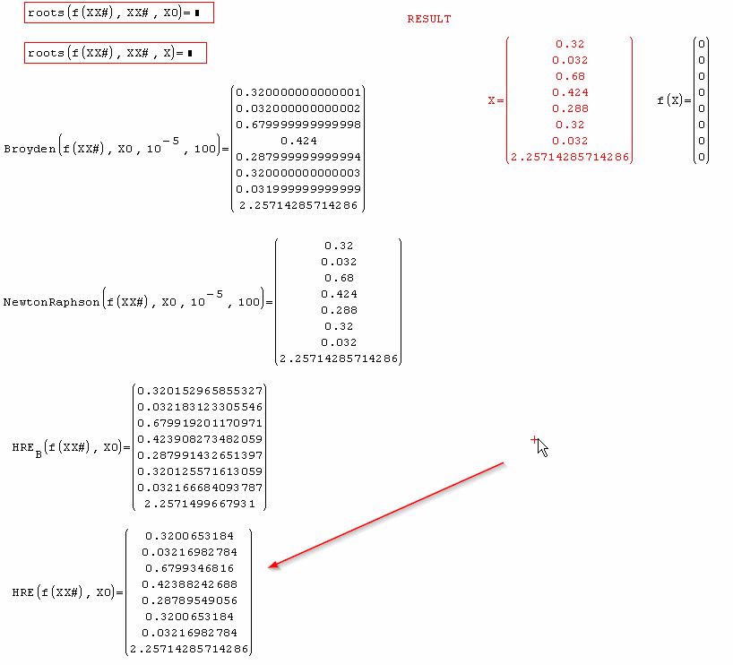

Hello w3bsurf3r,
Let's go again with testing
I attached a file where all solvers failed. Do not understand why. Could you take a look at it please.
Thank you omorr
There was an hidden omission in the parser that limited to 7 the maximum number of equations... issue fixed and plugin reupdated.
best regards,
w3b5urf3r
P.S. I've deleted the old plugin code from the previous post, the updated code is attached here.

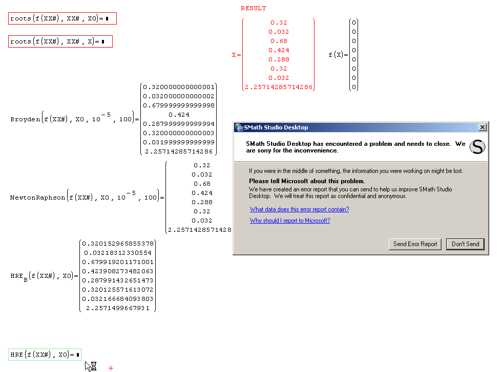

#42 Posted: 9/14/2012 5:54:35 PM
Thank you w3bsurf3r the quick response
I am very grateful to you and that my examples can finaly be solved in SMath . There will be more examples to come, of course.
Could you please check this out once more. Actually, HRE crashes for the same example. It might be due to my computer WinXP(32). I will check this out tommorow on Win7(64) as well.
#43 Posted: 9/14/2012 6:21:01 PM
1,443 likes in 2,936 posts.
Happy to be useful
About the crash, I have no ideas
The [MATH lang=eng]HRE(f(XX#),X0)[/MATH] works fine for me (win7 x64), with any optimization and decimal outputs...
The only difference between HRE and HRE.B was the solvers (Newton/Broyden) and both works for you; I think that Andrey could know the cause, for me is absolute darkness
regards,
w3b5urf3r
#44 Posted: 9/15/2012 2:38:11 AM
Thank you w3b5urf3r,
I put this on the Bugs forum including the Hang report. Hope that this will make any help to Andrey.
EDIT: Unfortunately, it crashes on Win7(64) and in Ubuntu for me as well. In Ubuntu "Stack overflow" error appeared.
Primer43-Ubuntu (53.11 KiB) downloaded 2377 time(s).

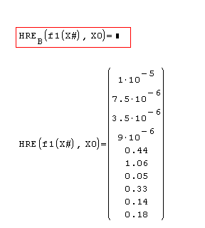

4TESTINGONLY_NonLinearSolvers.zip (9 KiB) downloaded 572 time(s).
#46 Posted: 9/16/2012 2:06:14 AM
Hello w3b5urf3r
This is working now just great . Thank you very much
Find attached the pictures both from the WinXP(32) and Win7(64)

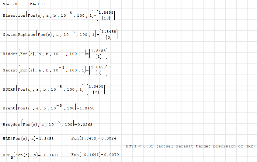

Hello w3b5urf3r
Great,
it seems that the number of nested iterations was excessive to handle, I just placed some eval here and there... :d

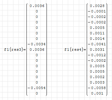

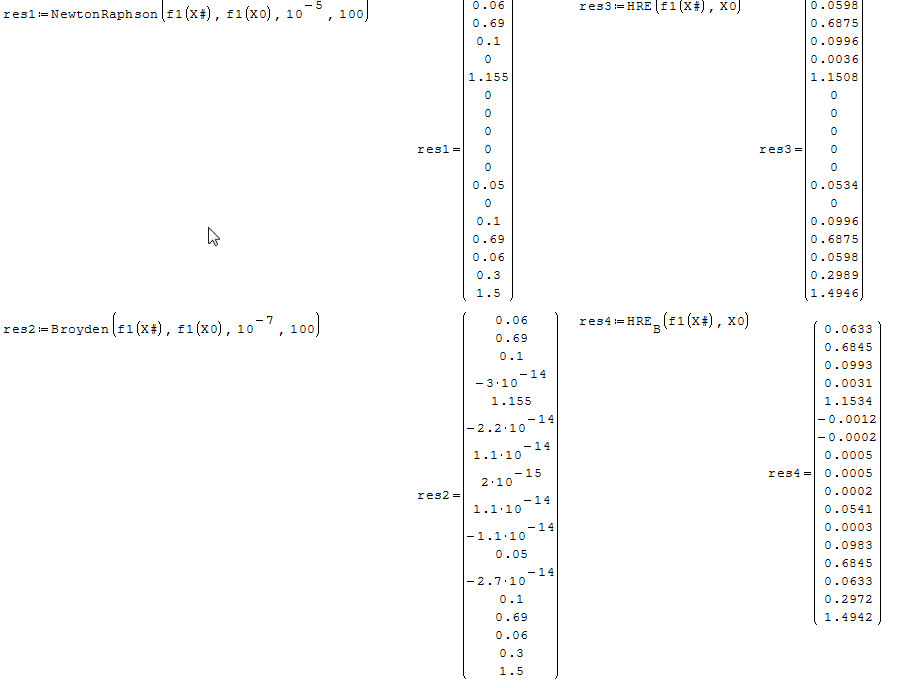

#49 Posted: 9/16/2012 8:22:27 AM
Hello w3b5urfer,
Here is another similar problem like the previous ones. This is a 17x17 problem. Again, problem is linear and solved with nonlinear solvers (roots() failed here). The results are quite good except the HRE.B gives a bit poorer results.
#50 Posted: 9/16/2012 11:42:18 AM
Hello w3b5urfer,
Hi omorr,
most likely both will be revisited...
actually HRE/HRE.B are based on the simplest algorithm that I've found, and seems that it's quite onerous (Broyden and Newton are both much more faster), so I think that Homotopy function (at the time, at least) should be used only for testing purposes or when both Broyden and Newton fails; consequently I've limited the CPU usage using this convergence criterion: f(x)<10^-2 with no more than 100 sub-iterations for each Homotopy iteration (no more than 1100=100x11 iterations for HRE and 2200=100x2x11 iterations for HRE.B).
BTW note that in both case the convergence criterion is met (see the attachment).
regards,
w3b5urf3r

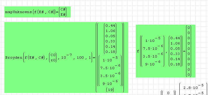

#55 Posted: 9/27/2012 2:04:36 PM
Hello w3b5urf3r
I was playing a bit with this test version, of course .
This feature you included if awesome
Broyden is working very well, just playing with tolerance, Decimal places and Exponential threshold - everything looks fine then (see the picture please ). I was just playing a bit with it, it seems quite good for this example except HRE.B gives different results with and without multiple unknown names - see the attached file please. Actually, no big deal about homotopy methods at the moment as you explained

#57 Posted: 9/27/2012 5:38:39 PM
Hello w3b5urf3r
Hi omorr, :d
yes the new features are very awesome
when I have more time I will try to improve the Homotopy functions; as already said the target precision is [MATH]10^-2[/MATH] and is reached in both the examples
Hi w3b5urf3r and Radovan,
I'm delighted seeing your interesting work.
I tried to apply the plugin to one of my problems - one equation - here attached.
It is obvious that the ability of various algorithms is enough dependent on the initial guess.
I'm interested if you have some suggestions concerning the initial unknown guess strategy for this case, seeing the parameters variation ranges.
Thanks and congratulations again for your work,
Ioan,
Hi Ioan
The HRE functions need 2 arguments, no more (see the attachment).
The initial unknown guess strategy It's a common issue, Homotopy and Bisection I think they are the best approaches.
Note that in your script a "large" bound it's better than a little bound.
best regards,
w3b5urf3r
