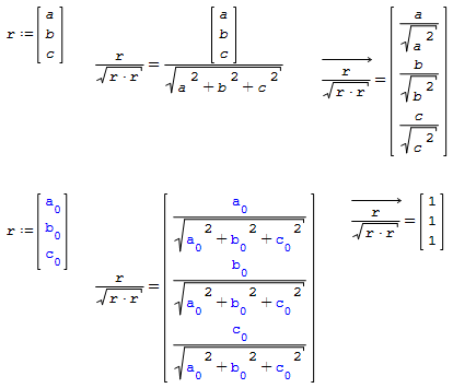

Hi Alvaro your proposal to use vectorize() for products of undefined variables with vectors is recomended by Andrey as well. But here is a simplified example of what can happen using this approach:
Unit vector.sm (8.2 KiB) downloaded 1717 time(s).
In both cases, vectorization is dangerous as it doesn't fail in an obvious way but rather silently produces wrong results.

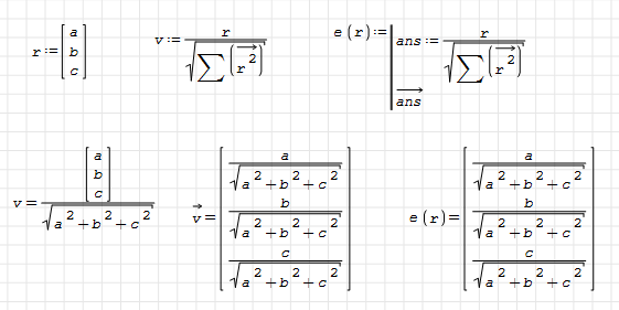

Hi Martin. You're right, vectorization in SMath, just like it did in mathcad, can easily produce results that aren't what one would expect, not to mention the one you mentioned earlier that varied depending on whether it was assigned to a variable or not. And as you very well say, it is not a recommended practice to try to explain the erratic behavior of a software in class, even more so if there is really no way to deduce what is due to it. And although perhaps an explanation could be found for that unit vector version, for the other one I don't really find sense. So I think it's a good idea that you could work with units to imply scalars. It would be necessary to add that the sum of these 'units' does not report an error so that its application is broader.
BTW, a workaround, but although I understand (I guess) why your example gives a "wrong" result, I'm not quite sure why this version gives a "correct" one. Maybe it's because the vector is already "spent" on the addition, but the rules are not clear as to why the addition "arrives" before the vectorization. That is to say, if I were to present this in class, assuming it was ethical for me to try to explain it, I would probably be in troubles if someone asked the slightest detail why that result is obtained.

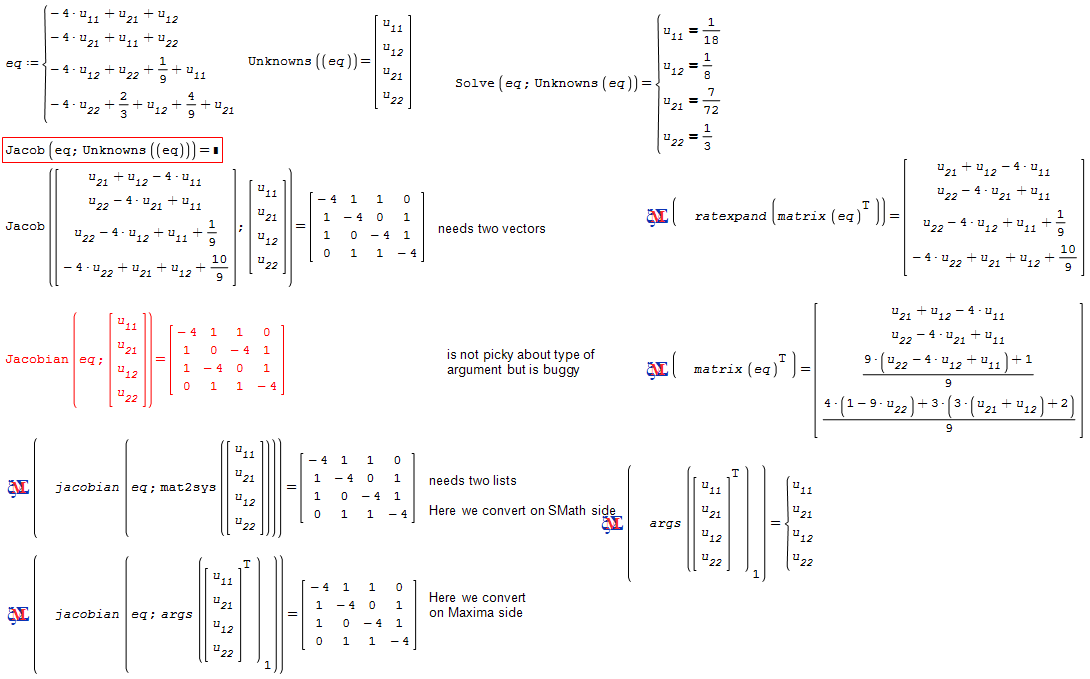

It seems that there is a bug in Jacobian() from Nonlinear Solvers.
The application is to convert a system of equations to matrix form.
The built-in Jacob() function and Maxima's jacobian() work as expected, once you provide the correct type of arguments.
Jacobian() seems to not obey the order of entries in the variables vector (using the ordering returned by Unknowns() ).

WroteIt seems that there is a bug in Jacobian() from Nonlinear Solvers.
Odd, I'll check it, thank you Martin.
