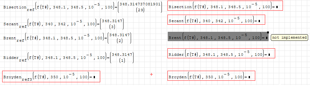

NonlinearSolvers plugin - BDQRF, Bisection, Brent's, Broyden's, Newton-Raphson, Ridder's, Secant, Homotopy - Messages
This plugin contains some root-finding methods and optimization algorithms.
Password (Extensions Manager): NonlinearSolvers

Plugin handles primitives listed below:
Root finding methods
BDQRF("1:function", "2:delimiter", "3:delimiter", "4:variable", "5:variable") - Bisected Direct Quadratic Regula Falsi root-finding method of function(s) "1:function", giving a couple of delimiters; calculation have "4:variable" result precision and no more than "5:variable" iterations. Returns a vector of solutions (if any) and the number of iterations if the optional argument "6:variable" is set and different from 0.
Bisection("1:function", "2:delimiter", "3:delimiter", "4:variable", "5:variable") - Bisection root-finding method of function(s) "1:function", giving a couple of delimiters; calculation have "4:variable" result precision and no more than "5:variable" iterations. Returns a vector of solutions (if any) and the number of iterations if the optional argument "6:variable" is set and different from 0.
Brent("1:function", "2:delimiter", "3:delimiter", "4:variable", "5:variable") - Brent's root-finding method of function(s) "1:function", giving a couple of delimiters; calculation have "4:variable" result precision and no more than "5:variable" iterations. Returns a vector of solutions (if any) and the number of iterations if the optional argument "6:variable" is set and different from 0.
Broyden("1:function", "2:condition", "3:variable", "4:variable") - Broyden's root-finding method of function(s) "1:function", giving an initial guess "2:condition" for each variable; calculation have "3:variable" result precision and no more than "4:variable" iterations. Returns a vector of solutions (if any) and the number of iterations if the optional argument "5:variable" is set and different from 0.
HRE.B("1:function", "2:condition", "3:variable", "4:variable") - Homotopy root-estimation method of function(s) "1:function", giving an initial guess "2:condition" for each variable, using the Broyden algorithm; calculation have "3:variable" result precision using "4:variable" homotopy transformations. Returns a vector of solutions (if any) and the number of iterations if the optional argument "5:variable" is set and different from 0.
HRE.NR("1:function", "2:condition", "3:variable", "4:variable") - Homotopy root-estimation method of function(s) "1:function", giving an initial guess "2:variable" for each variable, using the Newton-Raphson algorithm. Returns a vector of solutions (if any) and the number of iterations if the optional argument "5:variable" is set and different from 0.
HRE.RK("1:function", "2:condition", "3:variable", "4:variable") - Homotopy root-estimation method of function(s) "1:function", giving an initial guess "2:variable" for each variable, using the Runge-Kutta 4th order algorithm; calculation have "3:variable" result precision using "4:variable" homotopy transformations. Returns a vector of solutions (if any) and the number of iterations if the optional argument "5:variable" is set and different from 0.
Jacobian("1:function", "2:variable") - Multi-purpose derivatives of "1:function" evaluated in "2:variable"; returns differentiations/gradients/Jacobians.
mapUnknowns("function") - Symbolical variables mapping of "1:function"; returns a vector of unassigned variables.
NewtonRaphson("1:function", "2:condition", "3:variable", "4:variable") - Newton-Raphson root-finding method of function(s) "1:function", giving an initial guess "2:condition" for each variable; calculation have "3:variable" result precision and no more than "4:variable" iterations. Returns a vector of solutions (if any) and the number of iterations if the optional argument "5:variable" is set and different from 0.
Ridder("1:function", "2:delimiter", "3:delimiter", "4:variable", "5:variable") - Ridder's root-finding method of function(s) "1:function", giving a couple of delimiters; calculation have "4:variable" result precision and no more than "5:variable" iterations. Returns a vector of solutions (if any) and the number of iterations if the optional argument "6:variable" is set and different from 0.
Secant("1:function", "2:variable", "3:variable", "4:variable", "5:variable") - Secant root-finding method of function(s) "1:function", giving a couple of points; calculation have "4:variable" result precision and no more than "5:variable" iterations. Returns a vector of solutions (if any) and the number of iterations if the optional argument "6:variable" is set and different from 0.

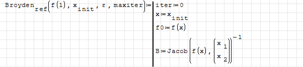

Here is a bit of testing the Broyden plugin. It is a clasical "driving crasy" situation with multiple solutions. It was mentioned by kilele in the link to the document http://en.smath.info/forum/yaf_postsm7678_solve---and-roots-----again.aspx#post7678
Your plugin failed (if I did not do something wrong) but do not worry about it - it is a common situation. The problem is why "Can not calculate" error returned. I do not know. My function returned another solution than few Newton-Raphson iterations or roots(). I also used another software that uses some kind of broyden algorithm and here is the result - the same as roots() returned
>function f(x):=[(x[1]+3)*(x[2]^3-7)+18,sin(x[2]*exp(x[1])-1)]
>x0:=[-0.5,1.4]
[ -0.5 1.4 ]
>f(x0)
[ 7.36 -0.150285529841 ]
>res:=broyden("f",x0)
[ 0 1 ]
>f(res)
[ 0 0 ]
Here is the picture and the sm file
Broyden_testings-1.sm (53.53 KiB) downloaded 2052 time(s).

WroteHello w3b5urf3r,
Your plugin failed (if I did not do something wrong) but do not worry about it - it is a common situation. The problem is why "Can not calculate" error returned. I do not know. My function returned another solution than few Newton-Raphson iterations or roots(). I also used another software that uses some kind of broyden algorithm and here is the result - the same as roots() returnedTry, for instance to change the guess values (vector x0) from [-0.5,1.4] to [1,4].>function f(x):=[(x[1]+3)*(x[2]^3-7)+18,sin(x[2]*exp(x[1])-1)] >x0:=[-0.5,1.4] [ -0.5 1.4 ] >f(x0) [ 7.36 -0.150285529841 ] >res:=broyden("f",x0) [ 0 1 ] >f(res) [ 0 0 ]
The function as in the *.sm file doesn't work because the first approximated inverse jacobian ( B ) is an Identity matrix... i've seen that is a common issue (f.e. root finding methods)... in SMath this could be fixed using the Jacob() function on the user input solution (see the attachment).
Unfortunately the function Jacob() (as well as other functions such as error() function) are not in the 4 standard libraries; I will try to see if importing the library on which it was made by Andrey can be implemented.

I would suggest you to strictly avoid using Jacob() inside Broyden - it will get new troubles. I really do not know what to use instead as a first Jacobian approximation. If someone have any idea, please help.

the algorithm is similar to that shown in the attachment (replace the B update definition to see the different behavior).

As for the Jacob() function, I thought that Broyden didn't use Jacob directly but an approximation..

@w3b5urf3r Based on the picture in your previous post (many methods in a plugin), did I say that you are my hero?
