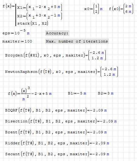

I know, but I'm trying to pay attention to the management of functions with unit of measurement... although I have not advertised this behavior, actually all solvers shown below works also with units. Introducing new covengence criteria preserving this aspect implies a more advanced error handling (and developping time)...

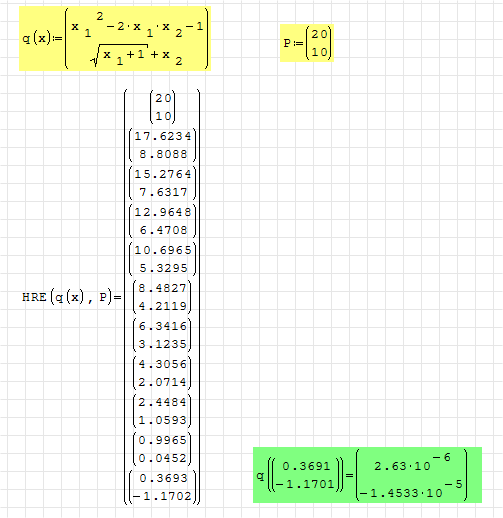

little experiments in SMath with Homotopy... it's a very interesting and powerful tool b)
regards,
w3b5urf3r

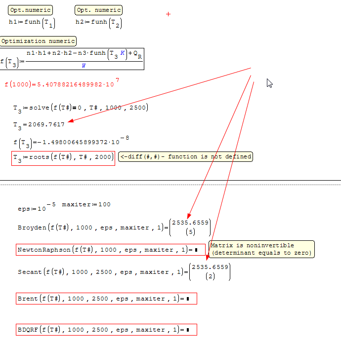

Some more testings and surprises. I attached one of my files and tried all the nonlinear solvers including the SMath solve, roots() and all of them made by w3b5urf3r up to now
I attached a part of my file (primer63w.sm). Here is another situation regarding SMath optimization. The first picture is when the Symbolic Optimization of the function is applied. Everything seems to be fine (although two functions failed - roots(),NewtonRaphosn()). Strangely, when the Optimization is none, numeric - all of them failed and just look at the second picture - now the result of f(1000) is a vector and not scalar as before. This is due to the situation where we have the product of two vector - the result should be a scalar (scalar product of two vectors). When we change some Optimization in the file we can even get the result as in the third picture - solve() gave the result but the other two solvers have different results than solve(). Something must be strange here because other solvers failed. The main problem here is that SMath sometimes returns scalar and sometimes vector depending on optimization applied (fourth and fifth picture on the next post). I think I made some mistakes but can not figure out what happened here.
Could someone take a look at this please.

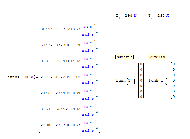

Continuing from the post above with two pictures - the result is scalar or vector of scalar product of two vectors - depending on optimization. Do not know why?.
#37 Posted: 9/13/2012 2:12:44 PM

seems there are many little issues (see the attachment)...
if you use a line in the definition of funh(T), the behavior changes further
regards,
w3b5urf3r
Primer63w_debug.sm (102.24 KiB) downloaded 1610 time(s).

Thank you for checking this out . I can join you with "don't know why" statements about this. I am not sure but I think that has something to this Transpose-functions-bug
I hope that Andrey will have some time to check this out as well.
EDIT: I might be completely wrong here but I think if eval() could be used in funh():=eval(...) many of the numerical problems might be overcome.

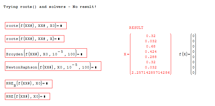

Hello w3bsurf3r,
Let's go again with testing
I attached a file where all solvers failed. Do not understand why. Could you take a look at it please.
