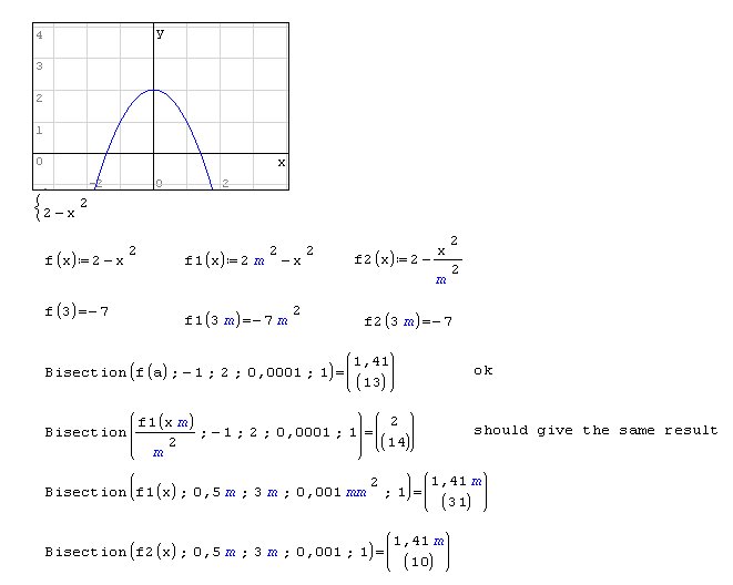

Hello w3bsurf3r,
thanks again for the help. Now I can take advantage of the unit capabilities of your plugin at least for scalar equations. That already renders the solution of my example quite lean. No need for dimensionless variables any more.
Martin

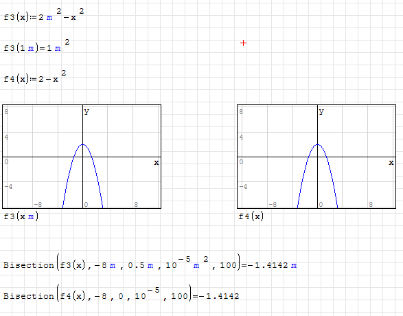

#129 Posted: 2/7/2013 1:22:45 PM
1,443 likes in 2,936 posts.
Hello w3bsurf3r,
I am again running into problems with equation solving. I never can exclude wrong operation but these seem like bugs.
Broyden and HRE.B do not handle zero starting values
Brent fails to solve a linear equation.
Martin
Hi Martin,
Yes, Broyden can't be solved with units if you use a null initial guess... In SMath Studio the 0 value have no units by default, I've already mentioned this behavior writing the first UoM() snippet function (I'm not sure if this is related to some SMath feature or it's a simple lack).
I can improve the function looking for units inside the 2nd error parameter (if any), but nothing more... As for now you can use a small number (f.e. 10^{-15}*'mm)
About Brent I see an "Units don't match" error, I need to investigate...
Thanks again for your testings
w3b5urf3r

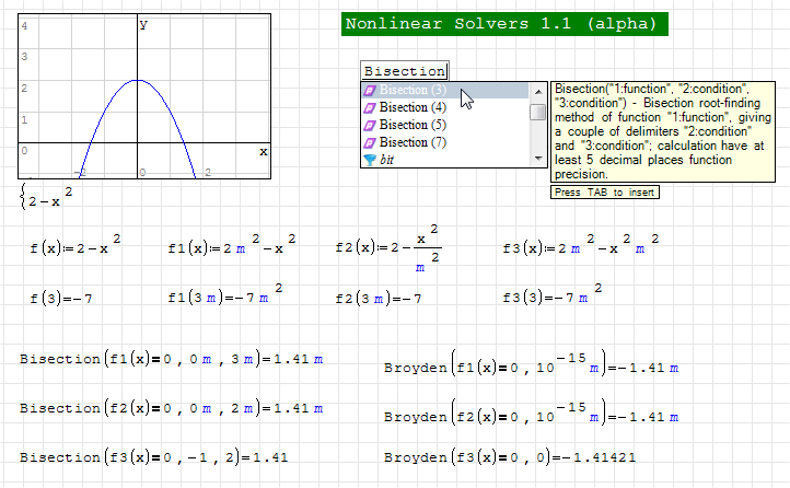

You're absolutely right!
However (IMHO) the native units support for zero values in SMath would be very appreciable

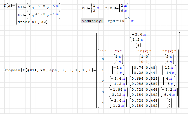

"The plotted course"
EDIT: previews
SMath Studio - [Units Testings.sm]_1.pngSMath Studio - [Units Testings.sm]_2.pngSMath Studio - [Units Testings.sm]_3.png

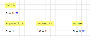

In general, 0 is more than just a real number or place holder representing, in this case, an empty set. When it comes to systems with units, 0 is actually a chameleon with universal units (in the same way that type O blood is for universal donor). It can be handled by either treating each 0 as a function that transforms the number unitless 0 into a 0 with units of its surrounding factors as appropriate for the calculation, or by changing the rules of the uses of units as programmed into smath so that units associated with 0 (whether present or not) are completely ignored and all unit determinations are made by use of units provided by all non-0 factors.
#134 Posted: 3/4/2013 7:25:31 PM
I agree with your logic
However I hope that in future the numeric optimization can preserve the units for zero values
