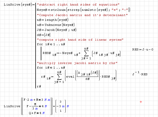

Here is a proposal for a unit-proof and user-friendly linear solver.
Davide, I propose to include it in the NonLinearSolvers plugin, perhaps as FindRoot(1).
- Equations can be specified using boolean equal with arbitrary distribution of linear and absolute terms to left and right hand side
- equations and unknowns can have arbitrary and different units
- no need for initial guess
- no need for specification of result units
I was not able to reproduce the embedded assignment feature in the example procedure. I would propose to enable that by default and perhaps provide an optional assignment flag.
Also, a linearity check (e.g. hessian-based) might be sensible.
The procedure LinSolve() looks more cumbersome than it ought to be, because of unreliable symbolic matrix inversion and multiplication. Fortunately, the alg() function works and thus the inverse can be computed with moderate coding effort.
LinSolve() provides an alternative for "hand made" sparse linear systems, as they typically occure in basic engineering mechanics. For densly populated systems, the matrix notation of the system might be more appropriate.

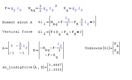

#149 Posted: 8/5/2013 3:31:53 PM
I agree
BTW also DotNumerics contains some linear solvers
You are right , and that is very useful by using different algorithms for say, overdetermened, underdetermined systems etc. (some testing from the users might be useful here). Moreover, as I figured out, these functions need matrices of the system A and resulting vector B. Martin posted an alternative to this problem and gave it in a bit different form pointing out to the FindRoot() functions from NonlinearSOlvers plugin and equations given with boolean equal to. I've just commented that because this remind me on the ability of some symbolic engines which are capable of solving the linear equations which do not look linear at all at, a first glance. I meant something like this:
[MATH=eng]maple(solve(sys(5*x-6≡8,5+6*x/y≡10*z/y,x/y≡3,3,1),sys(x,y,z,3,1)))=mat(14/5,14/15,161/75,3,1)[/MATH]
but I do not know if something like this could be done directly in SMath.
ioan92 8/5/2013 3:35:00 PM

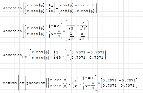

#154 Posted: 11/11/2013 5:36:24 PM
Why not Jacobian(), Jacobian.CD() from this plugin?
#155 Posted: 11/11/2013 6:10:10 PM
1,361 likes in 2,275 posts.
Because I just wanted to fill the gaps of the active book function reference. I had the impression from the test file that the function was meant to handle vector functions. Davide, correct me if that is wrong.
#156 Posted: 11/11/2013 6:39:55 PM
Yes, you are right about the test file (Gradient_testing.sm). I did not remember this in the first place, but guessed there must be a reason you asked about it

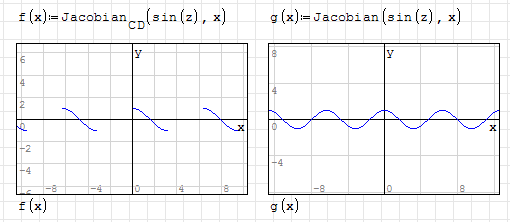

#159 Posted: 12/2/2013 8:02:24 PM
Jacobian.CD seems to be unstable.
Davide, do you have any valid test or demo file, describing the expected functions?
#160 Posted: 12/3/2013 8:48:22 AM
1,443 likes in 2,936 posts.
Thank you Martin,
you are right, I'll try to fix it...
