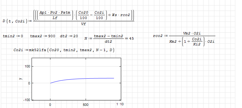

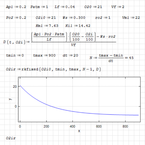

Hello everyone, I have started to use this program from just a couple of days and I have some problems with the model that I'm trying to implement.
So basically I have two ODE with into them some parameters that changing in time...Obviously, nothing work and I would like to have a little bit of help.
Ok, I'm not the best at explaining this, so I attach the file and I hope that someone can give me some good advice to make this thing work!
Prova modello permeabilita.sm (128.28 KiB) downloaded 1027 time(s).

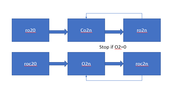

Basically, this set of equations should describe the evolution of the atmosphere inside a packaging.
So we have O2i which is the evolution of oxygen inside the packaging, which decreases because inside there is a fruit that breathes.
Co2i is the evolution of CO2, which increases because the fruit emits it.
ro2 and rco2 would be the breathing of the fruit, which also changes according to the atmosphere of the packaging.
Is a model that you can find in the article:
Modeling respiration–transpiration in a modified atmosphere packaging system containing blueberry
Yoonseok Song a, Nick Vorsa b, Kit L. Yam a,*
And yes...probably isn't the best choices for a first try but unfortunately its what I need
Now I try to fix a little bit better the file and we will see what other problem come out :d

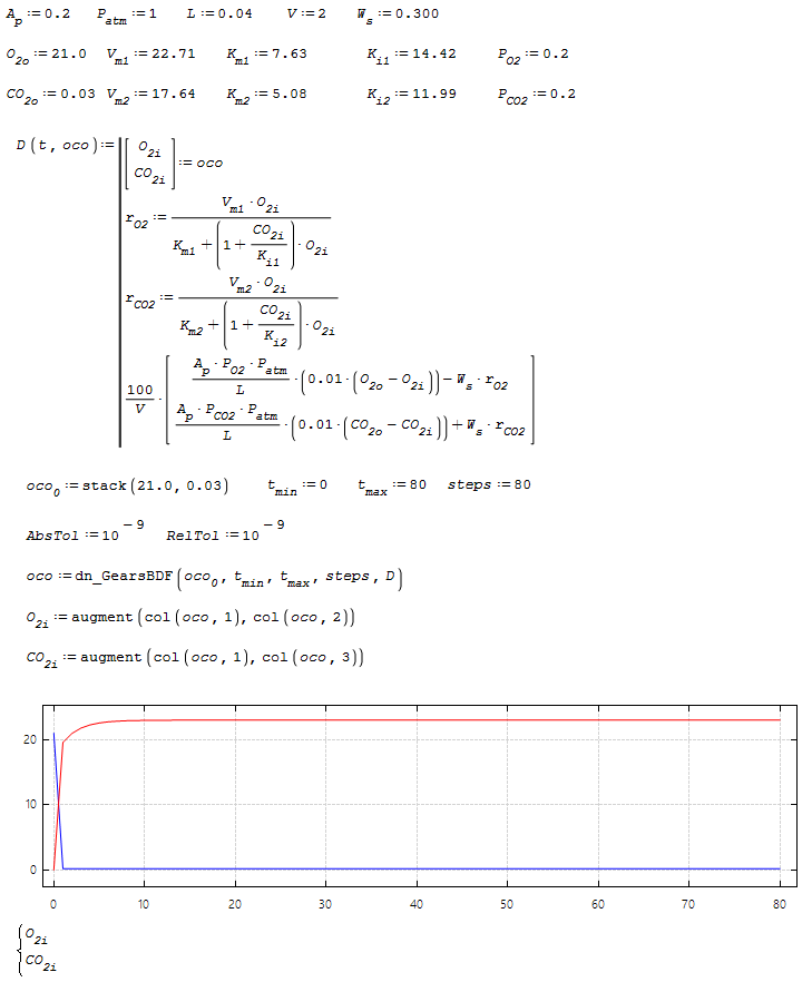

Ok, seems that I was able to do some progress here but, obviously, there is something that I think doesn't work
In your opinion this way the value of rco2 change with the new value of Co2i or it remains the initial value that I have set?
Prova modello permeabilita.sm (129.47 KiB) downloaded 946 time(s).

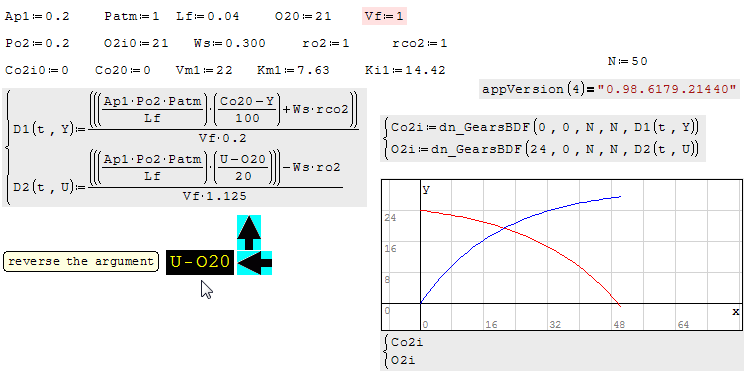

#8 Posted: 2020/11/23 12:18:13
#9 Posted: 2020/11/23 12:26:42

#10 Posted: 2020/11/23 12:45:47
1,554 likes in 1,864 posts.

What I want to obtain is the evolution of the atmospheric concentration and respiration in the packaging.
So something like
That is more or less what uni has done

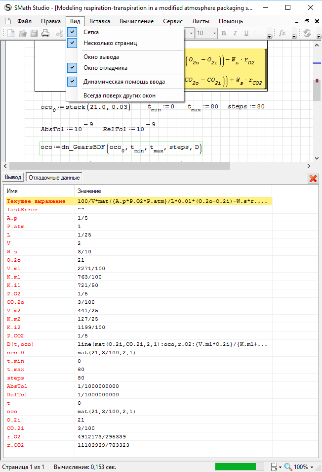

#15 Posted: 2020/11/23 23:55:07
You can set breakpoint on line in D(t,oco) and you will see how values changed.

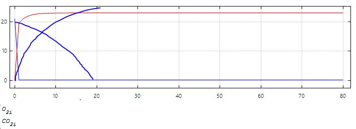

In general, there is something that doesn't work properly, because the chart describes the depleting and the increment almost linear until the O2 don't reach 0. After that point the CO2 increment start to being described in a "realistic way
I mean, I'm expecting to see something like that (the thick blue lines)
Veniamo da molto lontano e andiamo molto lontano! Palmiro Togliatti

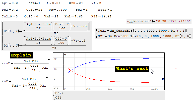

#19 Posted: 2020/11/24 11:06:59
Like this ??? ... freak parameters at will .
#20 Posted: 2020/11/24 11:36:51
... up to You the expert !
Prova modello permeabilita.sm (129.71 KiB) downloaded 1035 time(s).
