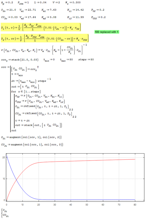

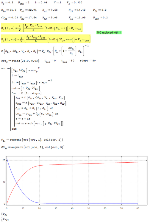

It is possible to solve the system in this way, i.e. integrating each equation separately. But here you need to be very careful.
Modeling respiration-transpiration in a modified atmosphere packaging system containing blueberry 2 (uni).pdf (83.13 KiB) downloaded 557 time(s).
