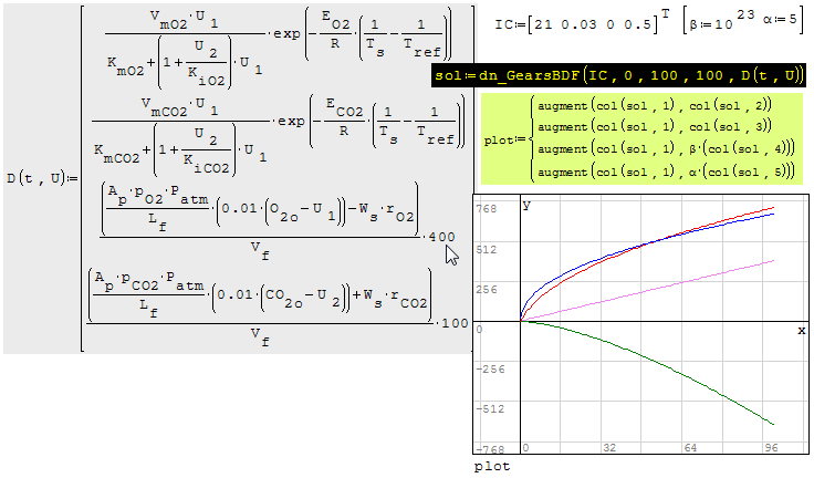

#65 Posted: 2020/12/2 11:08:26
Few comments:
1. Just capture what you need, not the all work sheet.
Freeware WinGrab ... I use for last 20 years.
2. DE's system are universal in vector format. Exhaust the 17 native Smath.
Exceptionally, I found only one that did the project [which one now ?]
3. I'm not arguing about ISODA. However, if you can't have it in
normalized format => recycle bin.
4. Your preamble coefficients open in most glorious mess in my SS 6179.
5. Construct the image ... as you hover the vector, you see the internal expansion.
Often, that is damned useful for export.

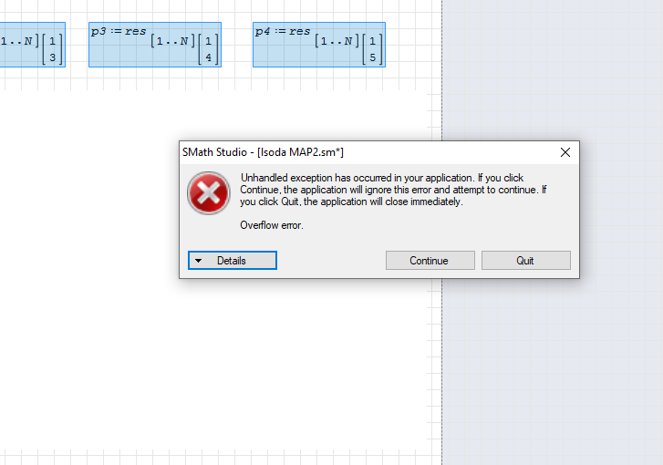

#67 Posted: 2020/12/2 19:57:57
The problem is in the X-Y Plot plugin. It cannot display the input data because it is outside the normal bounds
@ 0.037 nanometer the diameter of H atom, how many zillions years you will have
to hammer this atom down to X^-25 m in that green plot. That result is wrong from
some input coefficients/construction.

Jean your observations are all right, especially the 4! I need to be more ordered in all these works, and you haven't seen my papers works! 5 I need to learn how to do that, but export all the output in excel to have better graphs would be lovely.
And I have absolutely to try to make all the system with D(t,U) and gearsBDF!
:d Today, I swear, I have two things to do, the first is to read a little on how to rewrite all the mess in a more elegant way, and try a different approach...the second is to put a little bit of order and coherence in the data, so all in IS and real.
Veniamo da molto lontano e andiamo molto lontano! Palmiro Togliatti

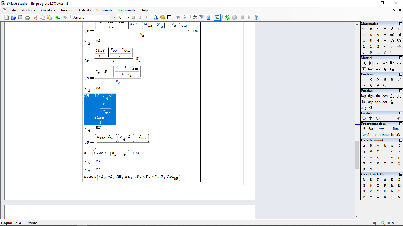

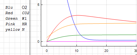

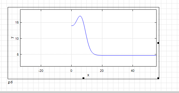

#77 Posted: 2021/1/10 16:14:39
francesco88
francesco88
1 likes in 34 posts.
So, after a while, I'm back.
The work is still in progress, but things start to make sense.
I really don't know if my use of the "grammatic" in the system is correct or if I'm only lucky, but the results on paper are reasonable.
The "big" issue now is to make the "if" work properly, but in a way or another I will fix that problem.
I'm exploring different solutions.
As soon I will have the possibility to validate it I will put here the final work.
The model is something like a spherical horse for sure, a lot of simplifications, but I'm facing really a lot of troubles to obtaining a correct connection in the variables.
Anyway, I'm having a lot of fun.
In progress LSODA.sm (60.26 KiB) downloaded 1026 time(s).
