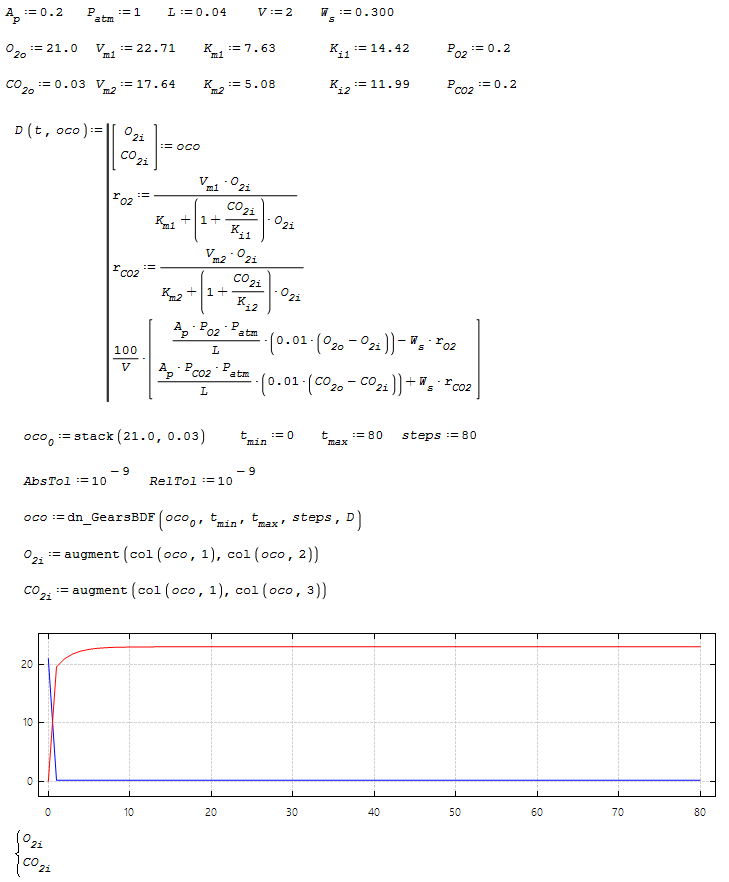

Hello everyone, I have started to use this program from just a couple of days and I have some problems with the model that I'm trying to implement.
So basically I have two ODE with into them some parameters that changing in time...Obviously, nothing work and I would like to have a little bit of help.
Ok, I'm not the best at explaining this, so I attach the file and I hope that someone can give me some good advice to make this thing work!
Prova modello permeabilita.sm (128,28 КиБ) скачан 1210 раз(а).

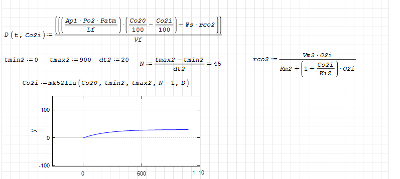

Ok, seems that I was able to do some progress here but, obviously, there is something that I think doesn't work
In your opinion this way the value of rco2 change with the new value of Co2i or it remains the initial value that I have set?
Prova modello permeabilita.sm (129,47 КиБ) скачан 1124 раз(а).

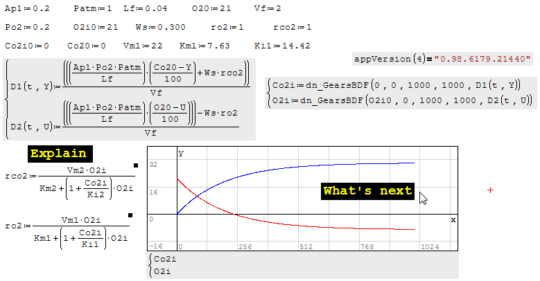

#8 Опубликовано: 23.11.2020 12:18:13
#9 Опубликовано: 23.11.2020 12:26:42

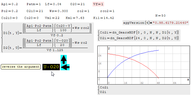

#10 Опубликовано: 23.11.2020 12:45:47
#11 Опубликовано: 23.11.2020 12:49:50

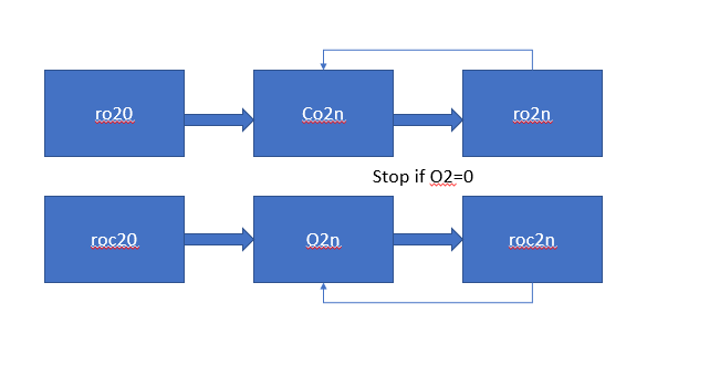

Sorry, for sure is for my bad english, I'm missing the meaning.
What I want to obtain is the evolution of the atmospheric concentration and respiration in the packaging.
So something like
That is more or less what uni has done
Veniamo da molto lontano e andiamo molto lontano! Palmiro Togliatti

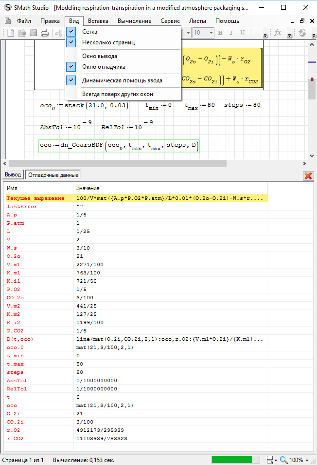

You can set breakpoint on line in D(t,oco) and you will see how values changed.
#16 Опубликовано: 24.11.2020 07:24:14

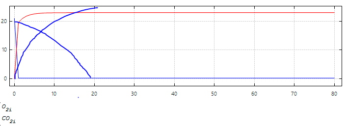

In general, there is something that doesn't work properly, because the chart describes the depleting and the increment almost linear until the O2 don't reach 0. After that point the CO2 increment start to being described in a "realistic way
I mean, I'm expecting to see something like that (the thick blue lines)

#19 Опубликовано: 24.11.2020 11:06:59
Like this ??? ... freak parameters at will .
#20 Опубликовано: 24.11.2020 11:36:51
... up to You the expert !
Prova modello permeabilita.sm (129,71 КиБ) скачан 1213 раз(а).
