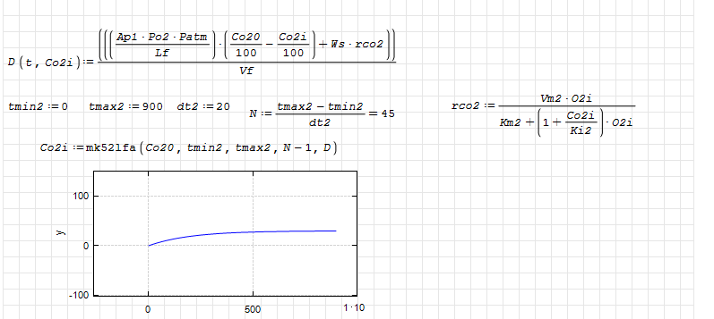

#7 Posted: 11/23/2020 10:34:56 AM
francesco88
francesco88
1 likes in 34 posts.

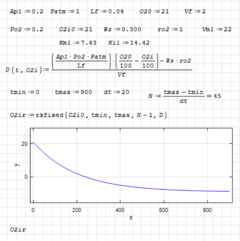

Ok, seems that I was able to do some progress here but, obviously, there is something that I think doesn't work
In your opinion this way the value of rco2 change with the new value of Co2i or it remains the initial value that I have set?
Prova modello permeabilita.sm (129.47 KiB) downloaded 1124 time(s).
Veniamo da molto lontano e andiamo molto lontano! Palmiro Togliatti

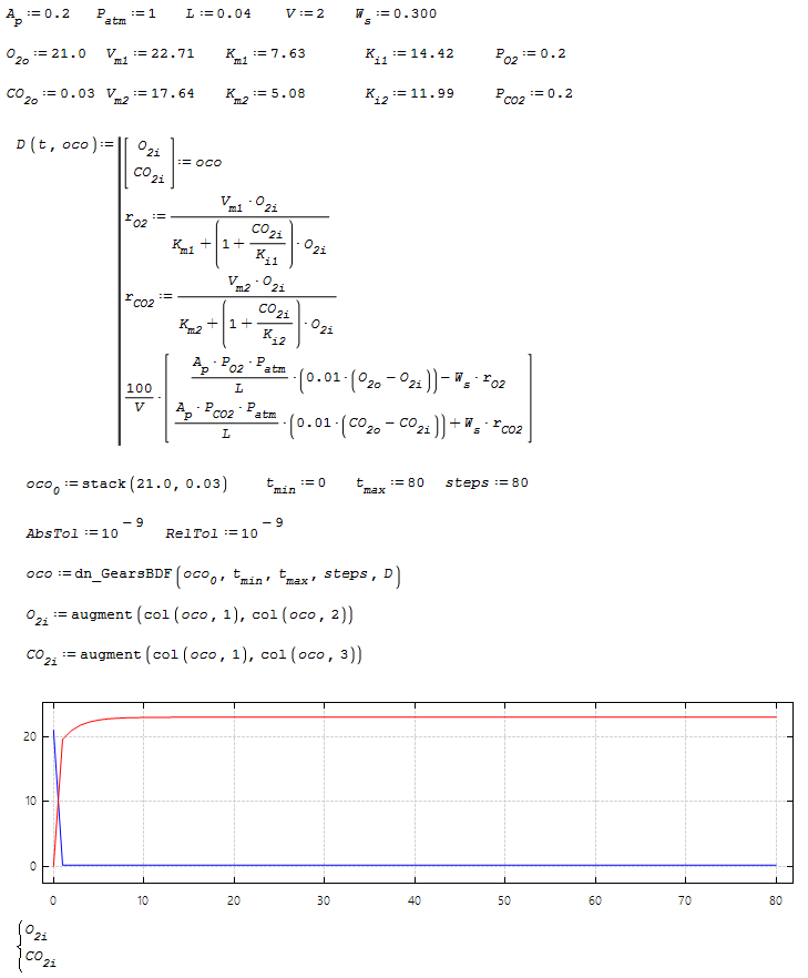

#8 Posted: 11/23/2020 12:18:13 PM
#9 Posted: 11/23/2020 12:26:42 PM
francesco88
francesco88
Really thank you for this correction, seems great!
g Ok, definitely I have to study hard and better how to use smath and repay the community.
#10 Posted: 11/23/2020 12:45:47 PM
1,558 likes in 1,868 posts.
#11 Posted: 11/23/2020 12:49:50 PM

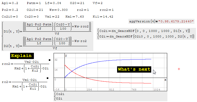

#12 Posted: 11/23/2020 3:31:15 PM
Now I work a little on this thing and we will see what progress I'm able to do.
AbsTol, RelTol is very specific w/o project application(s)
The attached is suggestive of exploring more.
ODE GearsBDF Undocumented.sm (18.75 KiB) downloaded 1149 time(s).

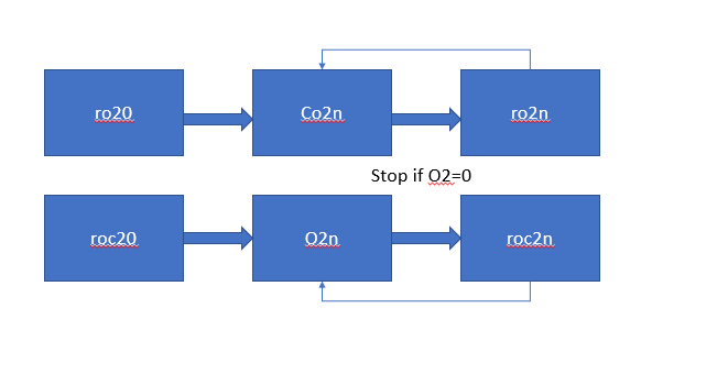

#13 Posted: 11/23/2020 9:12:46 PM
francesco88
francesco88
From the web visit, if 9 out of 10 same link are "404",
the originator is negligent, not to say "not trustable"
Paying $ to Elswier ... my ass !
No need for all that jargon, just give what you want to control,
I will close a control loop to optimum degree of accuracy !
Sorry, for sure is for my bad english, I'm missing the meaning.
What I want to obtain is the evolution of the atmospheric concentration and respiration in the packaging.
So something like
That is more or less what uni has done

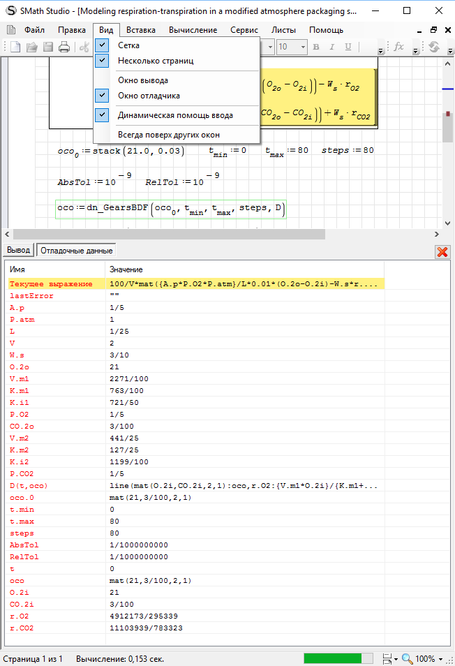

#15 Posted: 11/23/2020 11:55:07 PM
You can set breakpoint on line in D(t,oco) and you will see how values changed.
#16 Posted: 11/24/2020 7:24:14 AM

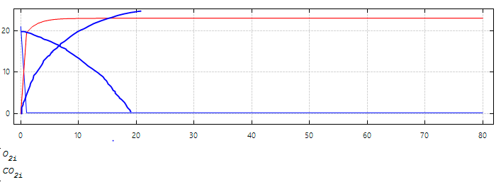

In general, there is something that doesn't work properly, because the chart describes the depleting and the increment almost linear until the O2 don't reach 0. After that point the CO2 increment start to being described in a "realistic way
I mean, I'm expecting to see something like that (the thick blue lines)

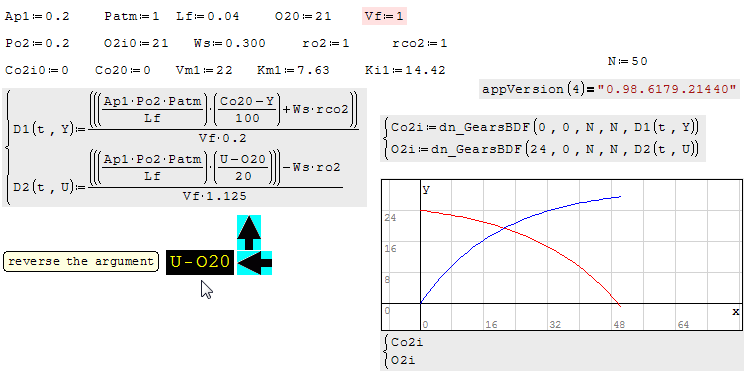

#19 Posted: 11/24/2020 11:06:59 AM
Like this ??? ... freak parameters at will .
#20 Posted: 11/24/2020 11:36:51 AM
... up to You the expert !
Prova modello permeabilita.sm (129.71 KiB) downloaded 1213 time(s).
