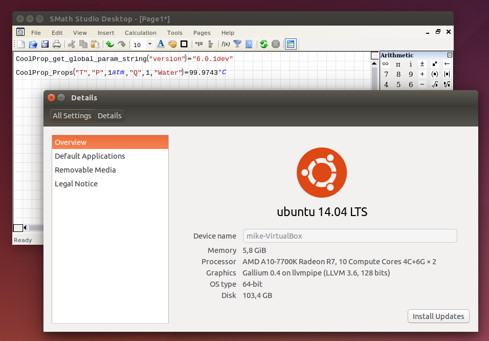

Mike Kaganski
Mike Kaganski
184 likes in 434 posts.
@Davide,
Is it worth it to turn the plugin to newer interface, I mean Entry instead of Term[]? Which oldest SMath will be supported then?
С уважением, Михаил Каганский

Mike Kaganski
Mike Kaganski
@Davide,
is there a documentation available (aside the source code itself)?
Thank you for your help.
#15 Posted: 2016/6/6 12:49:55
1,443 likes in 2,935 posts.
I've asked Andrey to publish the updated core documentation, I guess we have to wait the next Stable build...
If you want to try by examples: https://smath.info/svn/public/plugins/NonlinearSolvers/NIGHTLY BUILD/; in Tools you may found the most simpler examples (Taylor is an easy example of conversion in the input/output nodes using Terms; Unknowns makes use of Entry to do the job, Terms are used to build the output)
#16 Posted: 2016/6/8 10:05:09
Mike Kaganski
Mike Kaganski
Making it run on mono under Ubuntu:
Hope it will be available in next version of plugin.

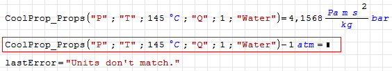

Mike Kaganski
Mike Kaganski
Thanks, Davide!
Here's what I see:
Also, no dynamic assistance is available. Though disabling the plugin doesn't help.
#19 Posted: 2016/10/25 22:21:34
Though I don't use Smath unit system, two questions come to evidence:
1. 'Q' does not not belong to WASP [WaterSteamProperties].
2. '1' is what ? ... maybe '1' is atm in the 2nd line ?
If "Units don't match": how could the dynamic assistance help ?
The coulomb (unit symbol: C) is the International System of Units (SI) unit of electric charge.
It is the charge (symbol: Q or q) transported by a constant current of one ampere in one second:
1 C = 1 A * 1 s
1 ((Pa * m * s^2) / kg) * bar = 100 000 pascals
#20 Posted: 2016/10/26 04:27:20
Hello Mike,
Reproduced, thank you. I'll fix it ASAP
This is really strange, I have the dynamic assistant both in install and portable versions and using different localizations (languages/symbols) o_o
Hello Jean, according with CoolProp documentation "Q" stands for "Mass vapor quality", thus 1 is 1 mol/mol
I guess it is a separate bug
