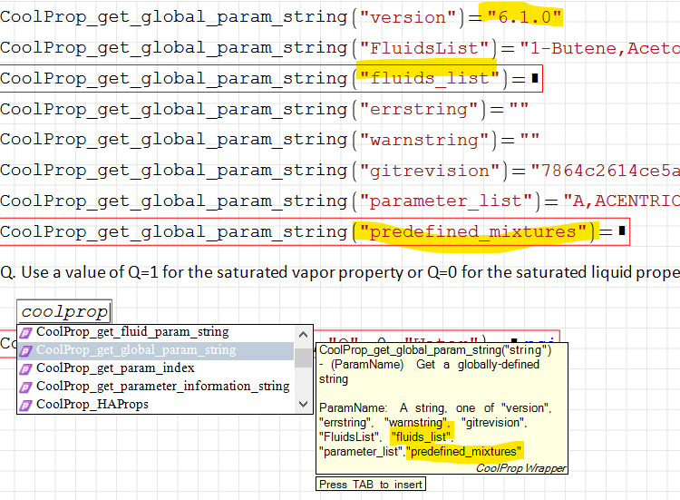

I just started playing with this tool, so please be patient with my ignorance.
Updated to what? The version on my system is 6.1.0; however, the CoolProp website is on 6.4.1
I've also noticed that some of the description paramater names fail.
In addition, off of other threads, there appears to be "commands" that are no longer valid. An example would be FProp here.. Please advise.
I'm still searching for information as to what the other functions do (e.g. CoolProp_get_param_index)

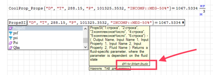

I am now getting the following error when using the CoolProp incompressible fluids library call
Initialize failed for backend: "?", fluid: "INCOMP::MEG-50%" fractions "[1.0000000 ]"; error: key [INCOMP::MEG-50%] was not found in string_to_index_map in JSONFluidLibrary : PropsSI("D","T",288.15,"P",101325.3532,"INCOMP::MEG-50%" )
This call was working March of this year. Any suggestions on what may be causing this issue?

PropsSI() function is from another plugin (mcadefi + mathcad coolprop lib).
Andrey Ivashov 2021/6/25 16:27:00
