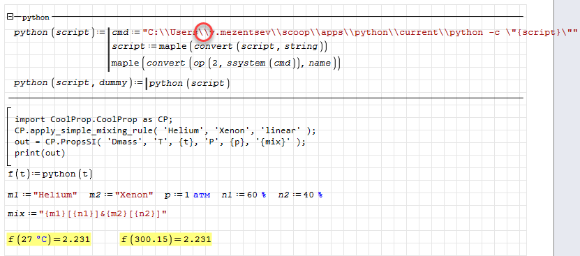

Without "pyfile" (inline multiline script). The script should be without comments.
Space padding is necessary here so that inside the script, when a large string is divided into parts, the line break character itself is not divided ( '\n' -> '\ n' ).
Click to enlarge Click to enlarge Click to enlarge
maple-python-coolprop-3.7.sm (9.9 KiB) downloaded 1676 time(s).
maple-python-coolprop-3.8.sm (6.84 KiB) downloaded 1677 time(s).

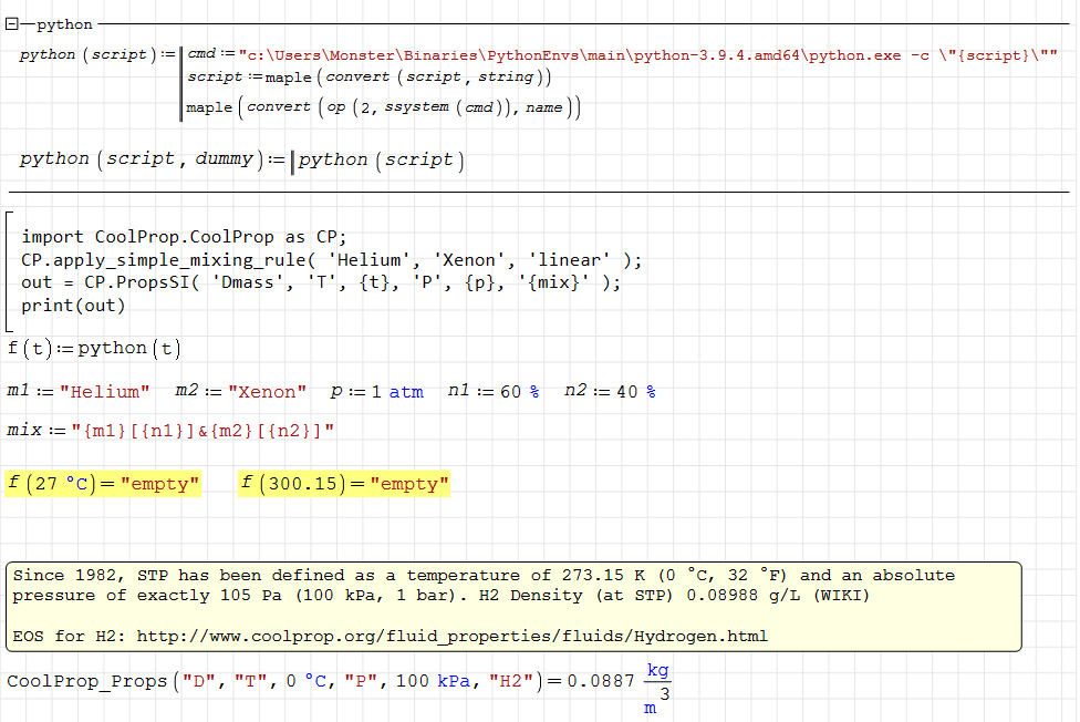

Uni, can you please help me how to add python into SMATH, I have python already in system [WinPython 3.9] How I link it up with Smath?
I have working CoolProp
#70 Posted: 2023/7/30 13:33:42
usamakhan
usamakhan
3 likes in 79 posts.
Jean, can you help me how do integrate python in my Smath? I event tried environmental variables under Win10 but didn't work

You should use a double slash for the full path.
In this case, you need to check whether python is available from the command line. If not, it means that the paths are specified incorrectly.

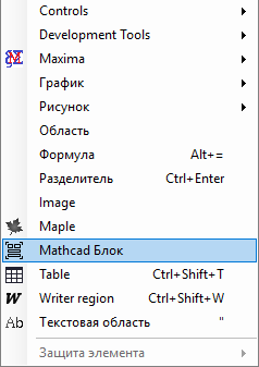

Can you tell me what is this block you used after python sub-section [i.e with the square bracket & holding script conetnts]
Additionally Razonar sample here is also very intuitive while calculating mixing values
https://en.smath.com/forum/yaf_postsm82120_Understanding-Redlich-Kwong-equation-of-state.aspx#post82120
#73 Posted: 2023/8/3 03:06:16
1,554 likes in 1,864 posts.
uni, thanks a lot
Mathcad Block from the Mathcad Toolbox plugin and just Text inside it for the script.

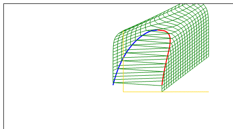

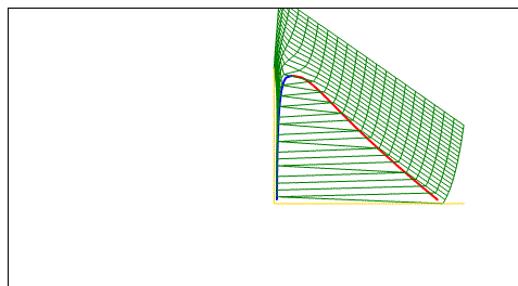

Phase diagrams with CoolProps.
Click to enlarge
PhaseDiagram.sm (39.17 KiB) downloaded 1664 time(s).
Davide Carpi 2023/8/8 02:10:00

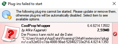

#78 Posted: 2024/4/16 03:55:20
1,355 likes in 2,271 posts.
It seems that multiple instances of SMath can't use the plugin at the same time.
How to reproduce:
1. Open SMath and access any Coolprop function
2. Open another SMath instance: You get an error message

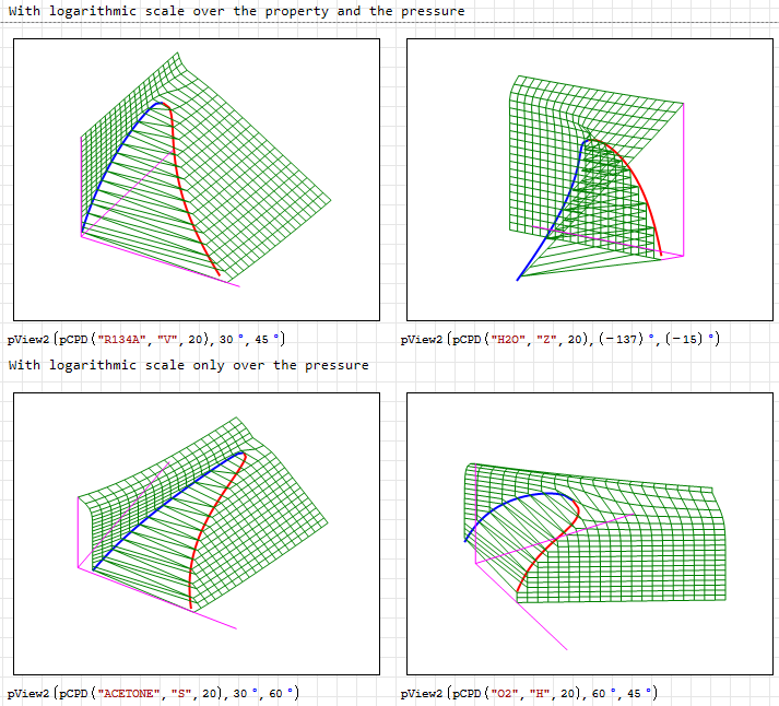

Phase diagrams with CoolProps. ...
Now can show other thermo properties, and get animations.
PhaseDiagram.sm (46.88 KiB) downloaded 652 time(s).
Animating volume of water and enthalpy of O2.
