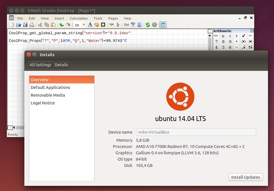

Making it run on mono under Ubuntu:
Hope it will be available in next version of plugin.
С уважением, Михаил Каганский

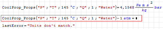

Here's what I see:
Also, no dynamic assistance is available. Though disabling the plugin doesn't help.

Though I don't use Smath unit system, two questions come to evidence:
1. 'Q' does not not belong to WASP [WaterSteamProperties].
2. '1' is what ? ... maybe '1' is atm in the 2nd line ?
If "Units don't match": how could the dynamic assistance help ?
The coulomb (unit symbol: C) is the International System of Units (SI) unit of electric charge.
It is the charge (symbol: Q or q) transported by a constant current of one ampere in one second:
1 C = 1 A * 1 s
1 ((Pa * m * s^2) / kg) * bar = 100 000 pascals
#20 Опубликовано: 26.10.2016 04:27:20
Hello Mike,
Reproduced, thank you. I'll fix it ASAP
This is really strange, I have the dynamic assistant both in install and portable versions and using different localizations (languages/symbols) o_o
Hello Jean, according with CoolProp documentation "Q" stands for "Mass vapor quality", thus 1 is 1 mol/mol
I guess it is a separate bug
