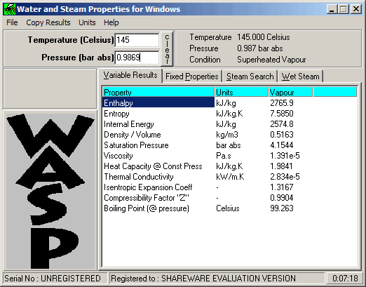

The user also asked for speed of sound and isentropic exponent functions. Is there a way to help him?
#27 Posted: 2017/1/8 12:41:22
"WASP" is freeware for 10 minutes use, unlimited sessions.
"WASP" from "Katmar". all properties are tabulated per T(°C) or P(abs).

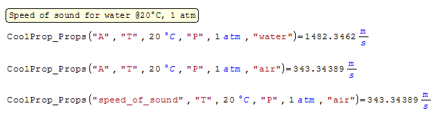

#28 Posted: 2017/1/8 15:58:05
1,435 likes in 2,913 posts.
As for the speed of sound can be accessed using "A" or "speed_of_sound"
For the isentropic functions I googled "isentropic coolprop" and there is something but it is not my field, maybe Mike can give some hints.

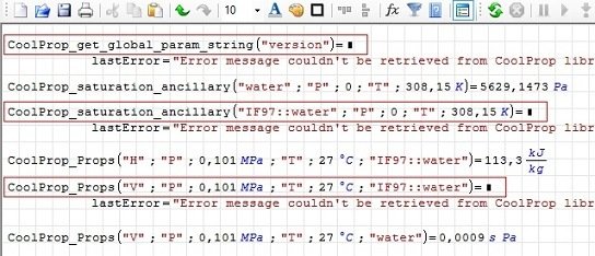

#34 Posted: 2017/12/22 21:39:02
Aleksey
Aleksey
1 likes in 2 posts.
CoolProp_get_global_param_string("version"
lastError="Error message couldn't be retrieved from CoolProp library (buffer size issue?); the second try returned: "
what's the problem?
#35 Posted: 2017/12/23 05:47:39
which versions of SMath and CoolProp plugin are you using?
#36 Posted: 2017/12/25 02:27:58

#37 Posted: 2017/12/25 23:59:35
Aleksey
Aleksey
1 likes in 2 posts.
Error:
version SMath - 0.98(build 6484)
version CoolProp -
I'm try on the various Windows platforms (32/64):
good result on
Win10x64Pro, Win7x64Ultim
don't working on
Win10x86Pro, Win10x86Educ, Win7x86Pro
Best regards,
Aleksey
Davide Carpi 2017/12/27 12:43:00

#39 Posted: 2017/12/27 12:47:24
don't working on
Thank you, reproduced. Something goes wrong with the wrapped 32 bit library (the coolprop dll returns both the correct result as well as an error code, hence the errors shown).
