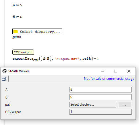

can I use this plugin (csv export) in viewer/exe file? so user can get output from exe file
#185 Posted: 2021/12/29 20:16:47
1,443 likes in 2,935 posts.
Hello [userlink]Susilo Widyatmoko[/userlink],
Yes, you can. If you want to let the user choose a path, there is the path picker region, otherwise you might choose a default output, f.e. if you choose an empty string as third argument ("") the file will be created next to the executable.
