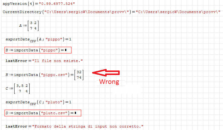

#168 Posted: 2019/2/8 08:07:57
116 likes in 332 posts.
Davide, I detected problems importing simple data files in CSV format (decimal separator "." Element Separator ",")
Doc1.sm (6.75 KiB) downloaded 852 time(s).

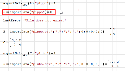

#169 Posted: 2019/2/8 15:35:42
1,435 likes in 2,913 posts.
importData is built-in and can import both numeric and symbolic data; the single argument import works as expected only if the column separator is a whitespace or a tabulation, otherwise you have to use the 9-arguments version.
#170 Posted: 2019/2/8 15:46:01
However, ExportData. CSV saves the file in this format (as shown in the example attached above)
#171 Posted: 2019/2/8 17:02:28
it seems to me that exportData.CSV does his job (it makes a data file composed by comma separated values, the default content of CSV files), isn't designed to be the inverse of importData(1)... what it might considered odd is how the numbers are converted by importData(1); maybe it might be improved, however even in excel if you don't set the right parameters you might experience wrong imported content (a common drawback of generic format readers).

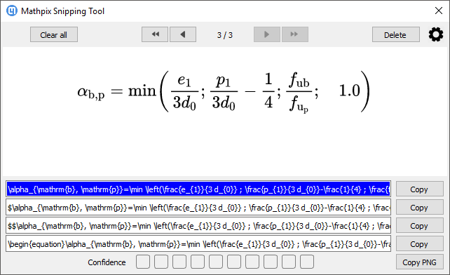

#172 Posted: 2019/3/24 10:42:59
Jogi
Jogi
0 likes in 3 posts.
Hi!
First of all I wanna say that I am really impressed about this software and the community. I just found out about SMath yesterday and really like the opportunity for extensions which seems to make it a lot better then the software I used previously, MathCad.
What I am looking for is a way to transform formulas and expressions from a pdf to an editable SMath sheet. This would allow to skip the very time consuming step of retyping the forumlas. Unfortunately I have only found posts that deal with the workflow in the other direction: exporting from SMath to pdf (e.g. created with Latex).
An example formula looks like this:
The way I thought this could work is with the following workflow:
1. Converting a pdf screenshot of a forumla with an OCR software to a latex formula code. This step seems to work quite well with the Mathpix snipping tool. The mathpix snipping tool is able to convert to several latex formula formats.
2. Convert the latex formula code to Smath. This is the point where I am struggling. I thought about scripting a little tool in Python that could do the conversion. As I have only really basic programming skills I was wondering whether you have heard of any script that is already available? As the described data exchange plugin seems to be able to convert from Smath to latex, do you think there is also a way to convert in the other way?
Probably there is also a completely different and more effective way to do that. I am really excited about this and looking forward to your replies

#176 Posted: 2019/3/25 08:35:30
You might start looking at how the conversion from another language to SMath is made in MapleTools and MaximaPlugin.
