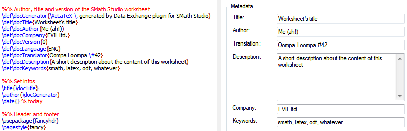

I have problems with the export XeLaTeX.
First it is highlighted exception
Proceeding is inhibited the choice of options
Proceeding is nevertheless produced a tex file
You must still add the following line in the markup to fill in XeLaTeX
\newcommand{\defeq}{\coloneq} % SMath 'define equal' symbol
PS some addition function is not implemented, however, the qualitative result of the prints obtained is much higher than that of normal export pdf. I would hate a little if this project was abandoned

I see, seems something related to multithreading vs Forms. I have to ask Andrey, but I think that I have to remove the dialog from the save flow.
The project is not abandoned, but you know, there are a lot of plugins and I have to find a little bit of time for each one. I'll implement the missing functions ASAP.

- TEX files: all worksheet's metadata are now stored in the \doc***** variables;

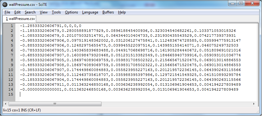

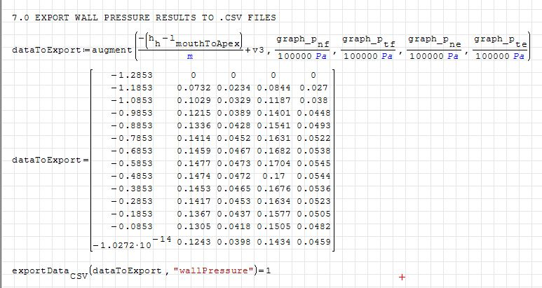

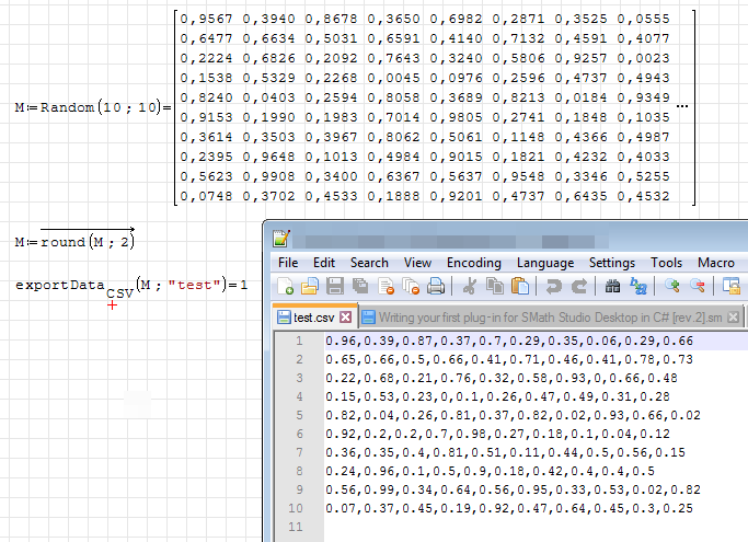

Hello there,
Is there a method for using round() with exportDataCSV?
Perhaps I need to loop through the multi dimensional array and operate on each entry using round(), ahead of using exportDataCSV.
Please point me in the right direction for a robust method.

You can use a loop or vectorize() over the round function

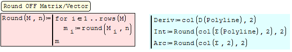

#158 Posted: 2017/10/17 10:01:06
Utilities Matrix roundup_n.sm (24.9 KiB) downloaded 1352 time(s).
#159 Posted: 2017/10/17 16:40:48
In the last Hermite polyline, it does not understand
vectorising roun(col,n) over specific col ... done otherwise.
