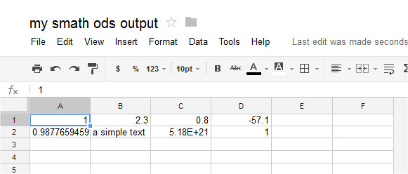

I've fixed the issues (all related to unassigned path/filename variables, wrong paths and error handling).
EDIT: plugin updated again with ODS better handling of text variables.
any ODF file it's a zip archive (with a custom extension *.od*) that contain many files (xml,png,...). As first approach I've create an empty ods file from LibreOffice, I've unzipped the ods and I've used the sources as template. Updating the template using a OpenOffice file seem that the output could be opened both from MS excel and Google Docs [Gdocs -> create -> spreadsheet -> file -> open -> upload]
The spreadsheetlight plugin it's not compatible (.NET Framework version required is .NET Framework 3.5 instead of 2.0)

ODS fixed (I hope)
You're right, you can use any existing path where you have permissions to read and write files (BTW inserting or not a backslash at the end of the filepath doesn't cause issues).
I know, we can't paste nothing (text with/without spaces or numbers) inside a text variable (a variable enclosed by "" ); your workaround is certainly not trivial but solves me many issues
best regards,
w3b5urf3r

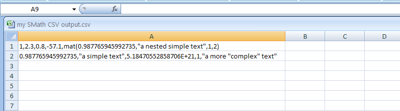

Test on xp:
-the sample does not report errors but now it outputs csv and ods at the same directory as the smath sheet.
-the ods file can't be opened with excel_2007_SP1 but it seems that is required at least 2007_SP2
-the output files does not correspond to the matrix on the sample, see screenshots.

Test on xp:
Hi kilele, thank you for your examination
The outputDirectory value it's customizable, in the new DataExport.sm the first definition only it's enabled (output sent in the sheet folder).
I consider the 2nd issue a SP1 lack (otherwise the SP2 did not contain any changes about ODF); consider that you can open the ODS with a LibreOffice/OpenOffice for free (even with a portable app) and resave the file as a *.xls or a *.xlsx file.
Consider that a csv file works fine when you share numbers and text; the example contains also nested matrices for testing purposes but I would not recommend to share SMath symbolical data using a CSV file. Besides to load correctly a CSV in MS office you need to import it (On the Data tab, in the Get External Data group, click on "From text" > choose the file to load, set delimiters and others options...); LibreOffice start the import procedure when you open the file, so there are not issues... EDIT obviously I can extend the CSV export features to export symbolical data as a string.

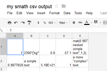

#14 Posted: 2012/12/17 21:24:26
1,443 likes in 2,935 posts.
Ah, yes...
I've forgot to fix a couple of issues in the ODS/CSV exporting with units of measurement (now processed as symbolic data) and nested quotes; the issue revealed itself by opening the exported files with google docs, now seem that work fine...
fixed & updated REMEMBER TO DELETE ANY OLD PLUGIN ('DataExport.dll' or 'CSV export.dll', if any)
As for the MS Office 2007 SP1 import of ODS files, my idea still remain to convert the file with a third party application (LibreOffice/OpenOffice/webservice); alternatively, here there is a free ODF Add-in for Microsoft Office or the official "2007 Microsoft Office Suite Service Pack 3 (SP3)" (or we can hope for a future evolution of the xls plugin...)
best regards,
w3b5urf3r
