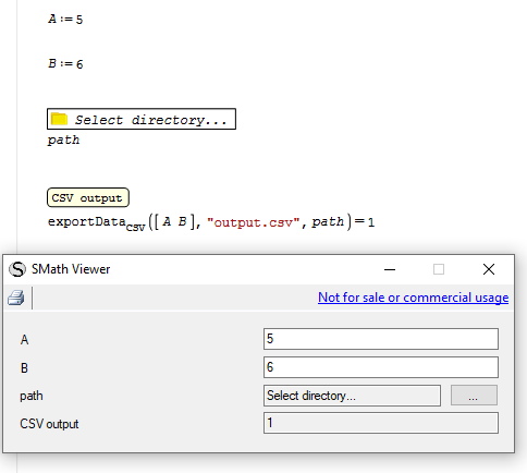

can I use this plugin (csv export) in viewer/exe file? so user can get output from exe file
#185 Posted: 12/29/2021 8:16:47 PM
1,442 likes in 2,933 posts.
Hello [userlink]Susilo Widyatmoko[/userlink],
Yes, you can. If you want to let the user choose a path, there is the path picker region, otherwise you might choose a default output, f.e. if you choose an empty string as third argument ("") the file will be created next to the executable.
