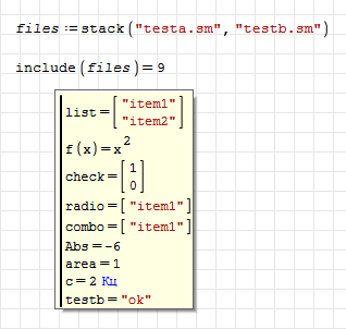

#141 Posted: 2022/1/4 23:12:37
1,532 likes in 1,838 posts.
SMath Studio compatibility
Plugin updated ( ).
Changes:
- restored the possibility of nested call of the include() function;
- added support for list of files.
It is now possible to implement the Reference component.

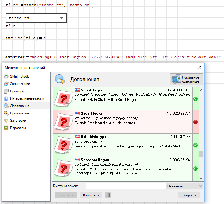

#142 Posted: 2022/1/7 18:15:06
Plugin updated.
Changes:
- added support for: numericupdown, pathpicker, mathcad block, script;
- lastError shows missing plugins for the last included file (function compares the dependencies of the include file with the current set of enabled plugins).

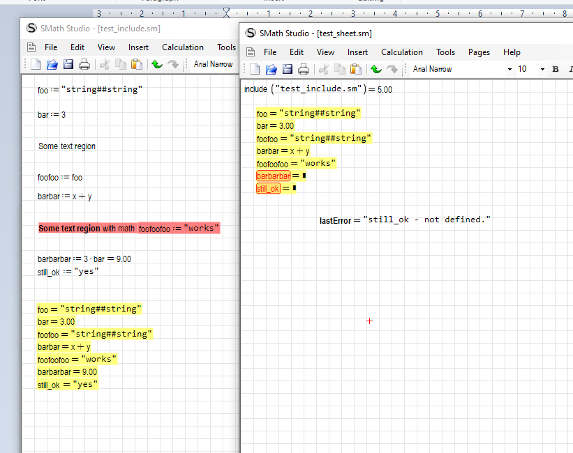

#143 Posted: 2022/2/18 06:31:25
Chito
Chito
1 likes in 6 posts.
Hi uni,
Thanks for the new updates. I found a bug. If I have a text region that has a formula, formulas after it will not be included.
test_sheet.sm (4.39 KiB) downloaded 895 time(s).
test_include.sm (6.79 KiB) downloaded 953 time(s).
This was the last version where I knew that it worked:
Plugin updated. Please try.
Changes:
- added encoding of special characters in the text.
#144 Posted: 2022/2/19 15:02:12
Plugin updated. For now I don't know how to parse math equations inside text region correctly.
Changes:
- text region partially supported.
