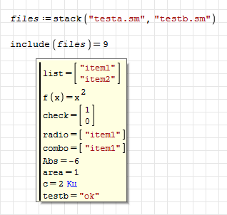

- restored the possibility of nested call of the include() function;
- added support for list of files.
It is now possible to implement the Reference component.

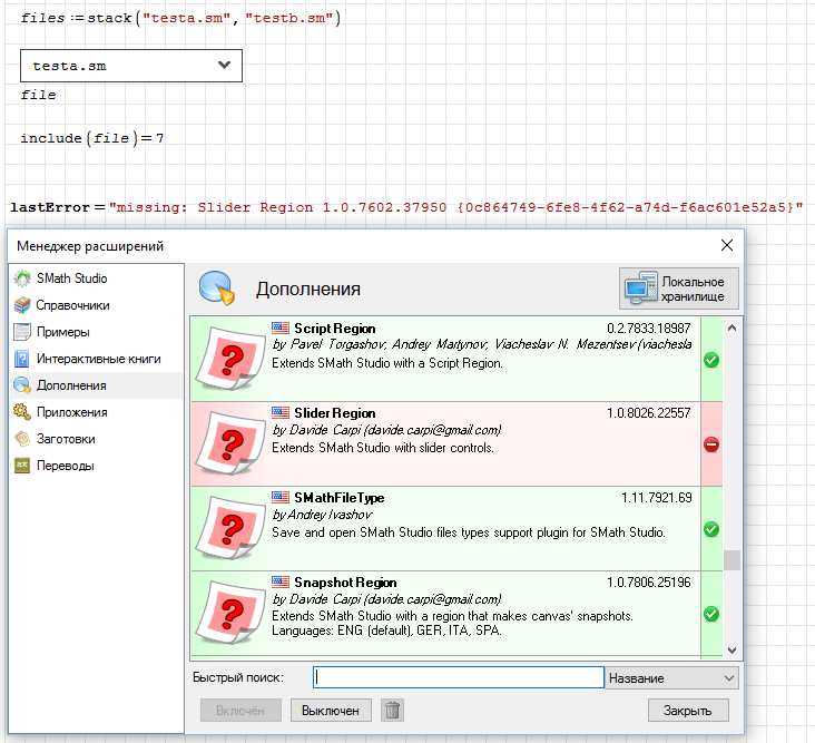

- added support for: numericupdown, pathpicker, mathcad block, script;
- lastError shows missing plugins for the last included file (function compares the dependencies of the include file with the current set of enabled plugins).

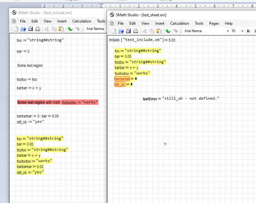

Hi uni,
Thanks for the new updates. I found a bug. If I have a text region that has a formula, formulas after it will not be included.
test_sheet.sm (4,39 КиБ) скачан 1644 раз(а).
test_include.sm (6,79 КиБ) скачан 1694 раз(а).

#144 Опубликовано: 19.02.2022 15:02:12
SMath Studio compatibility
Plugin updated. For now I don't know how to parse math equations inside text region correctly.
Changes:
- text region partially supported.
