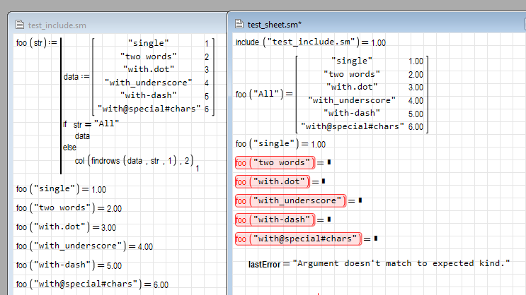

#137 Posted: 2021/12/10 06:03:37
Chito
Chito
1 likes in 6 posts.
Hi. Thanks for this plugin. I found it very useful in creating a single custom functions file for my team.
I'm encountering errors when I have strings with spaces or any other special characters as arguments. If I call the function within the included file there's no error. Does anyone have an idea on what's causing this?
Thanks.
test_sheet.sm (5.08 KiB) downloaded 1337 time(s).
test_include.sm (5.18 KiB) downloaded 1327 time(s).
#138 Posted: 2021/12/10 06:22:01
1,554 likes in 1,864 posts.
SMath Studio compatibility
Plugin updated. Please try.
Changes:
- added encoding of special characters in the text.
sergio 2021/12/10 08:53:00
#139 Posted: 2021/12/10 06:37:16
Chito
Chito
1 likes in 6 posts.
The update solves the problem. Thank you very much uni.
#140 Posted: 2022/1/4 19:46:14
