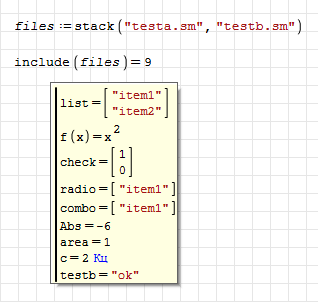

Plugin updated ( ).
Changes:
- restored the possibility of nested call of the include() function;
- added support for list of files.
It is now possible to implement the Reference component.

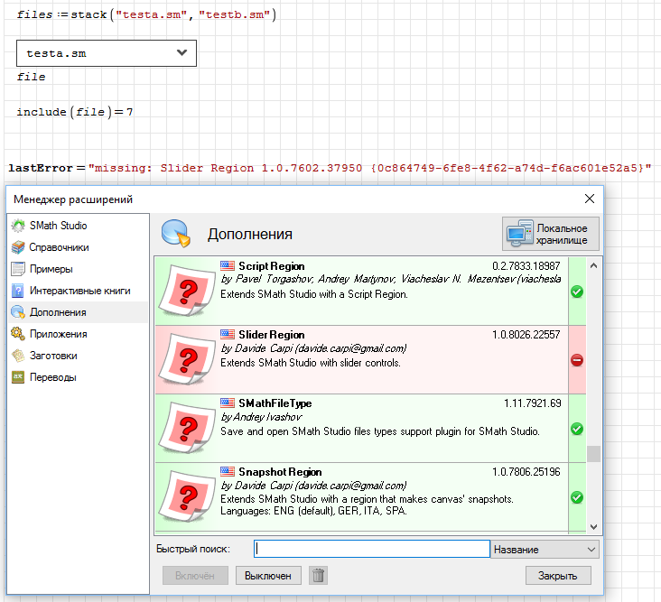

Plugin updated.
Changes:
- added support for: numericupdown, pathpicker, mathcad block, script;
- lastError shows missing plugins for the last included file (function compares the dependencies of the include file with the current set of enabled plugins).

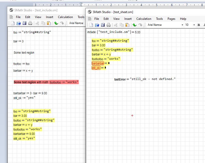

Hi uni,
Thanks for the new updates. I found a bug. If I have a text region that has a formula, formulas after it will not be included.
test_sheet.sm (4.39 KiB) downloaded 1644 time(s).
test_include.sm (6.79 KiB) downloaded 1694 time(s).
This was the last version where I knew that it worked:
SMath Studio compatibility
Plugin updated. Please try.
Changes:
- added encoding of special characters in the text.
Вячеслав Мезенцев 2/19/2022 3:03:00 PM

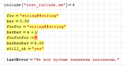

#144 Posted: 2/19/2022 3:02:12 PM
1,558 likes in 1,868 posts.
Plugin updated. For now I don't know how to parse math equations inside text region correctly.
Changes:
- text region partially supported.
Chito 2/19/2022 7:31:00 PM
