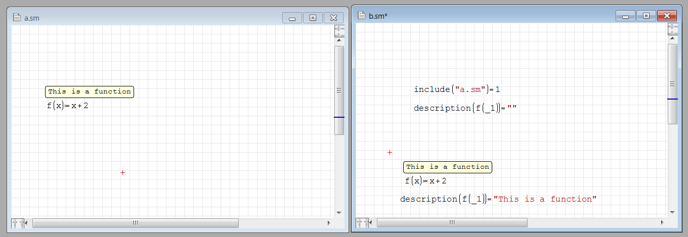

Is it possible for descriptions to be passed with include()?
See example
Mike Kaganski 2016/4/14 23:47:00
#93 Posted: 2016/4/15 02:07:43
1,554 likes in 1,864 posts.
No, now this is impossible. Function (AddDefinition() from SMath core lib ) which does the main job dosn't know about the description field for the definition. So I can't add this data.

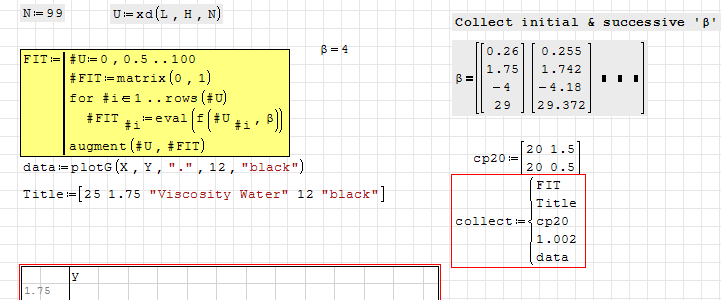

"include" has been discussed ad noseum. "Combox box" crashes Smath 5346.
Include" does not work either. What is "combobox " for ?
Let test you pretention outside of "combobox": download both work sheets.
The work sheet "Genfit Algo Include" is the progrmmed algorithm that
I would like to be live in the work sheet "Genfit Algo Include Test".
There is nothing to do, just wait until you get a plot [~ 1 second].
The error message says "file not found" ... "include" does not fetche
the algorithm computation from the referenced file, even if the referenced
algo is open in a separate Smath instance.
It would be useful to me, simplifying the data modeling.

Using Jean's files in the same directory, I updated to Mike's sheet and compared it to UNI's pdf ... I still have an error in the re-definition of BETA. Using latest SMath and plugins. BETA.PNG

Jean,
I have the equal sign. It's in Mikes updated sheet. The Beta in the screen shot I took shows 4; whereas Uni's PDF shows a 4x1 matrix (array)
#100 Posted: 2016/4/15 17:45:23
Jean,
I have the equal sign.It's in Mikes updated sheet.The Beta in the screen shot I took shows 4; whereas Uni's PDF shows a 4x1 matrix (array)
You may have to put both work sheets in your Smath working directory.
If you read 4, instead of 1: it does not find the work sheet in question.
If it does not work: the problem is specific to your instalation.
After the wife and the kids, consider re-installing Smath.
