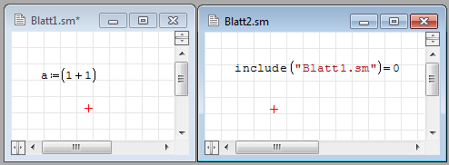

I am finally able to create a minimal example that reproduces the bug, see attachment. Include() seems not to work with brackets.
#51 Posted: 2014/10/28 07:10:24
1,554 likes in 1,864 posts.
Updated. Bug fixed. Brackets now supported.

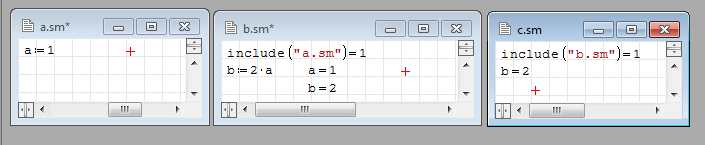

I would like to use cascading dependencies. See the attached example. In file c.sm I cannot access all the variables I have in b.sm. Nevertheless I have the influence of a.sm in c.sm through the variable b. This is strange to me. Is it a wanted behavior? Why?
Of course I could include a.sm in c.sm again. But I could also include another file d.sm in c.sm which contains a:=2. I would then end up with a=2 and b=2 despite b being defined as 2*a...
I think there are two ways of implementing this properly:
  1. You can acess all the variables like a class. I.e c:=include( "a.sm" ) ... c.a=1
  2. Or the variables are universally accessible in all files directly, resulting in a=1 in c.sm
#54 Posted: 2014/10/30 06:46:53
There is a log file in the folder with the plugin (it appears if the function doesn't work.). The function can't find the file in the specified path. As for the rest - it's strange behavior. I'll see what's wrong.
#55 Posted: 2014/10/30 13:01:46
Updated. Fixed bug with cascading dependencies.
