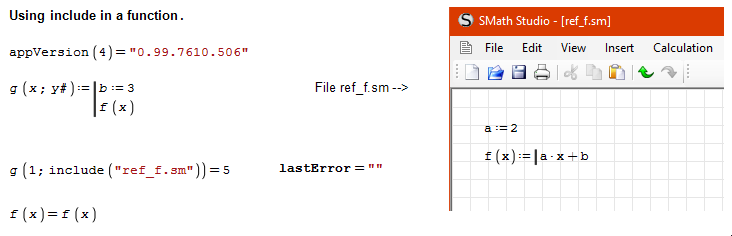

Hi. First, thanks for your work. I think that include it's one of most important tools in SMath for write advanced functions, like ode solvers, in native SMath code, instead of use C# plugins.
It's possible using include in a function body? Please, see the attached. In case that it could be, can also be values in include only local for the caller function, and not to the entire worksheet?

#128 Posted: 11/18/2020 6:09:21 AM
127 likes in 342 posts.
using "include" as a function parameter can work around the problem!?
Alvaro 11/18/2020 1:36:00 PM
#129 Posted: 11/18/2020 1:35:22 PM
1,139 likes in 1,805 posts.
Hi Pompelmo. Absolutely. That' exact what I want. Thanks very much.

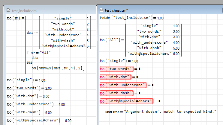

Hi. Thanks for this plugin. I found it very useful in creating a single custom functions file for my team.
I'm encountering errors when I have strings with spaces or any other special characters as arguments. If I call the function within the included file there's no error. Does anyone have an idea on what's causing this?
Thanks.

#138 Posted: 12/10/2021 6:22:01 AM
1,558 likes in 1,868 posts.
SMath Studio compatibility
Plugin updated. Please try.
Changes:
- added encoding of special characters in the text.
sergio 12/10/2021 8:53:00 AM
#139 Posted: 12/10/2021 6:37:16 AM
Chito
Chito
1 likes in 6 posts.
The update solves the problem. Thank you very much uni.
