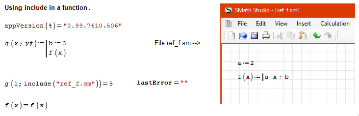

Hi. First, thanks for your work. I think that include it's one of most important tools in SMath for write advanced functions, like ode solvers, in native SMath code, instead of use C# plugins.
It's possible using include in a function body? Please, see the attached. In case that it could be, can also be values in include only local for the caller function, and not to the entire worksheet?

#128 Опубликовано: 18.11.2020 06:09:21
using "include" as a function parameter can work around the problem!?
Alvaro 18.11.2020 13:36:00
#129 Опубликовано: 18.11.2020 13:35:22
Hi Pompelmo. Absolutely. That' exact what I want. Thanks very much.

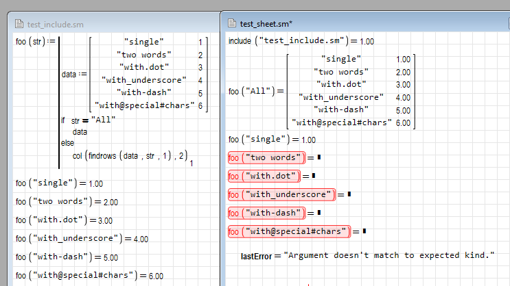

Hi. Thanks for this plugin. I found it very useful in creating a single custom functions file for my team.
I'm encountering errors when I have strings with spaces or any other special characters as arguments. If I call the function within the included file there's no error. Does anyone have an idea on what's causing this?
Thanks.

#138 Опубликовано: 10.12.2021 06:22:01
SMath Studio compatibility
Plugin updated. Please try.
Changes:
- added encoding of special characters in the text.

#139 Опубликовано: 10.12.2021 06:37:16
Chito
Chito
1 сообщений из 6 понравились пользователям.
The update solves the problem. Thank you very much uni.
