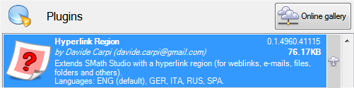

First Beta available through plugin's Gallery.
Documentation and translation sheet in the first post.

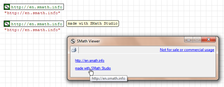

- Support for SMath Viewer
best regards,
Davide

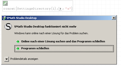

SMath crashes when I try to edit the input expression of a hyperlink.
I write concat with three arguments, fill in the first and the last. As soon as I want to type to the second placeholder, the crash occures.
#16 Posted: 2013/8/9 19:07:15
1,443 likes in 2,935 posts.
Fixed, please test the update
