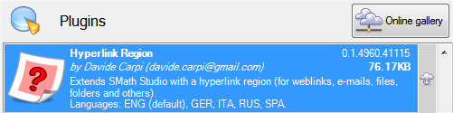

#4 Posted: 7/31/2013 6:06:14 PM
1,443 likes in 2,936 posts.
First Beta available through plugin's Gallery.
Documentation and translation sheet in the first post.

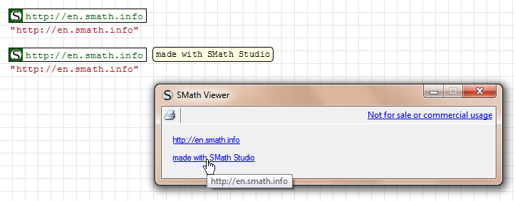

#12 Posted: 8/2/2013 5:51:25 PM
UPDATED
- Support for SMath Viewer

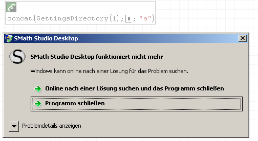

1,361 likes in 2,275 posts.
SMath crashes when I try to edit the input expression of a hyperlink.
I write concat with three arguments, fill in the first and the last. As soon as I want to type to the second placeholder, the crash occures.
#16 Posted: 8/9/2013 7:07:15 PM
Fixed, please test the update
